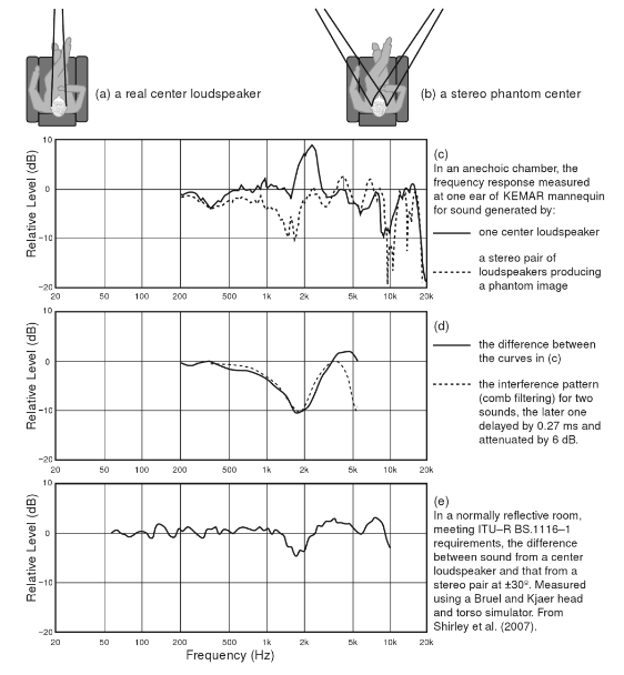

Consider this; no mixing or 'doctoring', a pure Blumlein pair of exceedingly high quality mics., making a recording of a pure natural sound, or instruments, and the replay being with flat speakers. The only consideration then will,be the room acoustics in each case.
(Alan Shaw, with Derek Hughes, did a recording in the BBC anechoic chamber just before it was demolished, and with the best mic. in the world, and posted it on his site. I have a burnt CD of it, it is clean, but it sounds a bit 'chesty'.)
Now what will be the argument for the dip?
One of the real giveaways with stereo, and this may have been a factor in the dip, is that sibilants from eg. a central image, suddenly come at us from both extremes, and shatter the illusion. (her teeth and lips are not t'ing and s'ing from 8ft apart.
