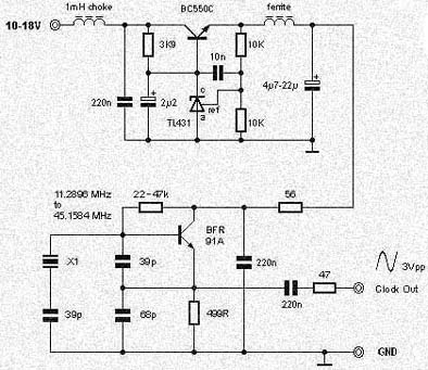

tubee said:
If the CDP has a simple cristal / schematic providing the clock, a better clock (Tent XO or Kwak 7) will improve sound, and sometimes a lot
Why spend money on clocks that are based on same crystal oscillator like that in your player.
You can simply remove crystal from player borad and bult RF amp for him and put him in series oscillatin ciruit. For that amp you can build a simple but efective power supply with choke filtration and shunt reg.
Have you one (or two) finished PCB for this "Super Clock"...?
I'd like to buy... 🙂
Gasho, a OPA2132 will outperform the good old NE5534. But indeed the NE5534 is not that bad considered its age!
Your proposed clock circuit is a combination of C. Snoerens PS for a Tent-XO (have a copy here) and a simplified KWAK-like clock generator circuit. In Kwak 7 the cristal is buffered with a fet, and a comparator delivers the clock signal. Advantage of Elso's way is that the output can be adjusted to get the best waveform.
A big & canned cristal can be a good one, or it is not. Its depending what is in it, usually a cristal and a 74HCT04 buffer. Better would be a cristal and a VCO.
