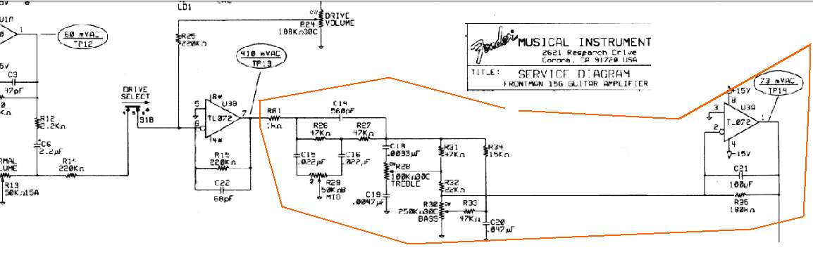

anyone ever seen a schematic for an active version of the 'FMV stack"?
i.e. with the stack in a feedback loop, to avoid the insertion loss
Yes. One of the late Fenders. Probably opamp.

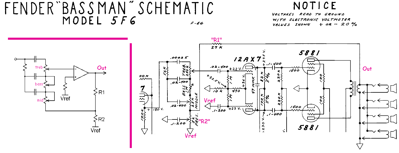

I was looking at the schematic on P224 of this book, and wondering if there was an actual implementation of it: https://www.jeanpierrepoulin.com/PDF/transistor.pdf

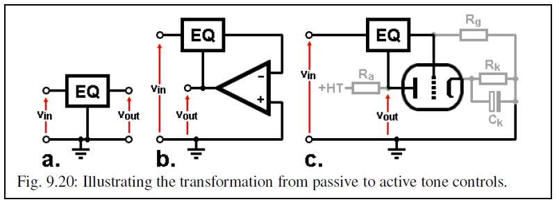

If you want to turn a passive stack into an active one you can try it yourself, see below. Note than an active stack doesn't eliminate insertion loss per se, really it adds gain after the stack to bring the signal back up again, the same as you can do with a passive stack. But the feedback approach does alter the I/O impedances and EQ curves, making them more symmetrical / resonant / wacky.

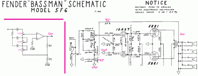

There is! Fender 5F6 (not "a"). Leo connected the bottom of the tonestack to the NFB loop around the last stage, just as Kyttälä shows.
https://el34world.com/charts/Schematics/files/Fender/Fender_bassman_5a6_schematic.pdf
Difference: the Fender output stage is low gain and at the "R2 R1" junction there is about no spare gain to enforce the tonestack action.
Also I am not sure the 5F6 is a "real" amp. I've never seen it mentioned. I suspect it was a drawing mistake. It may be that all real amps were wired the 5F6a way, and the "a" drawing simply corrects the "no-a" drawing to reflect the as-built amps.
If you flip a James stack and wrap it inside an opamp, you get gain of 10 with +/- tone action BUT the pot rotation is "backward". Dynaco used reverse-audio pots. QUAD used audio pots but recessed them wired backward to hide the reverse rotation. I'm not sure the Kyttälä/5F6 plan works that way.
Any simple high gain system is prone to end up with too little or too much gain, because simple gain comes in fairly fixed values. So interstage loss is an important design tool. Taking loss in a tone control is one of the easiest.
