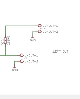

Another question regarding Eagle con-faston library. There are several 6,3mm x 0,8mm tabs in the library. Which one you use for GND, and Vcc and Vee supply connection? This is important to me when I make schematics in Eagle. I think that I can learn to use Eagle.

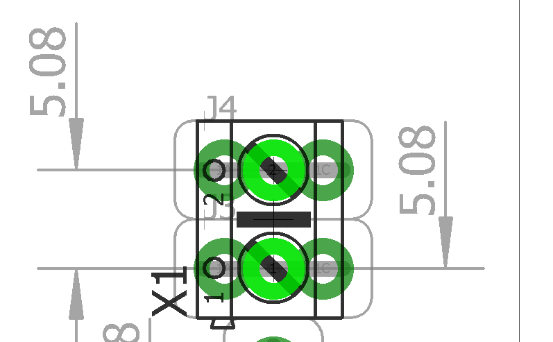

Hi Ivan,
Use the attached library , in that, use the package F061.120. It is made by me and i use it for every layout. if you arrange side by side , you will have pitch spacing between 2 fastons as 5.08mm. even if you arrange one above other, pitch will still be 5.08mm. so you can fit either a faston or terminal block in those adjacent holes.
reg
Prasi
edit. secod image shows fitment of a screw terminal in the faston holes

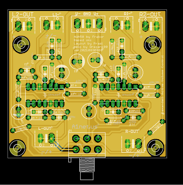

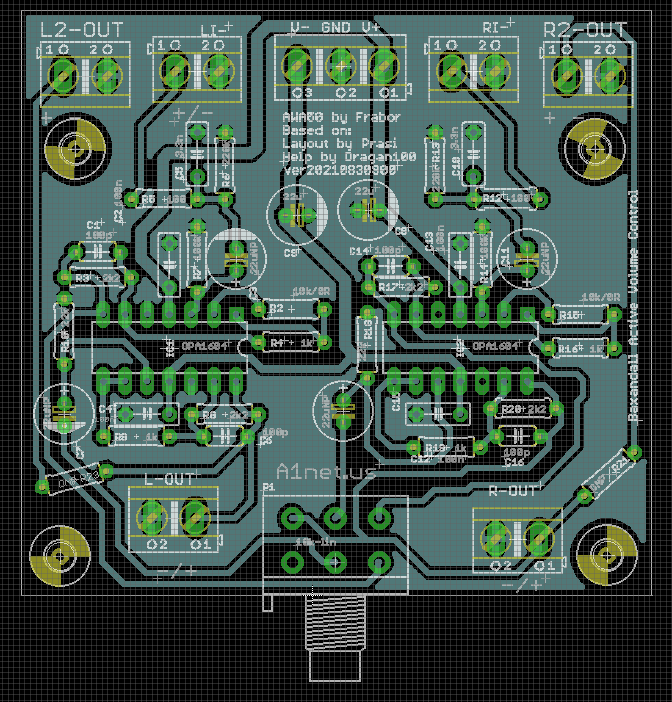

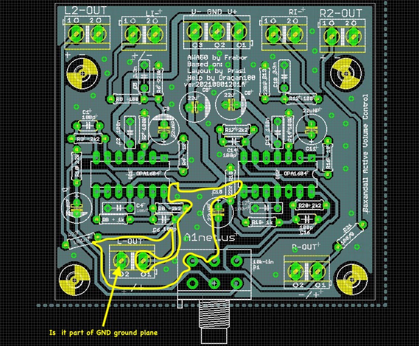

I imported and modified the layout of Prasi volume control board. the layout is very similar with four changes:
1) I remove the star ground and the bottom as ground plane. Most of the signals (other than one) are on the top layer
2) There is copper pour on both layers.
3) The supply caps are closer to the opamps
4) All connectors are on the back of the board. while keeping the original on the front
5) Remove the input diode and the test load resistors
6) Added an optional output resistor, as some application notes recommend a 100 Ohms on the output. It can also be shorted, or left open if the back connectors are not used.
I will publish all files after I get the board from manufacturing.

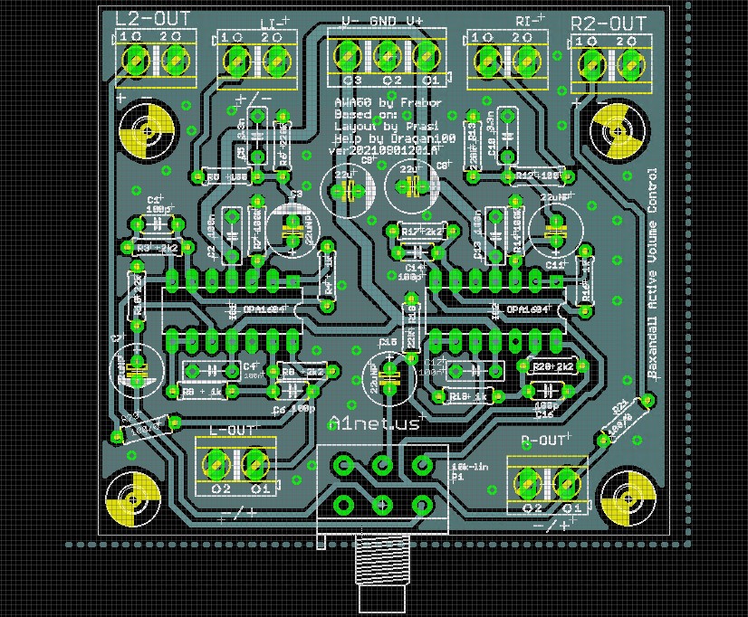

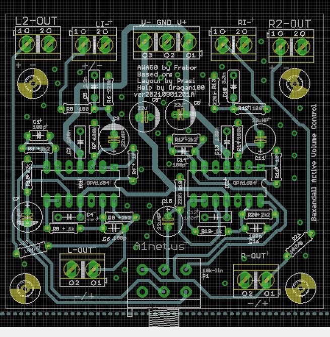

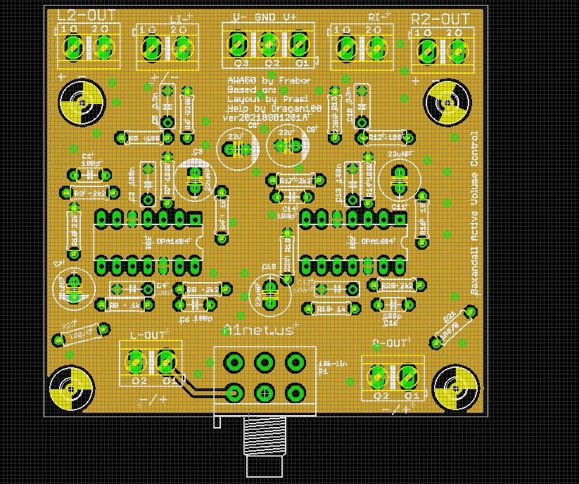

I am connecting the signal gnd to the ground plane in the other layer via a thermal. All the gnd signal connectors, both input and the two set of outputs, are connected to the ground plane. If there is a problem, please let me know.
francis.
I do not know if it is a problem for this design but i always had a hum issue with 2 layers ground plane. i use now only one layer signal ground plane in my designs with no more antenna issue, if i need one layer Signal Ground plane and one Power Ground plane, they are connected separately to the PSU Ground board. With this design if you have hums problems you have to redesign the board, with two separated ground layers, you can try to connect them together at your board if you want but if you have antenna issue you can always connect them separately or with 10R resistor.
