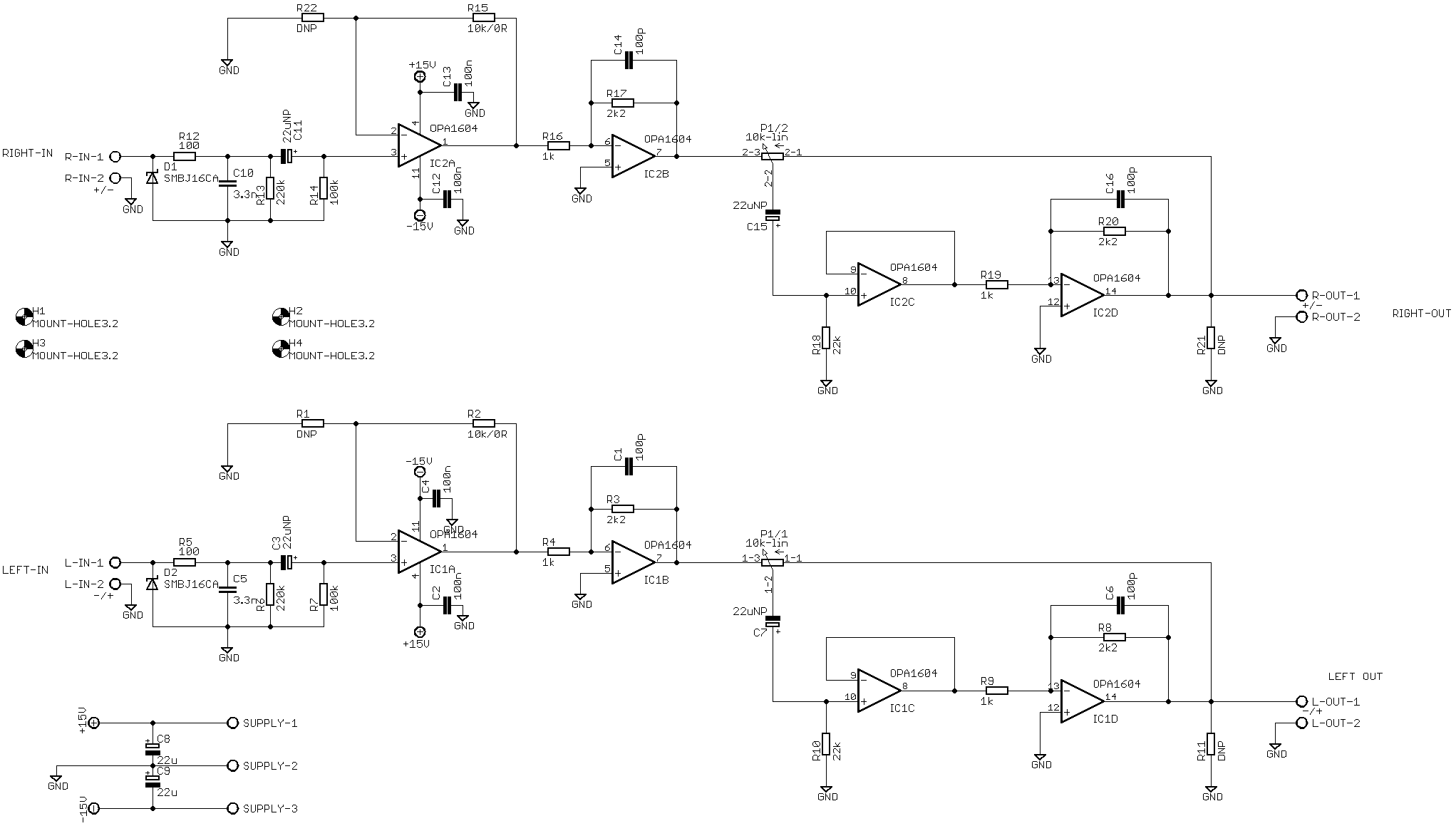

Baxandall gain control according TI tidu34 certified design
Sometimes designer tries to solve a purely technical problem but at the same time creates a circuit that also has desirable subjective qualities. One such circuit is active gain control by the late Peter Baxandall. Basic idea was to create log action from the linear pot. Even the best log pots have audible discontinuities. Baxandall’s circuit solves this issue providing a silky smooth log action from the linear pot.
The circuit I used is from Texas Instruments tidu34, designed by Ian Williams. There was a TI demo (mono) pcb which used SMD parts. I used stereo TH pcb designed by the forum member Prasi (with a little help from Dragan100). Hat down to Prasi for excellent two sided board.
Original circuit is just attenuator but the circuit I used has 6dBs gain obtained by adjusting R8 in the original schematic. For testing purposes I used cheap TL074 DIP14 opamps because high performance quad opams in DIP14 package are hard to find. I had some problems with obviously fake TL074 bought from Ali Express and marked TI. Another pair of TL074 made by ST gave perfect results. Since TL07x are not very load tolerant I used higher value resisitors than ones in the original schematic. But even with resisitors several times the value marked in the original schematics subjective results were excellent. If DIP14 quad opamps like NJM 2060 or TLE2074 are used one can benefit even more from the lower noise that original resistor values provide.
What I like about this circuit is excellent control of volume combined with great sound. Unlike most log pots Baxandall’s circuit is pleasure to use. It is possible to adjust volume very precisely. Sound of the circuit is seductively smooth yet at the same time detailed and dynamic. It’s pity that Baxandall’s active gain control is not used more in industrial HiFi products. It is my impression that inverting stage of Baxandall’s circuit is responsible for the fine subjective qualities. First CD that I tried with tidu034 circuit was Tomasz Stanko’s „Soul of Things“ (ECM Records). I was surprised how palpable piano sounded and how detailed the sound was at low listening levels.

At low volume settings circuit behaves like linear pot but as described in tidu034, it's beneficial for pot "offness". We want dead silence at zero setting, aren't we? If you want to use log part of track, don't give the circuit any gain, build it as described in tidu034.
Doug Self proved experimentally that with cheap linear RadioOhm pots, channel tracking in the log part is between 0,3dB and 0,6dB. That's excellent result. Expensive ALPS Blue Velvet log pot has tracking error of 2dBs.

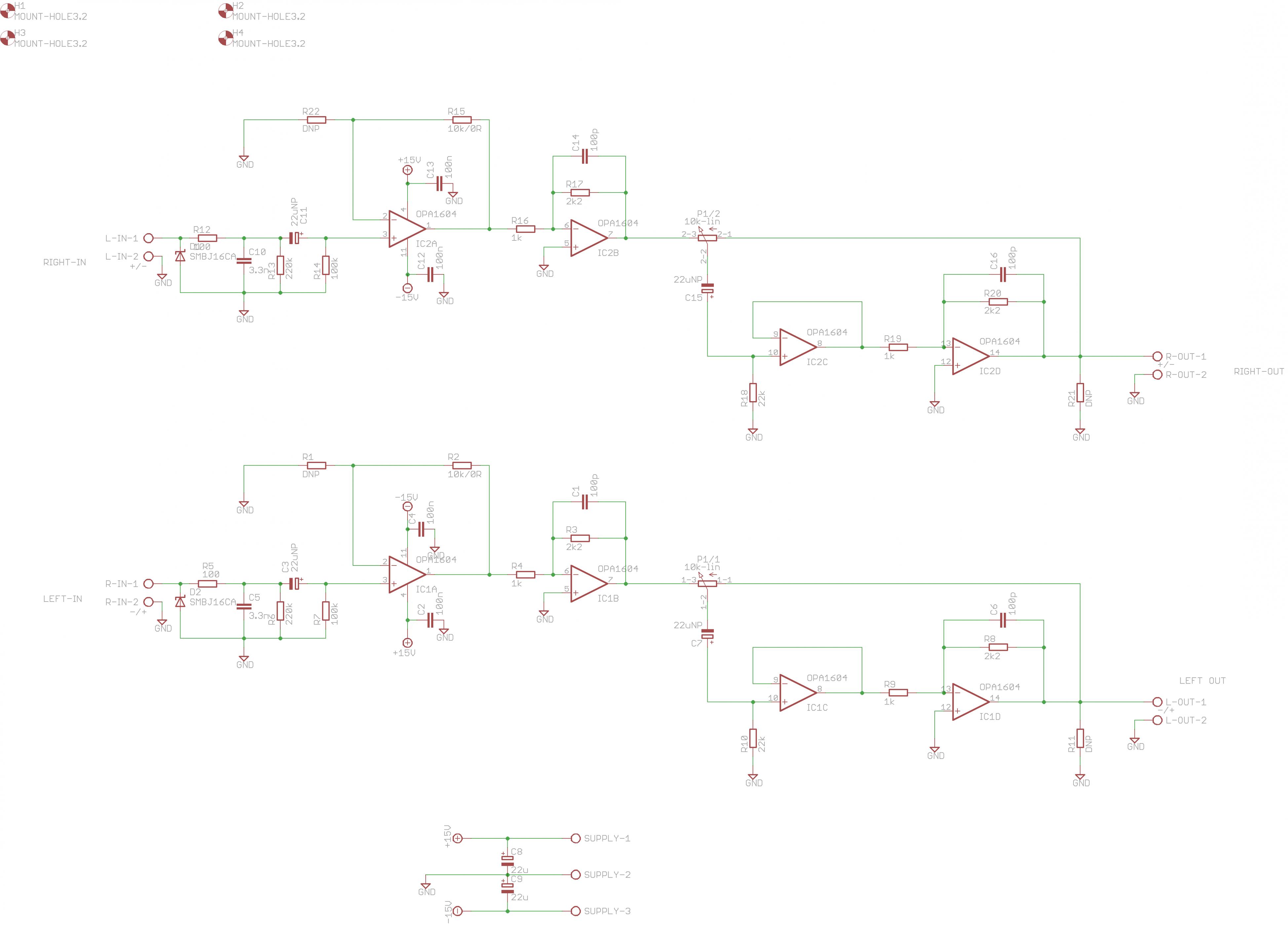

C15, C7 jumpered
C11, C3 10uF/16V tantal
Because I don't have 22uF small bipolar elcos. If you have small bipolars you should populate all these positions.
Instead of 1k resistors I used 4k7 (TL074 don't have good load tolerance) but if you have MC33079 you should use 1k as on the original schematic.
R20, R8 are 10k - I use 6dB gain (tidu034 recommends using higher values for R17 and R3 for the same reason)
All other components use tidu034 values. 100pF caps are ML COG ceramics. These caps are needed to achieve less than unity gain stability for the inverting stages.
100nF bypass caps are X7R ML ceramics.
