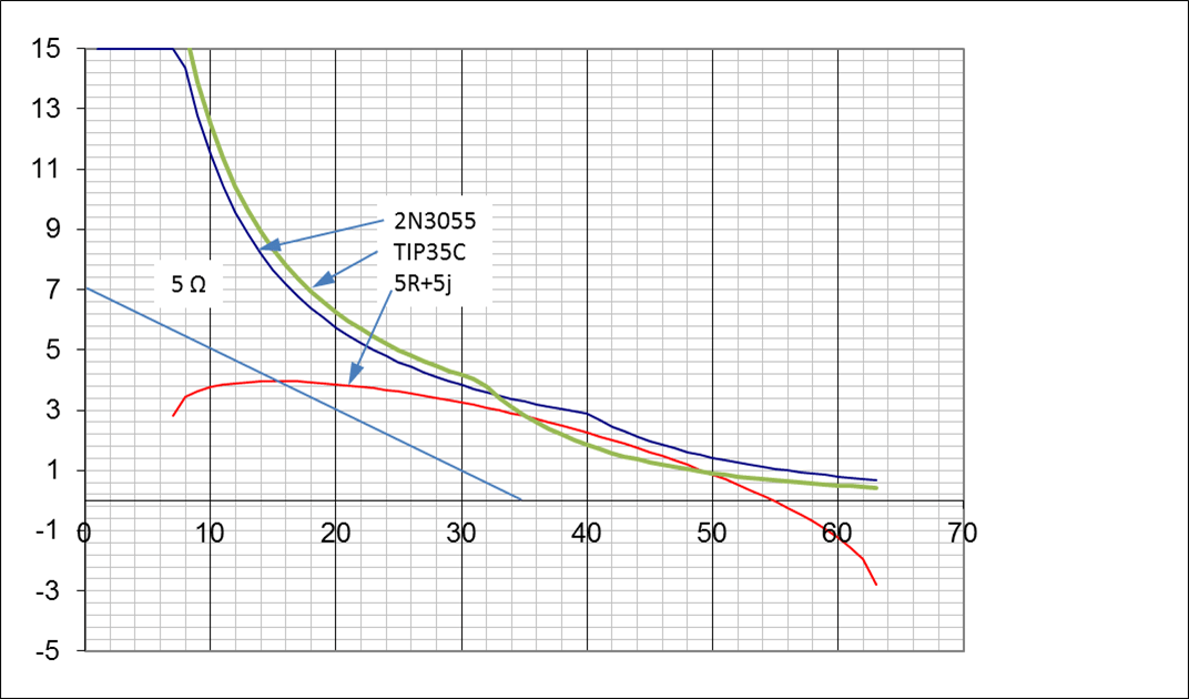

From the datasheets I have the SOA for the 3055 and TIP35C come close, but TIP35C loses out above its SOA break point.
A plot of the two graphs (these may not be 100% accurate as the data was taken from the datasheets: these are approximates) is shown with a 5 ohm+5j reactive load, assuming a 28V swing (50W into 8 ohms). What these reactive load graphs do not show is the frequency at which the elliptical load line applies, since the speaker's inductance will give a phase dependent on frequency. And, as the frequency increases an increasing impedance, so reducing current even if the phase shift is higher. The TIP35 datasheet suggests that a signal somewhere between 100Hz and 1kHz will be fast enough to use a slightly higher SOA rating. But again the normal SOA is claimed to be "single pulse" and as a signal traversing the ellipse will be likely to be repetitive the equivalent power for a cycle really needs to be considered.
In short, the TIP35 ought to manage 50W on +/-35V, but certainly as wg_ski says, no higher.
Reactions: NanoFarad
Rod also suggest not more than +/-35vDC (unloaded) for TIP35/36C but as you know P3A is capable of 90watts into 4ohm & 70watts into 8ohm. Never heard of any failure using these transistors in P3A, otherwise rod wouldn't recommend them because he run a business.
That seems fair enough. You would get the TIP35C driving 4 ohm loads better than a 3055. (I generally regarded the 3055 as a 6A transistor, neve really tried to push it higher. Even getting it to do 6A is a slight challenge. There are things like the 3771/3772 for that. Although the datasheet for those has not changed (200kHz???) I suspect the ft is higher these days. )
Just another point on the SOA graph - looking at the overlap of the elliptical (A.C.) load line against the TIP35 (D.C.) the length of time the SOA curve is exceeded is only 0.565 radians (out of 2pi) or just under 10% of the cycle. That would only be a 1ms pulse equivalent at 100Hz. When the SOA limit is higher, just over the load line in fact. So practically, TIP35 is OK I suspect for +/-35V. (Is that where the 35 came from😉)
