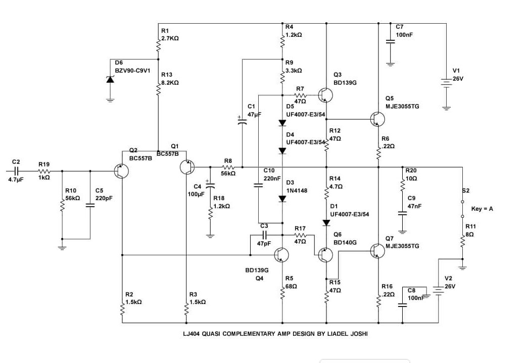

Baxandall diode in QC amp
Do we really need baxandall diode there? Some people strongly recommends it for better HF linearity but the designer says D1 isn't necessary & i can use this amp without it (but i'm still confused because he used that diode in the original design but now telling me not to use it).

As drawn in post #7, you need four diode drops for the output transistors to turn on, as you need to bias Q3, Q5, Q6 and D1.
Actually yes correct.
4 diodes needed with baxandall drop.
So was my concern, and forgot design using 4 diodes
if baxandall is removed, bias jumps.

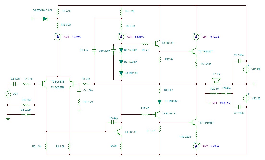

DC analysis
Current sources Reasonable Values,
Likely Current increase for AM3 or second gain stage T4 would like higher 8 or 10mA
instead of 5.5mA
And Correct is Low bias Class B
AM1 , AM2 for the most part are off.
If you look at output VF1, DC offset is high around 89 mV
So the overall positive offset is making T5 slightly on @ 3mA
If you did AC analysis most the current would be on AM1.
I think few simple value changes would get DC offset on output down to more normal 10 mV or lower.
Class B is fine but T7 not on at all.
Think would be good to balance amplifier and get both outputs slightly on around 3 to 6mA
As mentioned with Quasi important to balance DC otherwise
either T5 or T7 would take most the AC load
this case T5 take most the load with offset positive.

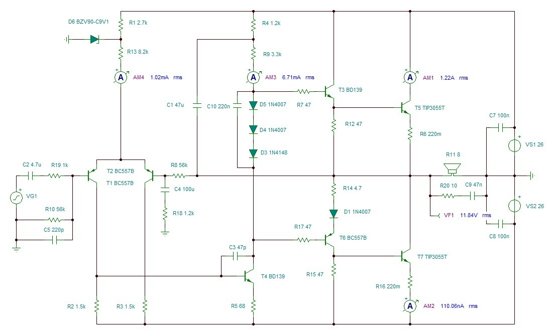

I test the amp with around 11 volt output or around 16 to 17 watts
you can see in AC analysis most current goes to T5
of course over time would change with temp, all Semi shown at 22 C

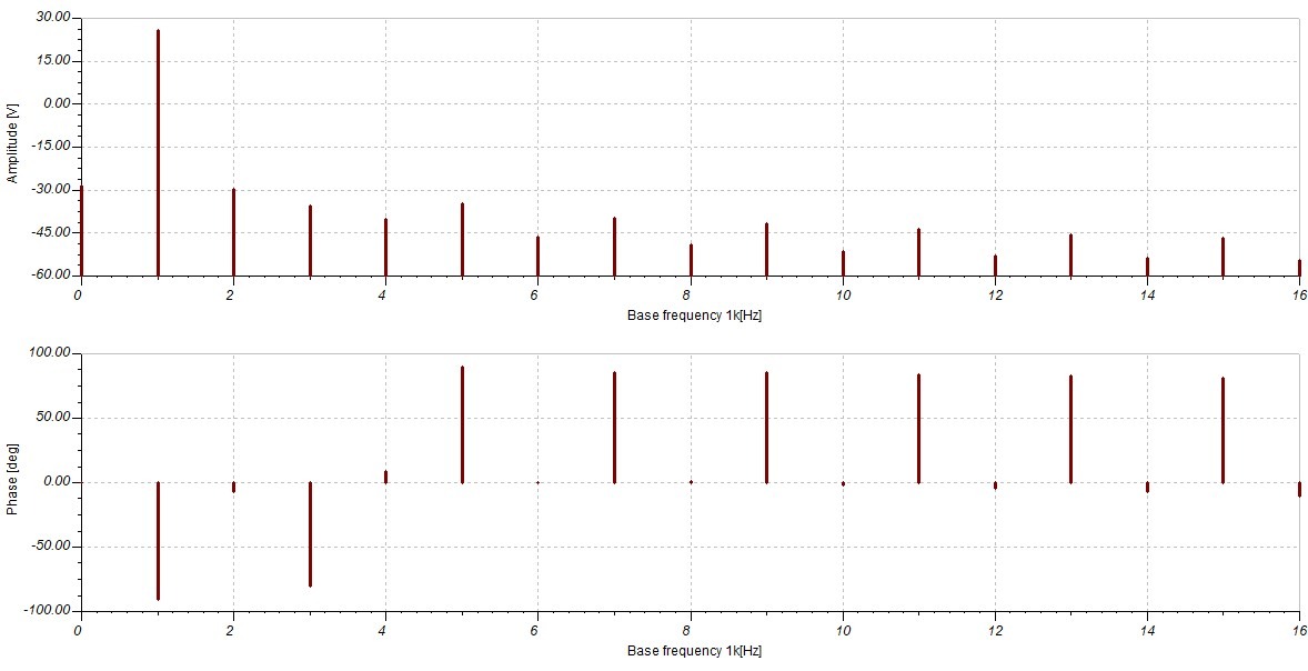

AC analysis
interesting with bootstrap R4 / R9 you see current rise a little with
more signal from 5.5 to 6.7 mA

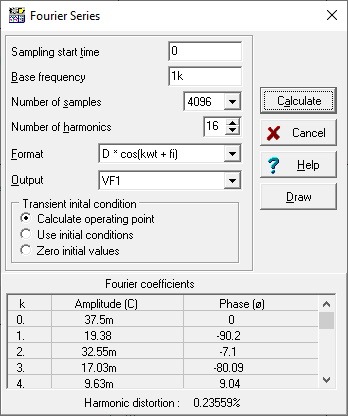

THD1 or 1K 17 watts to 8 ohm .2%
Maybe improve if diff current raised to 2mA
and second stage to 8mA
Can click image for larger Harmonic profile.
It does have pretty strong second harmonic
and out of phase. Upper harmonics in phase.
likely the Class B make highend possible scratchy
Most Second Harmonic likely not very Linear BD139
and bootstrap. I have done this on purpose with
MI amps. To make amp more 2nd Harmonic
Simple amps can be Fun.

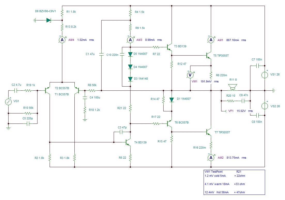

I got DC offset down from 89mV to 1mV
R1,R2,R3,R4,R5,R9 Values changed
Added R21 which raises bias and could be a pot or values shown in chart
AC current now more balanced
R14 changed to more traditional Baxandall diode and value changed
40 to 50 watts you would add more output devices.
likely 2 pairs. Single pair of 3055T is borderline.
Assuming that is smaller 220 devices
or use 247 or 267 package
or TIP35C
C1 could be 100u
AC analysis
As you can see both T5, T7 equal current

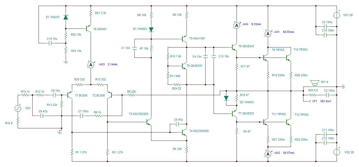

Excellent, thank you very much. Can i use 100R pot for R21? For output transistors i have to-247 package so i guess one pair will be enough for +/-25vDC rails.
I would also like to try your version (post 17), have all required transistors for that.
