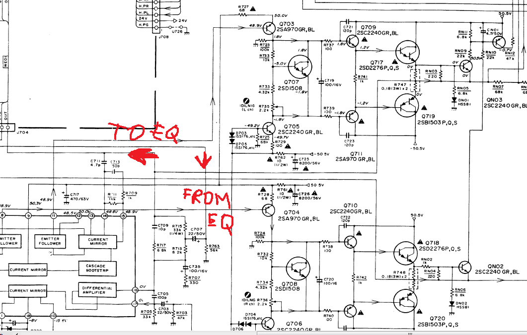

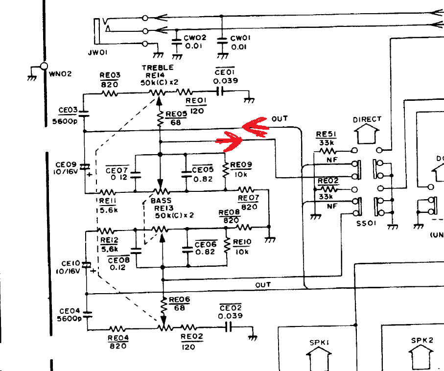

Harman kardon 645, Marantz PM62, Kenwood KA-1000 and that's just the amplifiers that i owned and i know ...A gain of 40 dB in linear position of both potentiometers with just one opamp? Barely believable.
Best regards!
Well, the Harman Kardon doesn't feature an active Baxandall tone stack. Look at the pots' both sides: There are components of different values, aren't they?

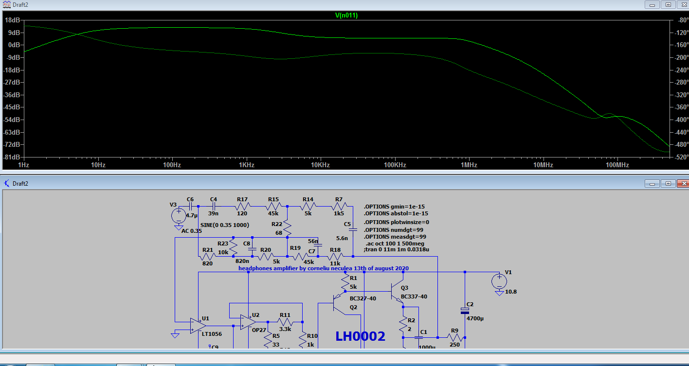

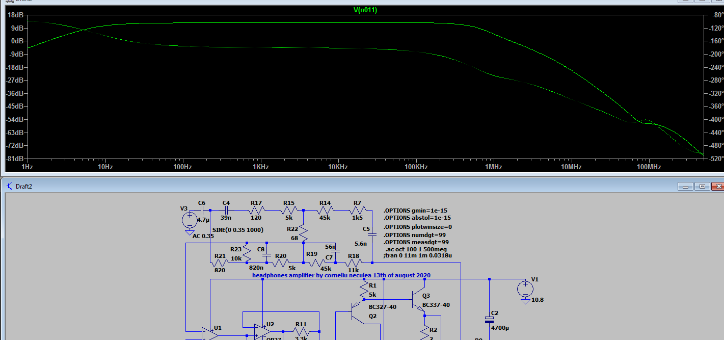

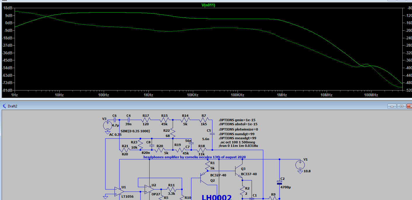

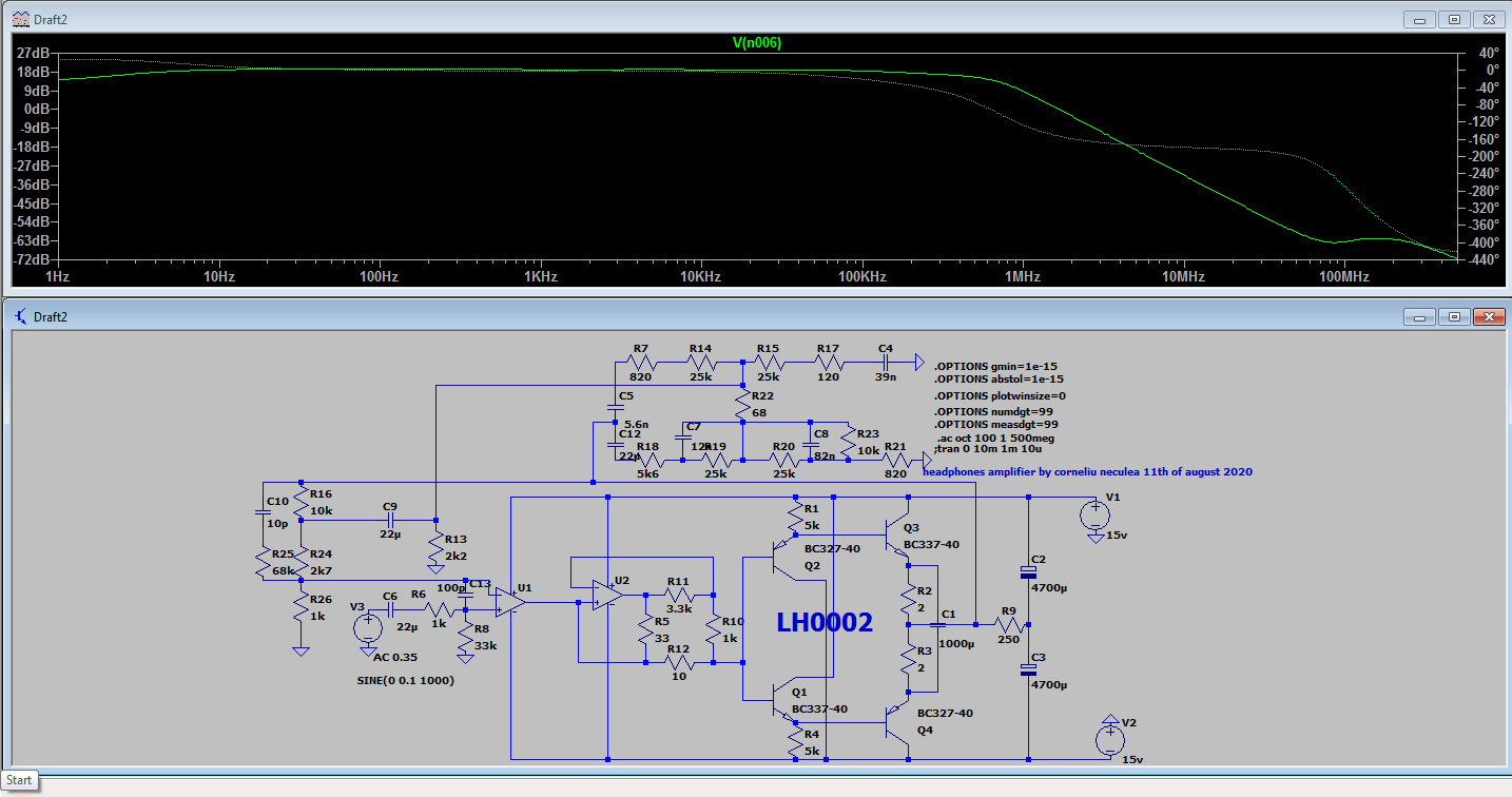

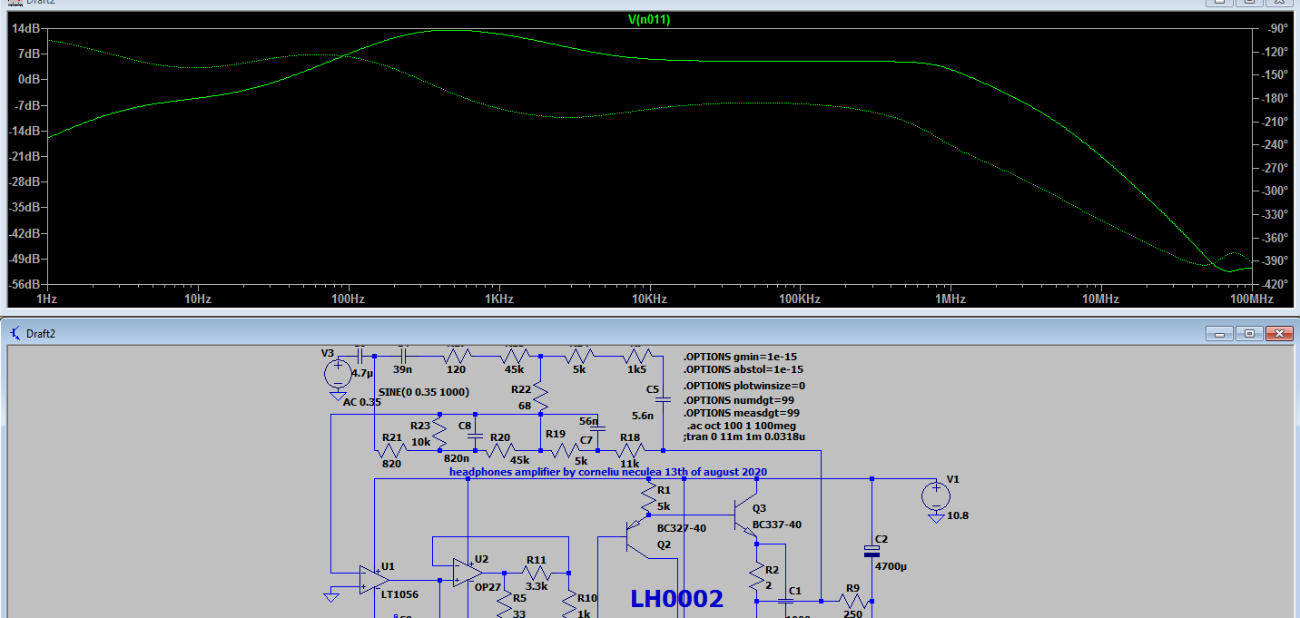

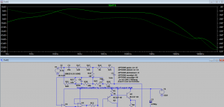

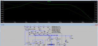

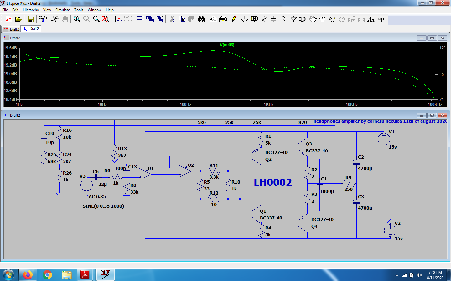

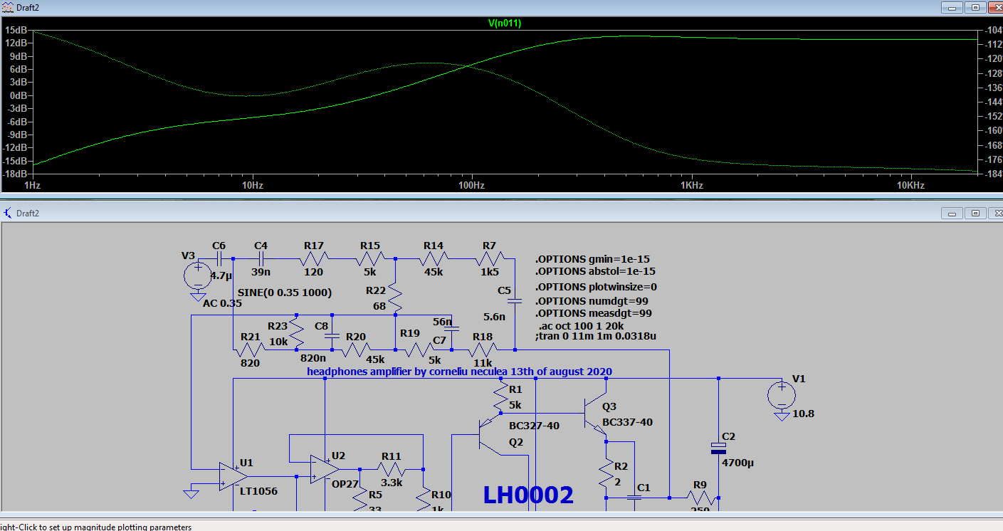

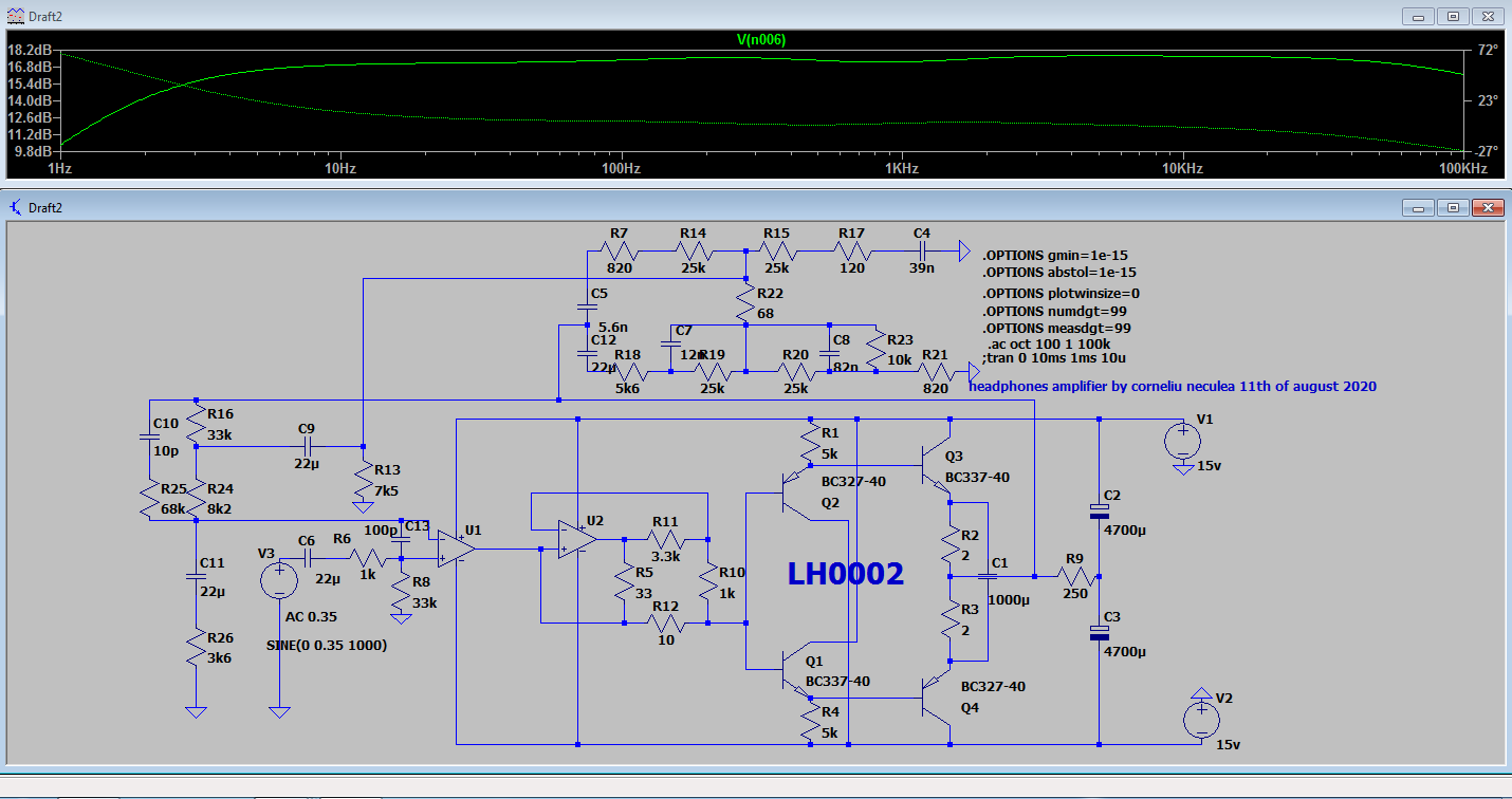

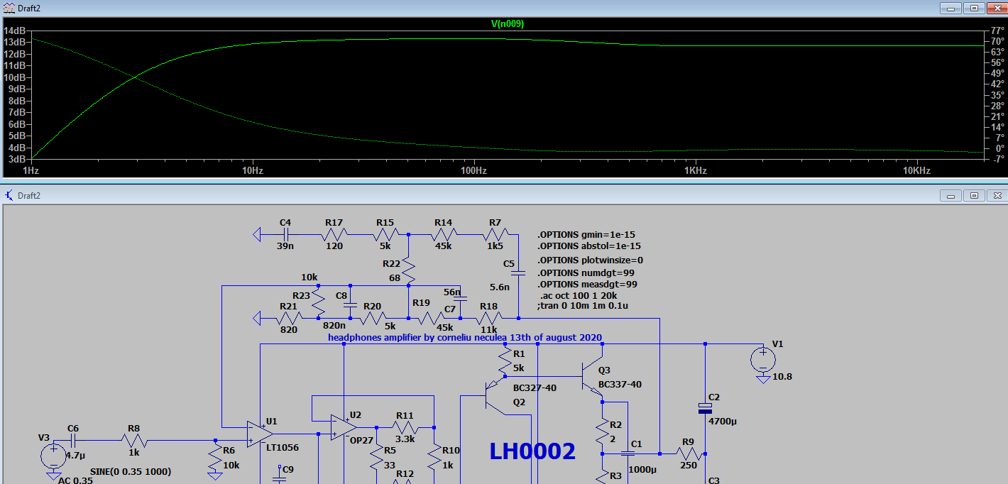

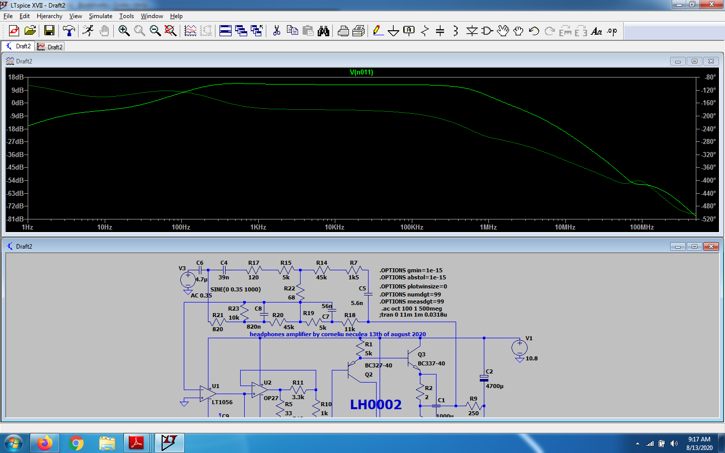

As i hardly get useful input here, i'll just show some simulations i did with the marantz pm62 circuit and some minor mods on a 10...20x gain stack because i'm going to use its model for my first experimentations of my last headphones amp based on technics AA buffer...the nonlinearity with the pots half way is 0.5...0.7db around 1...2khz
I already used on more op-amp(actually both sections of each op-amp in parallel in each channel) in the headphones amp and given the bass lack of lm6172 i'm going to use in it, i simply wanted to have it all in one go. I'll probably try other networks too cause i'd really like to have a full bass-midle-high tone stack to be honest as i'm coupling it with a phono preamp, although the other option would be to have the bariable riaa feedback in the mids area.

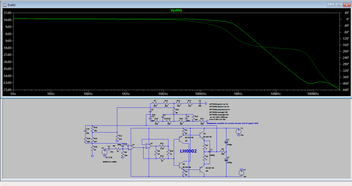

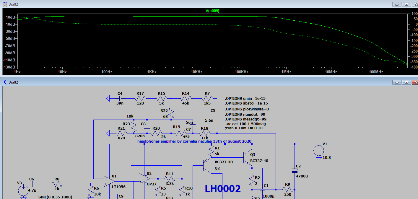

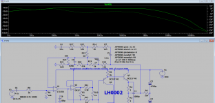

i simmd the phase shift to 500mhz and it doesn't look too bad...but im going to try more simulations with more networks to understand how they work as my math was always a weak spot...>

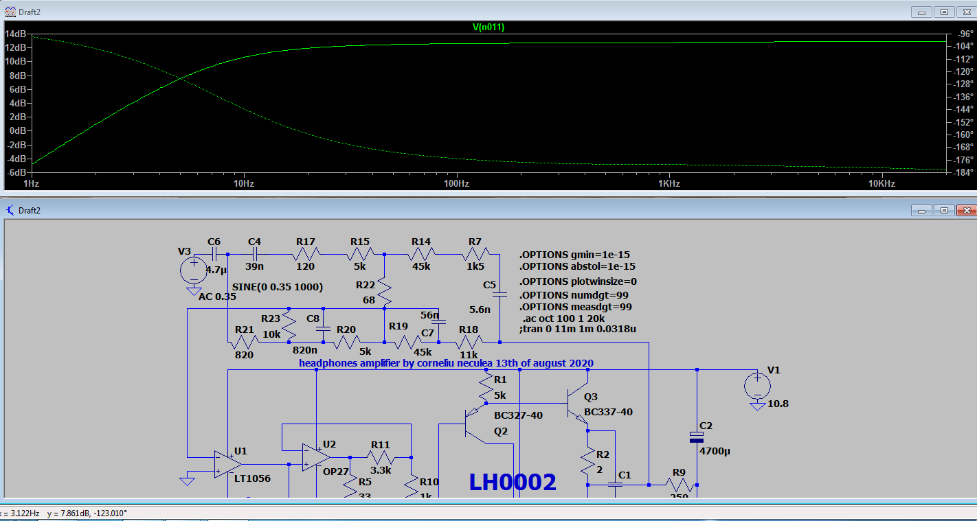

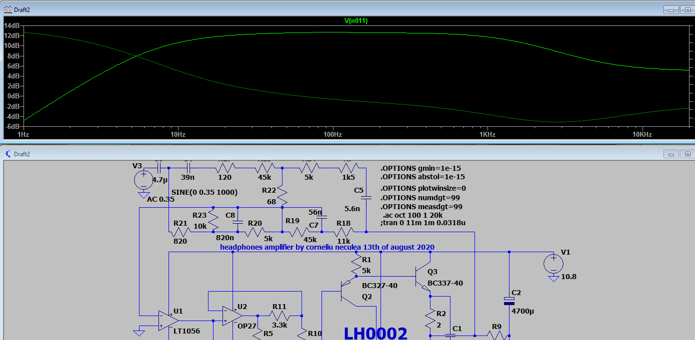

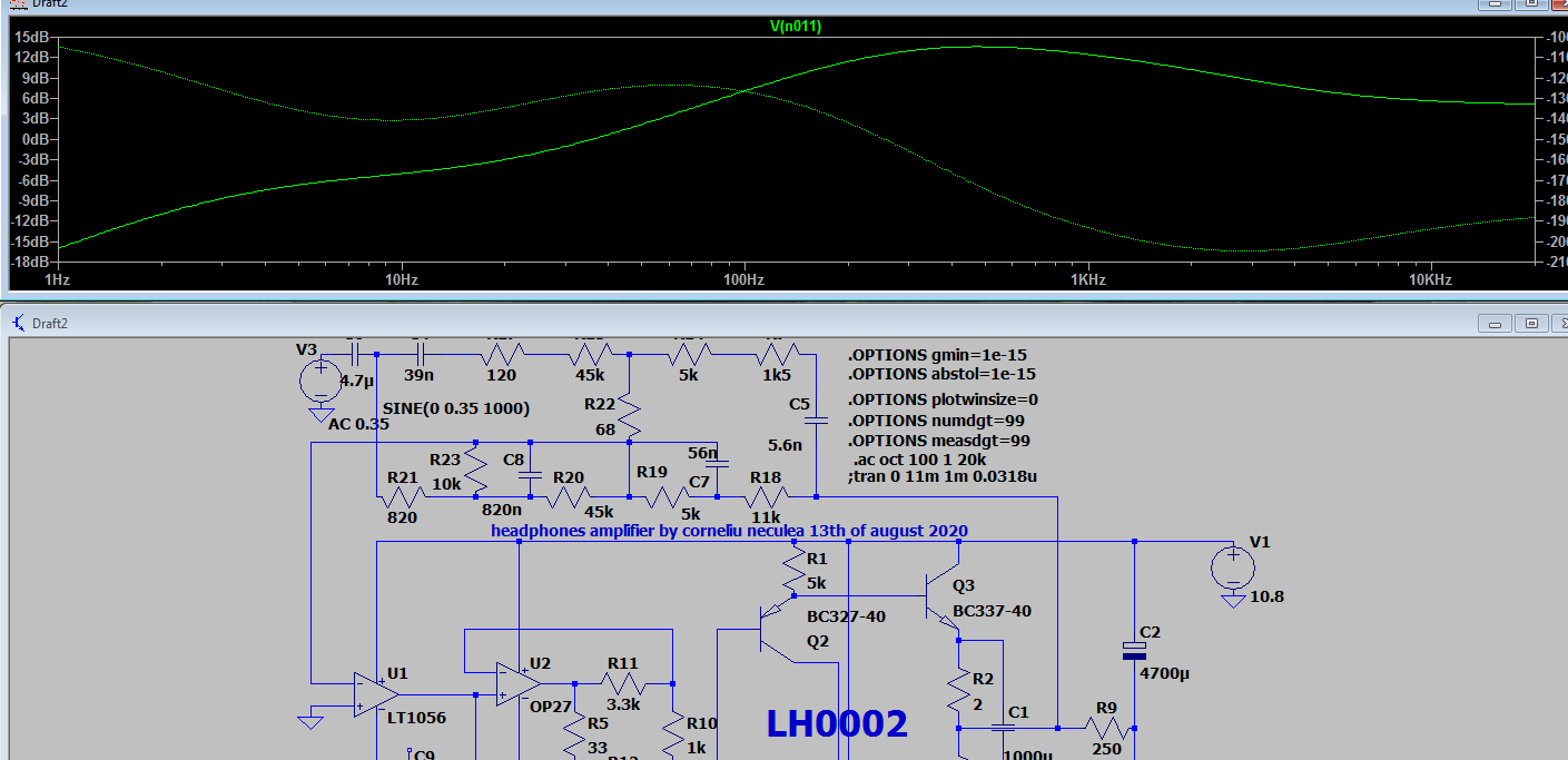

Just checked the controles at the extremes with my minor modes for lower gains and the original +-6db changed to +-2db...so its action became softer, but the 0.7db deep i got around 1khz is not very encouraging with the halfway pot.
Also the treble 10kz action is needed with most headphones so my app would be somehow failled with a softer action.

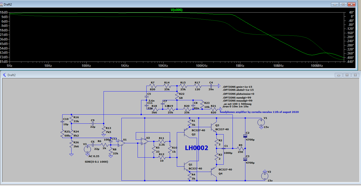

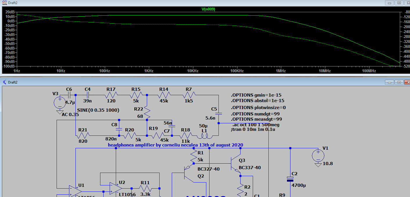

I used the marantz pm62 tone stack with some minor modifications to adjust to a gain of 12x
I think i like what i can get with this kind of setup to be honest as this type of equalizer is very efective on the mids too.It's not very user friendly , especially not the kind of eq you'd like to have on a mixing console, but it looks like doing a great job honestly.
There was indeed some instability around 80Mhz in the inverting topology which was easily cured with a small inductor between 22uH...100uH
No such instability in the noninverting topology which also came with a better SNR of about 10db at 100hz, yet no big difference at 1khz and it's around -80db at the highest output volume anyway...

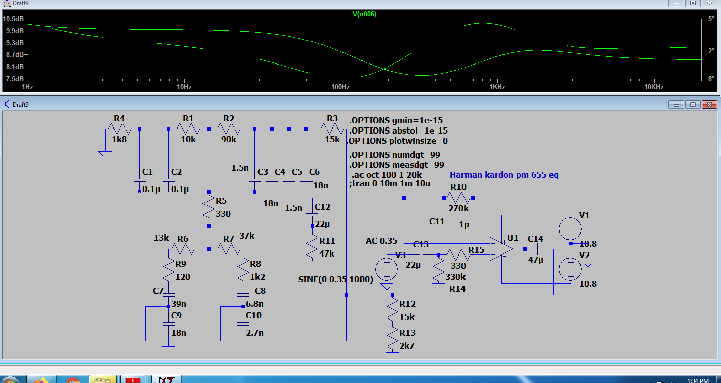

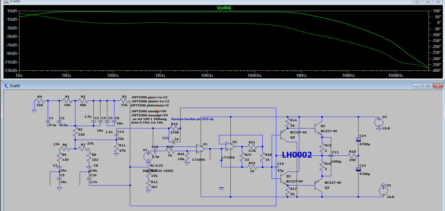

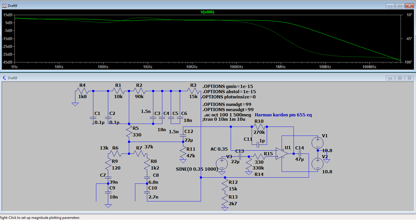

I thought that maybe the more complex harman kardon tonestack they use with a gain of around 6x will be better, but this is the best linear response between 100hz and 1khz it delivered without any modification....The response up to 500mhz looks more linear than the marantz pm 62, but the noise is a lot higher .at just half the gain...
