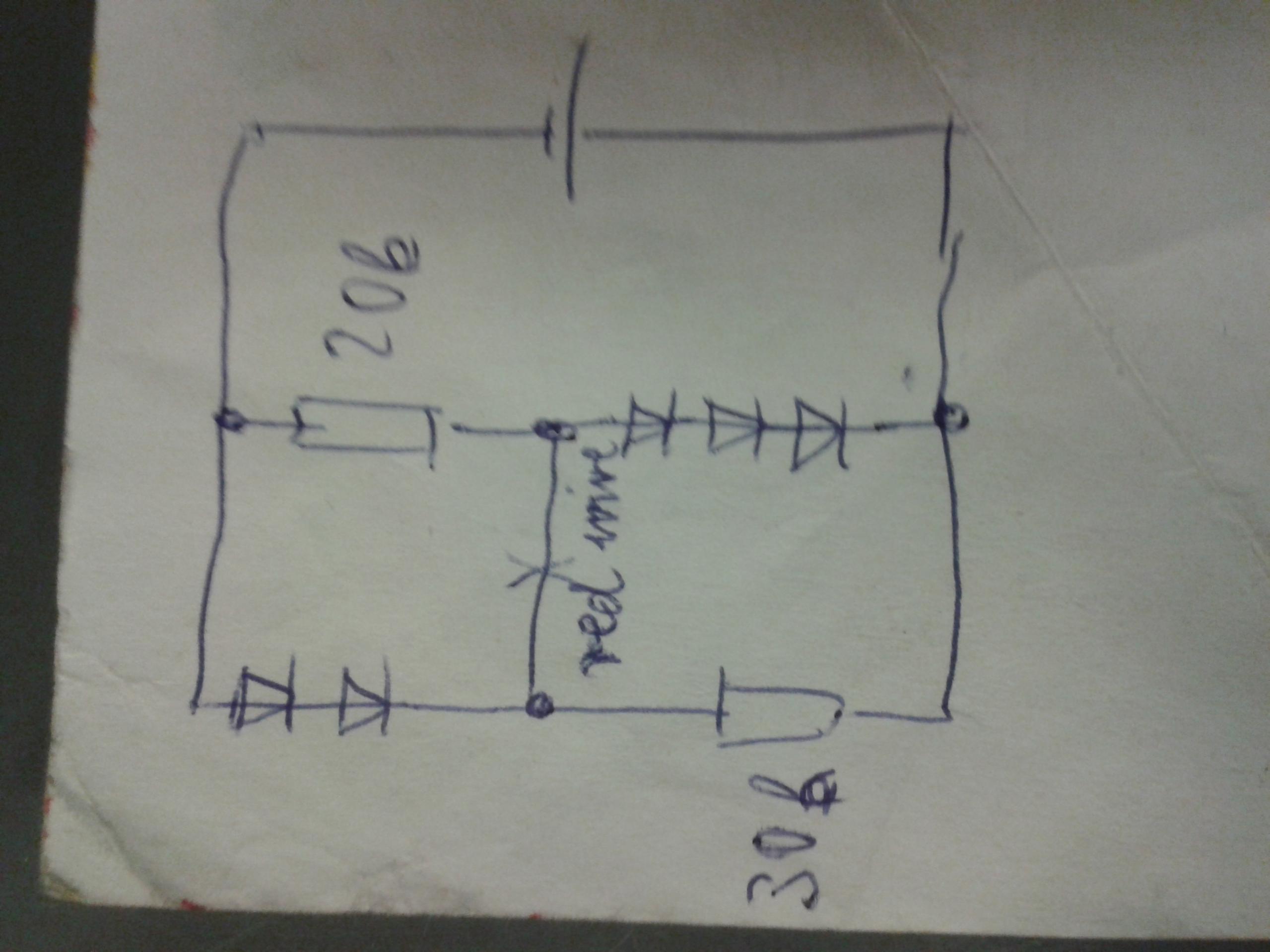

You are given a 3.0 volt battery pack (two AA cells in series), a 6 inch piece of blue insulated wire, fifty 1N914 / 1N4148 silicon diodes, and an infinite number of 1% resistors from the E96 series. Construct a circuit such that, when you cut the blue wire, battery current *increases*. Your score on the assignment is the percentage increase of battery current,
No tricks allowed, no loopholes allowed, no inductors or capacitors or transformers or antennas allowed. Battery current greater than 100mA is forbidden. Diode current greater than 100mA is forbidden. Resistor current greater than 100mA is forbidden. AC circuits are forbidden. Matched components are forbidden. Your solution schematic will be evaluated by your worst enemy who wants to see you fail; he will interpret any ambiguities or second-order-effects or other funny business, in the most damaging way possible.- Score = 100 * (I_after_cut - I_before_cut) / I_before_cut

Sorry, I have only red wire, so I failed. And the diodes are identical (since virtual ones). Also the resistors I used are probably not in E96, and these are very important factors, not like temperature...
BTW Can you tell me why is this task different from the previous? OK, more simple, since scalar by nature, but otherwise...

I must say this is a cool solution, since low ambient temperature is needed to work optimally. 🙂 I don't have time to optimize it, and I can't find temperature variable in LT Spice. I estimate the optimum should be somewhat under 0 Celsius for these resistor values.
