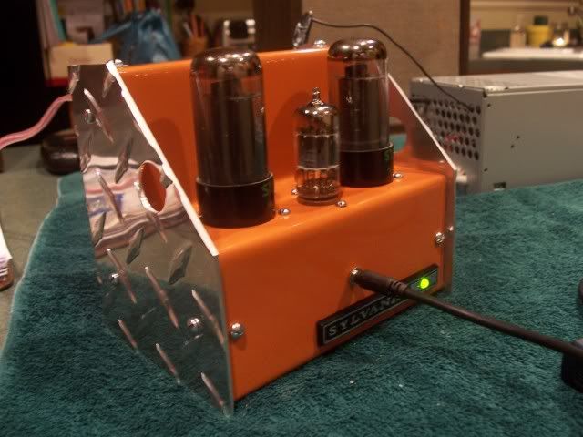

My stereo SE 12AX7/6V6 battery powered amp draws 34 watts at idle so your numbers are pretty good. Here's a shot of it using a computer power supply for initial testing.

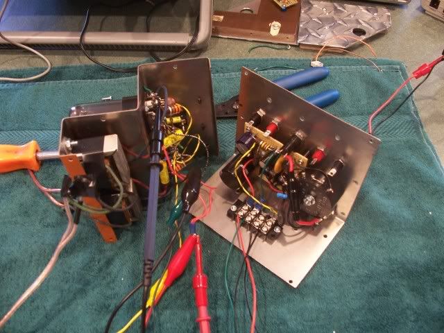

Here's the guts.
