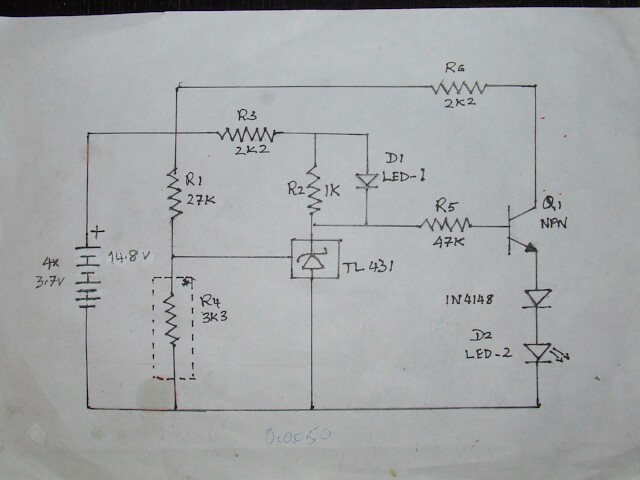

You will notice that there is no feedback on the op-amp. You are using its gain so that it acts like a schottky gate. There will be no gradual dimming of the LED, as soon as the inverting input drops below the threshold voltage the LED will come hard on.
The transistor is nothing special, by inverting the circuit you could even use a PNP.
I guess that several guys will suggest improvements but this is really basic and will do the job. You could use a zener in place of the bottom resistor of the reference divider but as its being fed with a regulated supply it isn't really necessary.
The whole circuit will draw about 1-2 mA until the LED illuminates, then the current is largely through the LED. You could increase the 470R LED resistor but that depends on the LED that you use. R = Vcc - Vf - Vce / If. So Vcc = 5V, Vf with a red LED is about 1.8V, Vce will be about 1.2V. If the LED will work with If = 5mA, R needs to be ~ 400R.

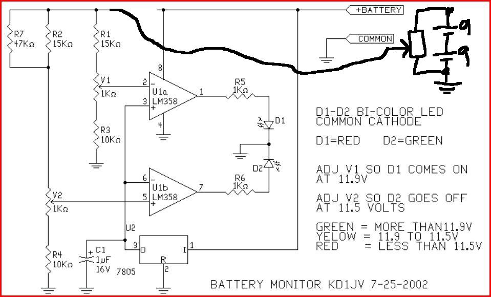

Thank you guys for all your help & suggestions. I've just tried the circuit I have on a breadboard & it works. I'm using 5k trimmers after setting the range at 1k on both. The "Green" led lights up since the voltage is 14.7v with 4 batteries. The Red lights up on 3 batteries with the voltage @ 11.1v. The only problem is setting these levels properly for the lack of a variable dc supply!
I need to fine tune these to;
Over 12.0v= Green
Between 11.9 - 11.5 Yellow (both leds on)
Below 11.5 Red
Any workabouts around fixed voltages?

"Any workabouts around fixed voltages?"
You mean the circuit in post #11 ?
Use two 9 volt batteries in series and a pot to feed just the resistor chains. Use something like a 2K2 preset and work your way through the voltage range. Keep the main circuit powered up from the normal supply.
Edit... you connect the pot across the batteries and take the output from the wiper.

Yes!...I'm not sure if I understood your 1st sentence! Perhaps a sketch if possible? A "pot" connected to the main batt. as you've suggested looks less complicated. Shuldn't this then be adjusted with the load connected,as no load settings wouldn't be the same as under load?
K&D, thanks, Yes they are a plenty,yet haven't come across any bi-colour LEDs under If of 20mA! not sure if these are rated @ If/led? or 40mA total? I'm looking for one under 5mA-10mA rating! A super bright led with a higher value resistor perhaps?
The potentiometer variable voltage supply is to be used to set the trip levels, so load/no-load isn't an issue; the trip levels are independent of load.
Don't be overly concerned with the If spec of the LEDs. 5mA through a 20mA LED should provide plenty of brightness.

The Regulator here is only a voltage reference. Its a little more accurate than a zener, but still, a 7805 is not really suitable in this circuit. Many of these types need a minimum output current for stability, and this is something you do not want eating your batteries.
A simple TL431 will do, Also try here: Maxim - Parametric Search - Product Table

Yes, I'm quite aware of the perils of using Li-ions...however,these will go through a 4S PCM card which has both cell balance & maximum charge/discharge threshold! Very handy indeed. I will be incorporating a switch too for selecting between charging/discharging.
I did look at many TL431 battery monitor circuits, but with just 1 LED; besides many DIYers have claimed that it doesn't work properly! I once came across a schematic which used 2 LEDs, but unable to find it now!
Is there anything wrong with my current schematic? I wll be certainly replacing 7805 with LP2954 regulator! Can anyone suggest a better opamp than LM358 for this if this will improve it?
Thanks Mooly for the sketch...it made it all the more clearer!
Look for micro power op-amps...designed specifically for battery operation.
In Digikey search, select the operating current and input current as very low values.
