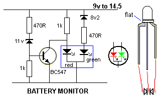

I am trying to add a battery level monitor to 4 x Li-ion batteries in series to monitor the levels. I found this seemingly simple circuit on an another site & the LED indicators are set at the following voltages.
Above 11.6v..............Green "on"
Between 10.5v -11.6..... Yellow "on"
@ 10.5v..............Red "on"
However, the above settings are a bit low for Li-ions & I need to change these to the following;
Above 11.9v ..... green LED "on" ( 2.975v/battery )
Between 11.9-11.5 ..... Yellow "on" ( 2.975-2.875v/batt )
Below 11.5v.................red "on" ( 2.875v/batt)
Can someone please show me how to calculate the component values to obtain the above levels?

The thresholds are based on the zener diode ratings.
To change them you have to get different zeners.
Or a more complicated circuit that is adjustable.
Hope that helps

I guessed it too! Would you care to explain briefly how these 2 zener values control/change the voltages? What formula or math is needed to do this?

Such a simple circuit has very imprecise levels and I would doubt you would get it exact enough for a Li-On battery for the results to be useful.
Its easy to work out how it all works. Remember a zener won't conduct until the voltage across it exceeds its marked value. So the 8.2 volt zener does nothing until the supply exceeds 8.2 volts plus the forward voltage of the LED (say 2 volts). So at around 10.2 volts the zener starts to conduct and the LED dimly comes to life getting brighter as the supply increases. So the problems there are a poorly defined operating point and an LED that varies in brightness. The other LED is "lit all the time" via the 1K but relies on a transistor to short out the LED when the other zener begins to conduct at around 11 volts plus the Vbe of the transistor. Again a poorly defined set up and also wasteful of battery power.
I once designed a circuit using a dual bi-colour LED to monitor a car battery. It used a comparator set up as an oscillator and the LED changed gradually from green through yellow and orange to red as the voltage altered.
For Li-On voltage indications I would look at using comparators and a stable reference voltage to set the "trip" points exactly... sadly that becomes a much more complex project. I would also design for "micro power" use too so that current consumption is at a minimum.

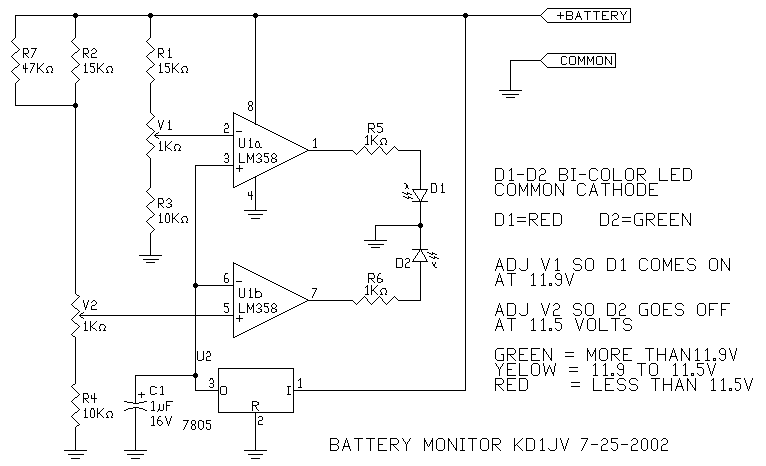

I use a variation of this circuit for projects and it is adjustable.
http://kd1jv.qrpradio.com/batmon/batmon.HTM
I'll see if I have the link for the one I use at home. It uses fewer parts and has a zener instead of a regulator for the voltage reference.

Spwalek, thanks for the link. I do have this schematic & actually wanted to try this,but was a little hesitant due it's rather high current draw. So I wonder if I could substitute either LM2940 or LM1117 LDOs than LM7805 regulator as used in the original circuit?
I have a TA7805S which is supposed to be somewhat better than other xx7805s. Would you guys recommend 7805 reg? Noise is on of my prime concerns other than high current draw!
Could you link your mod to this circuit please?

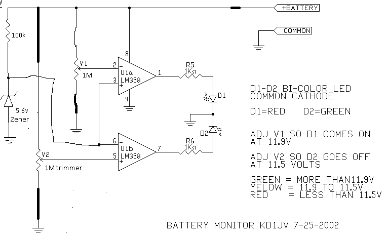

I couldn't find a link with the mods I made to the circuit. After looking at my notes I think I combined 2 different circuits. The attached gif is what I've been using. I don't know what the current draw is but all the components are common.
If your careful with layout it can fit on a 1/2 x 1" veroboard. Without checking I'm not sure on the chip numbers you referenced. I'm pretty confident that any 8 pin dip op amp will work, just check the pinout matches the LM358,TL072 etc.

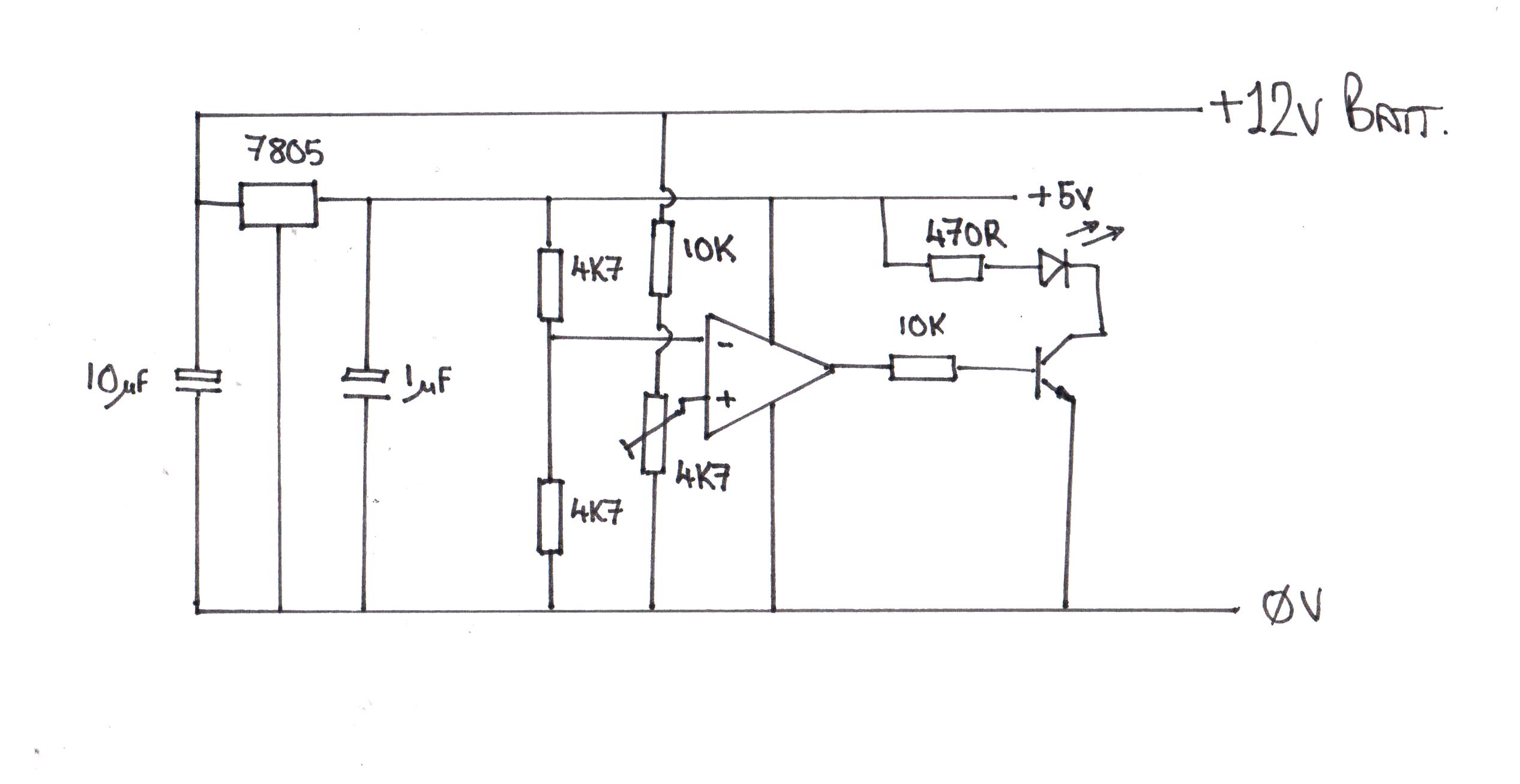

The simplest way to achieve what you want is with an op-amp. A basic quad op-amp with a potential divider on each input.
Spwalek,thank you so much for your modded schematic! Have you used 1/2 trimmers or proper potentiometers? Although I'm running 4 x 2900mA Li-ion batteries in series, my circuit consumes only around 100mA at the most. So, I'd like to try TL750L which has a very small foot print (T092) & has a quiescent current of only 1mA!

Telemon,
Look at the circuit I posted again. The zener should draw less current than the regulators would. It is just there to provide a voltage reference point for the op-amps. As far as the trimmers they are small 1/8 or 1/4 watt ones from a grab bag I bought. I would recommend bread boarding the circuit both ways and see what draws less current with an ammeter. My only concern with the regulator is the extra parts/cost

You can use almost any op-amp, even the lowly 741. Run a regular 5V 7805 to give you an op-amp supply.
Then the op-amp can have two potential dividers on its two inputs. Bear in mind that the op-amp will only allow an input up to its Vcc. So the potential dividers can be set to provide say 2.5V at the trigger point. The output of the op-amp can feed the base of an NPN transistor via a 10K resistor to switch on the alarm LED.
This method will be as accurate as your potential divider +/- the threshold voltage of the op-amp which will be mV.
Something like this.
