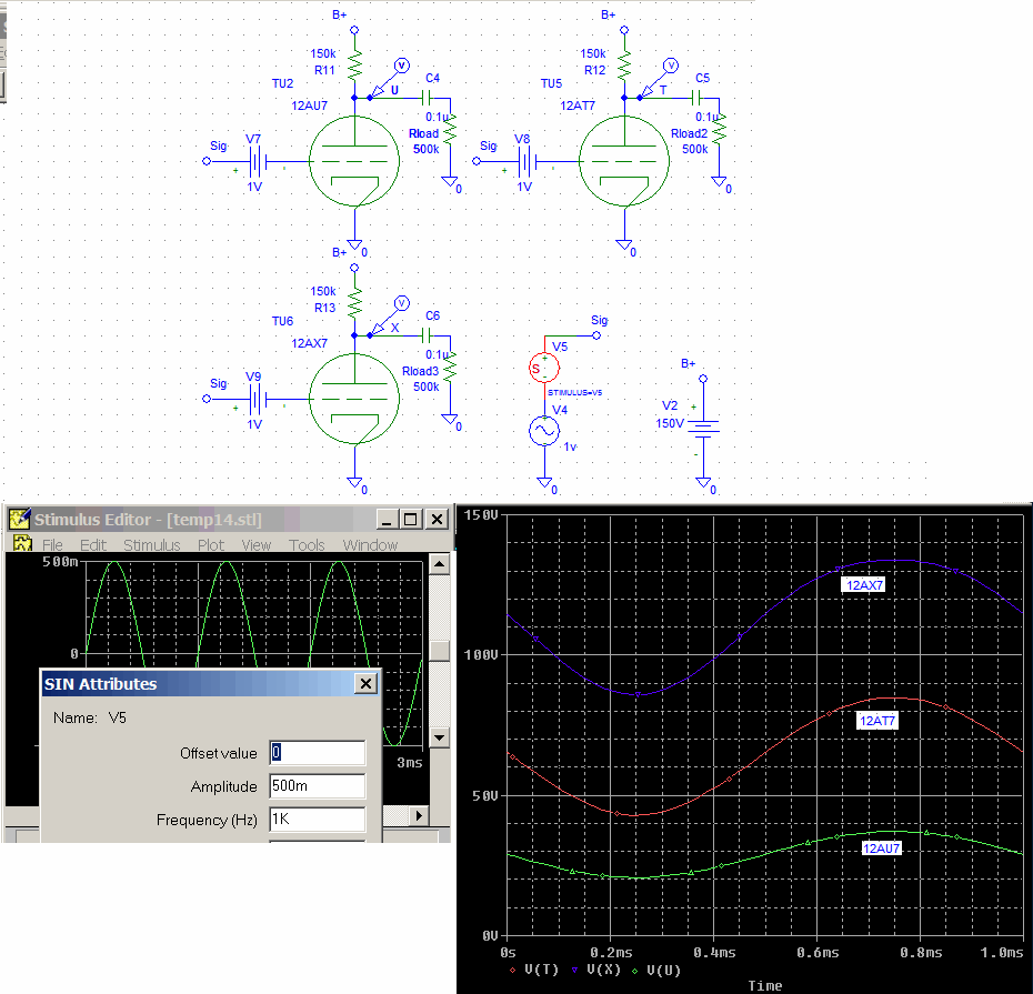

This is dangerous practice. How will you keep the tube in its design range with ageing, and changing new tubes?...
You keep the tube in line by using a brain.
The "20k" is not a good plan; I assume that was just on a clip-board.
You usually see small battery bias with LOW level stages (microphone, not line) and with 100k-470k plate resistor.
The usual tubes, with such a large plate resistor, will NOT burn-up, and do not go too far into cutoff.
My sim models do not have a "drift/aging" knob. But I can "drift" a 12AX7 into a 12AU7. The amplifier amplifies with any of these tubes. Yes, the AX gives 2.5X the gain, but that's far short of the 100/20= 5:1 change of Mu.
A triode is very robust against self-drift.
FWIW, back in the 1920s Bell Labs actually advocated battery bias for ALL small tubes not located in remote shacks. They felt it gave better balance against the drifts or the tubes of that day. (Also tubes were expensive while batteries and technicians were cheap.....)
Yes, the battery voltage should be picked in consideration of B+ and Mu. But some variation around "optimum" does not cause crap-out.
