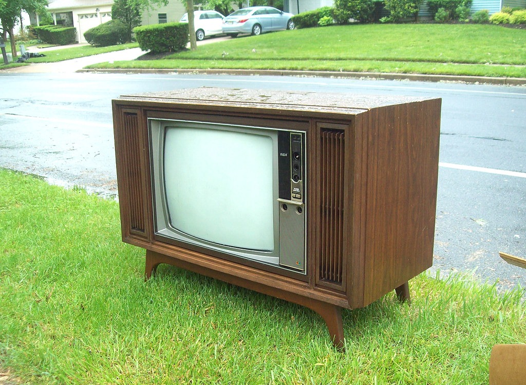

You're right!....jogging some brain cells here....this "XL100" set was the new one, it was upstairs in the living room...the non-functional tube set was downstairs in "my lair", the basement....remember the "control panel" on that XL100??? ...that silver panel on the bottom half, with the two holes of missing dials?, how it would pivot at the bottom & expose more controls at the top ?I had that exact same TV back in about 1975. It was one of the first 100% solid state TV sets. I got it for $100 at a department store because it had been repossessed and was somewhat damaged. It did not power on because one of the small plug-in modules was missing. A call to the local RCA dealer revealed that I could not buy the missing module, only trade in a bad one for a new one for a fee. I finally found a repair shop that would sell me a module for $50 so I drove to the shop. When I saw the $50 module I asked for a piece of paper and a pencil. The guy was quite cooperative as the $50 module only contained 5 or 6 black silicon diodes worth, at best a few $$$ and he only had one because they never die. If a little 2 inch module was $50 I really wouldn't want to buy one of the big ones.
The TV failed twice in the 20 some years that I had it. Neither failure was module related. The horizontal sweep SCR 's died. The old XL-100's used neither a horizontal sweep (line output) tube or transistor. They used a pair of SCR's in a flip - flop kind of circuit. The SCR's were prone to failures which usually popped the breaker or soldered in fuse. Even the RCA branded SK series replacement parts would instantly fail in this circuit, you had to get the $10 SCR's from a RCA shop.
Sometime later the picture got dim and out of focus. The focus rectifier is inside the HV trippler brick, so you had to replace the whole module which included the fat red wire to the CRT, to fix the set. I thing they were about $30 at the time.
