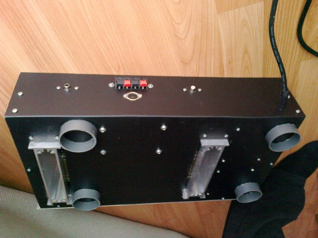

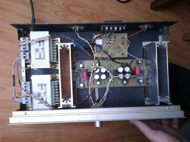

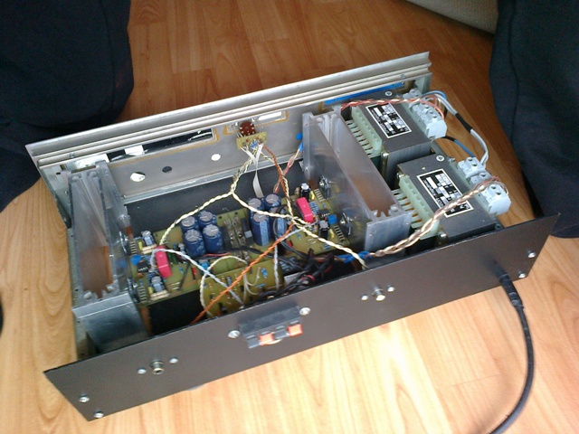

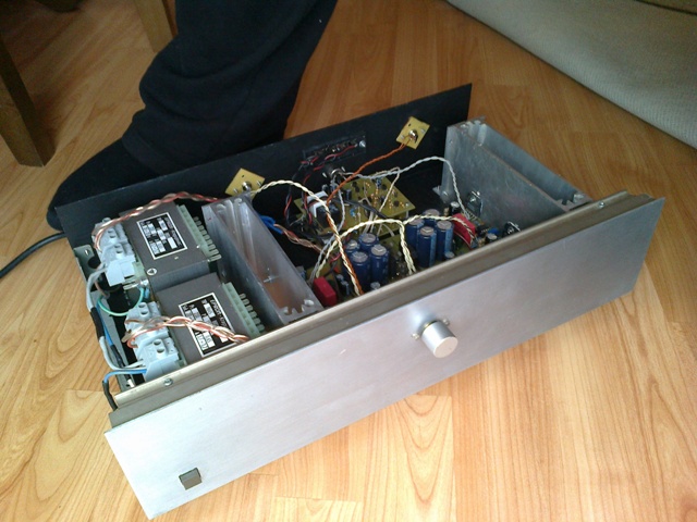

this is an amplifier designed by Dragoljub Aleksijević-macolakg,and pcb designed by me. idea was to use good sides of bridge connection with remote sense directly from speaker connectors-so that all influences of cable from speaker to luodspeakers would be avoided. as Dragoljub modestly says; "it is nothing new - at least in precise measuring instruments" and the result is...
let´s say that i am really really pleased and after ten diy amplifiers here is a new one in a top three places! stereo picture is really something at this amplifier,it loves to play acustic guitar and female vocals,but nothing else does present opstical for this amp,sounds clear at all sound stages.
it can give about 100W of power but it has to be done carefully thermal connected with adequat heatsink,it works at low power in my house and i still haven´t "put the pedal to the metal" for a longer time but it really can rock the house-power is something that it does not missed here.
"social group" pcb is to mount four lower capacitance capacitors instead one high capacitance capacitor-benefits are lower esr and esl,along with lower price.
here are the files and some video... enjoj building and listening it!

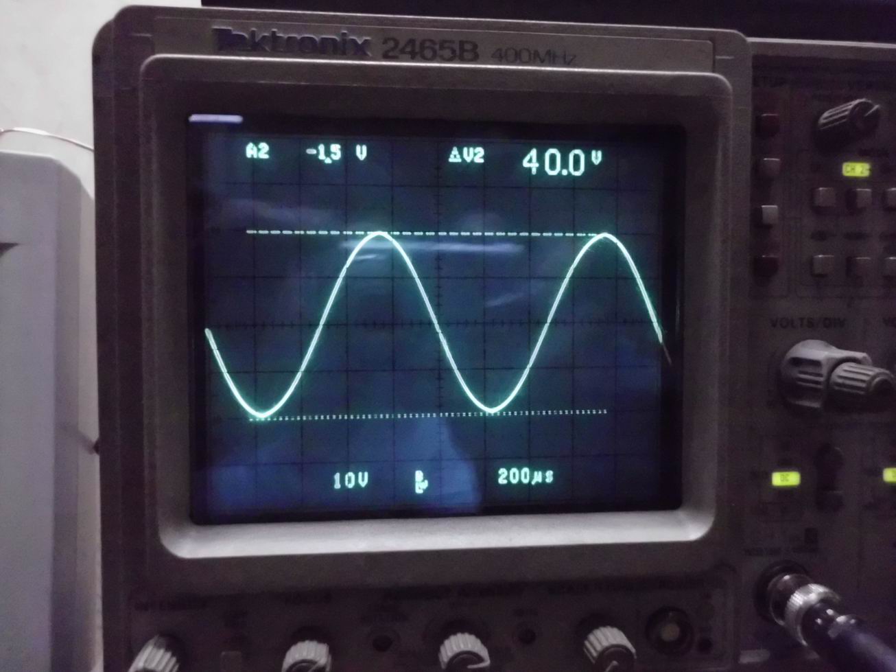

my BatoMM amp:
(first picture is oscilogram with pure 8uF capacitance load at output)
the osciloscope shows a wave at pure 8uF capacity load,amp at stabilised power supply. no hum even with open input,third day of listening shows that this is really searious amp

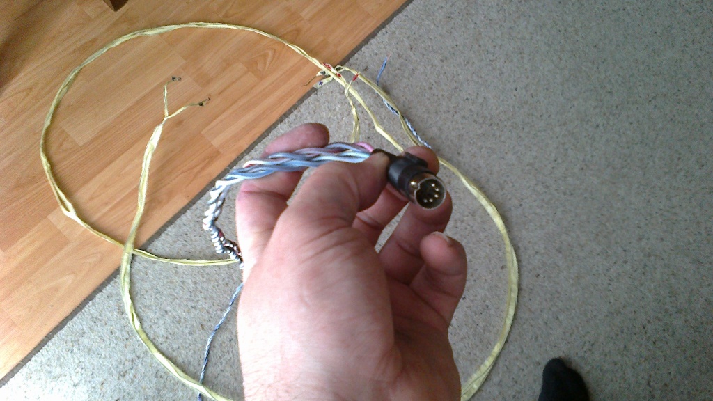

with and without remote sense connected to speaker terminals,with 1mm iron wire between amplifier and luodspeakers:
BatoMM HighEnd amp.LM-bridge Remote Sense - YouTube
it is clear how remote sense works!
only thing:remote sense MUST be connected along with loudspeakers,if you have dc-protection that has switch-on delay,remote sense must also have a delay and connect along with luodspeakers. luodspeakers can work without remote sense and with delay-amplifier will work all right.
but with remote sense connected to a speaker terminals untill protection-relay contacts are open amplifier will se that as a huge problem and will try to correct it,and that can lead to bourn out some components.
so you can use this amplifier using just internal protections from LM3886(read datasheet,it has a lot of them),
or using adittional external protection but connecting/disconnecting remote sense along with luodspeakers THAT IS A "MUST BE"!

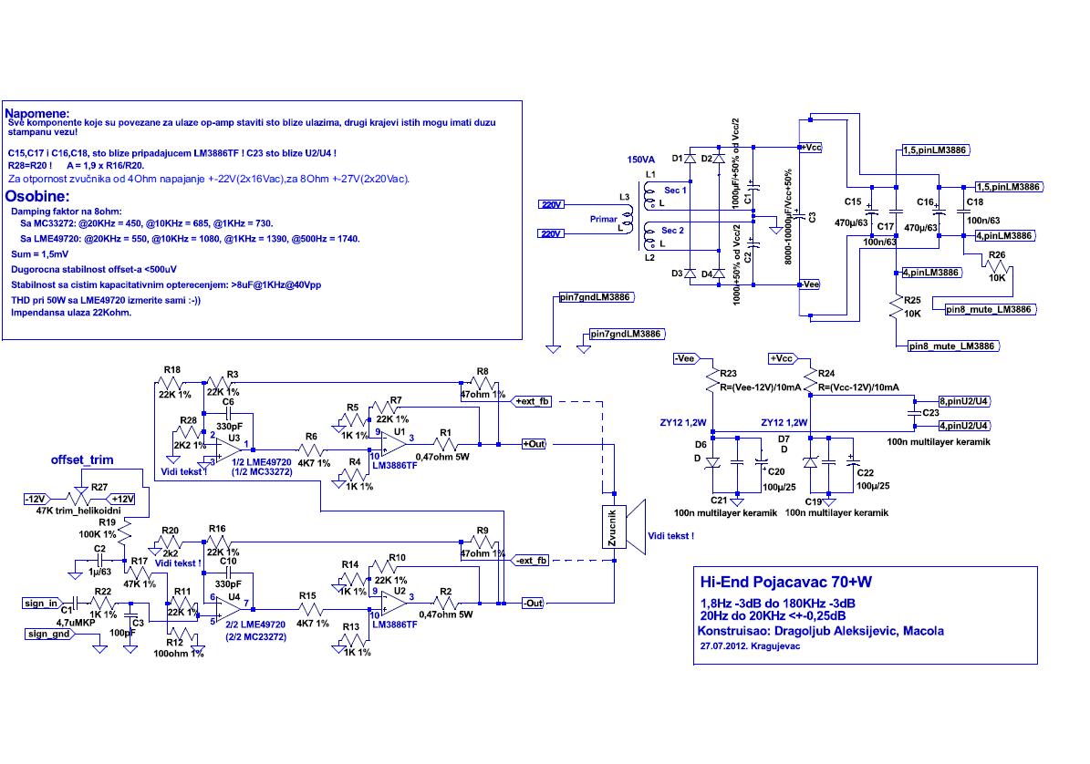

Hi, can someone explain if there is anything special in connecting r20/r28 to ground where is writen "vidi tekst !" i didn't manage to understand google traduction of text...
just do it as it is at layout for given pcb and it will work. the text means that R20 must be equal value as R28. other you can understand just looking at values and measure names.

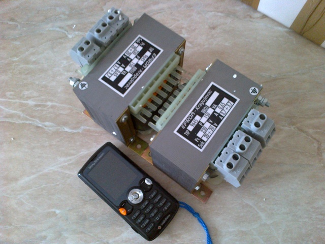

it supposes to work at +/-27V for 8r load (2 x 20Vac) and +/-22V for 4r load (2x16Vac).
"Napomene" means notes,and all text under "Napomene" is short guidance how to do pcb as good as possible,where to put wich resistor,capacitor,what should be as close as possible to IC and what could be placed a bit further of it...
"Osobine" menas features,characteristics
"Damping faktor na 8ohm" means - dumping factor at 8r load
"Sum" means - noise
"Dugorocna stabilnost offseta" menas - long term off-set stability
"Stabilnost sa cistim kapacitivnim opterecenjem" menas - stability with pure capacity load
"Sum" means - noise
