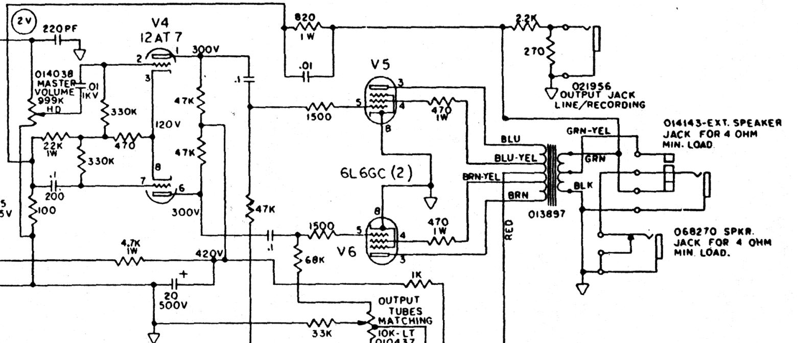

I have a Bassman 70 that has a line out.
When the line out is plugged in without a speaker connected, it works fine.
When the speaker is connected without the line out connected, it works fine.
But when you plug in the speaker and the line out, I get the following issues.
- The line out signal is many times louder, so loud it's unusable.
- I also get a very loud hum from the line out, even if the volume is turned all the way down.
None of these issues are there if the speaker is unplugged.

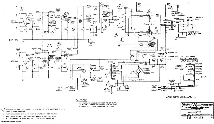

Here is the schematic. I'm unsure how to read the "jacks" for the speaker outputs. RE, the connections with the speaker plugged in vs unplugged.
To me it looks like plugging in the speaker switches in the output of the tranny into the connection from the line out (left side of 2.2K resistor). Which would pull in signal from the output tranny that isn't there when the speaker isn't plugged in.
But surely that's not correct as why would plugging in the speaker affect the line out in such a dramatic way? So I'm probably not reading the circuit correctly.

and not sure about this but it seems the line/recording jack is part of the feedback loop or derived from the same circuit so whats attached could vary the feedback signal affecting gain, hopefully others will weigh in.

Connecting the line out to the line in of a mixing board. The speaker connection is the main speaker connection, which is the bottom jack in the diagram.
Nothing is plugged into the ext-speaker jack.
Yea, personally I wouldn't use this jack, there are other ways to do it. However, the musician that owns this wants to use the speaker on stage and use the line out to take to the house board.
Even though I wouldn't do it this way, it should work, and I'm pretty sure the original design didn't function like I'm seeing this one. With the very loud noise on the line out and the huge change in volume depending on whether a speaker is connected or not.

with no speaker connected, the secondary of the output transformer should be shorted that means the feedback loop level is disturbed.
try running a high wattage dummy load on the output/speaker jack.(reduce input gain to the console, if necessary with a resistive pad)
i would also look at a repeat transformer to isolate the line/recording jack could be the noise is from a loop created between the amp chassis and the console ground returns.

Circuit works fine, you are using it wrong.
1) that Line out is LOUD by modern standards, puts out 2V RMS or more😱, and is designed to drive another tube power amp, same or similar as the one built-in , whose sensitivity is also around 2V RMS.
Remember: 70's stage levels.
You are plugging it into a way more sensitive Mixer Line IN, sensitivity probably 100mV RMS or so; Basman Line out is easily 20X to 30X too loud.
You are attenuating full amplifier output (its Line Out is just a sample of Speaker Out) by shorting speaker out by unplugging speaker😱, a mess.
You will KILL your power tubes quickly.
Solution: tame that hairy Macho Man 70´s Line Out to modern weenie levels: add a 22 ohm resistor in parallel with the current 270 ohm one and try again.
Of course, with a proper cabinet plugged in. 😎

i was just musing about the attenuation of the "stock" divider/pad and saw JM's suggestion of parralleling the 270 with a 22 ohm that would change it from an approximately 10:1 to a 100:1 pad....much better me thinks...

I think what I will do is essentially both. Install a 22ohm in parallel, then recommend the musician take that into something like a radial JDI or ProDI. Giving him the option to do that or go direct in without it.

Just a bit of an update, I installed the 22 ohm resistor, that worked great. Still have a hum/loop that I've not has time to try to pin down.
