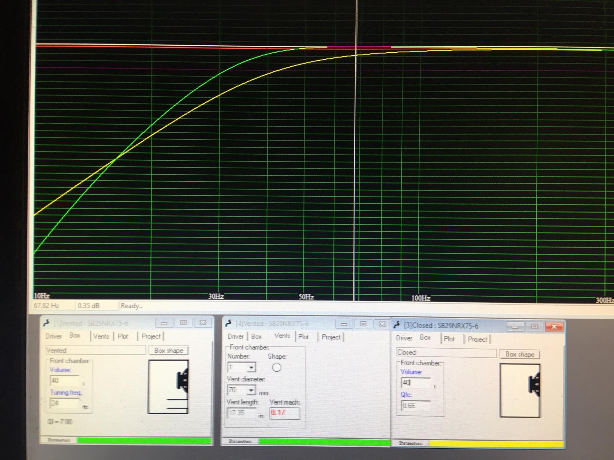

You haven't touched on the tuning frequency you have arrived at w/70mm port. How long is the pipe? I'm guessing it is too high which will give you peaky response in the low end and drop like a rock.
Tuned to 21 Hz
Not stuffed just felt on panels and baf waddling in base of cabinet.
Port is flared both ends and has a 90 degree bend.

Not sure if you have tried modeling your speaker but here are some interesting stuff about what you are doing. Based on this. You can try it, very easy to use because the speaker is already in the database.
Speakerbuilder Pro 2.0
1) Your port will be about 2 feet long. Might a challenge to fit inside your box. Nobody sells a 2 foot port. So will need to link a PVC pipe to a flared port. Also might be a bit tough to fit your box. The ideal size is closer to 80 litres. So your box is kinda small.
Change your tuning to 30Hz and you will get a slight bass boost at about 40 to 50 Hz, and could potentially sound quite nice. Port will be about 30cm.
2) If you were to do it sealed. The frequency response would be the same as ported at 21Hz and yet your system will not run out of excursion because if the incredible x-max of 11mm.
Oon
Here are a couple of winisd sims in 40litres, both vented and sealed. Looks good enough to proceed in my opinion.
40L sealed is pretty close to ideal with a Qtc~ .66, f3~ 42hz and a nice shallow roll off.
40L ported is a bit undersized but does lower the f3 to ~31hz with a steeper roll off.

I think you might be missing the point. Designing the speaker is about choosing the compromises you want. For bass reflex, it will improve the bass response and increase the power handling if properly designed. However you box will be bigger. For sealed, you will have less power handling and generally poorer response but the upside is the box will be smaller.
So the problem now is the box is too small and the vent diameter too small you will not achieve the 2 benefits of BR and you might be better off sealed. The port is now crippling the speaker. Based on simulation, your speaker will be giving puffing sound at about 20-50W. But if you run it sealed, your woofer can run to over 100W without any issue because of 10mm Xmax. If you are going to run 20-50W only a 8 inch speaker might actually give you better bass performance than a 10 inch speaker in a 40liter cabinet. Have to sim to find out. In addition a sealed speaker actually has better transient performance.
If your speaker had only say 5mm of xmax, I might have suggested port to increase power handling but 10mm xmax, your woofer will probably be louder sealed than it would be ported.

I cannot understand why anybody would tune a 40litre cabinet with a 10" woofer to 21Hz. In simple terms: a port offers a 3dB increase around the tuning frequency by utilising the output from the rear of the woofer. At 21Hz you are attempting to add 3dB to 'nothing'.
If you reverse engineer a commercial subwoofer with 10" driver you'll find the ports are tuned above 35hz.
