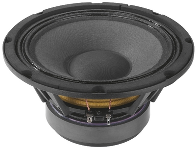

this 12" is my choise

18" woofer is also a PD
Precision Devices International Limited

Anyway, so far I have decided fore the 12" PrecisionDevices, its artwork 😉
