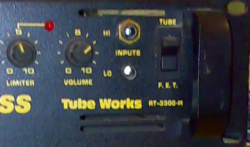

this is my amp tubework 3300RT , not me on the video
hey, its cheating, thats not a tube amp 😛 but much better, its a mosfet SS solid state 😀
it has a switch so you can choose tube or fet for preamp stage , i believe the tube is a 12ax7
You 'can' get clean, but what would be the point? - it wouldn't sound any different to a transistor amp (but would be massively larger, heavier, more expensive, and under powered).
This is why most bass amps are transistor.
mine is a hybrid 300w
you can choose see switch in picture
you mean the 'high/low' gain switch
its probably so that the fet input is on all the time, as a buffer, with the tube bypassed
switching to high gain, and the tube pre is on
but thats 'just' the preamp section, and got nothing to do with the output stage
my guess is that the mosfet power amp is also driven by solid state devices
in that sense the power amp is a pure solid state design
ups, I see now there is both a high/low input option and a switch to select either tube or fet input
but its still the same thing
its a preamp section, and seperated from poweramp
power amp seen seperately is most likely a pure solid state design

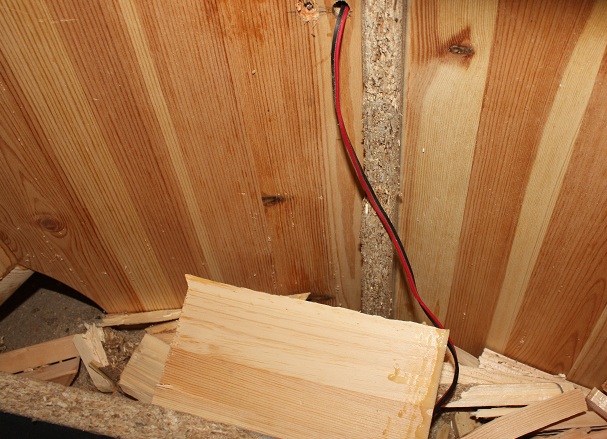

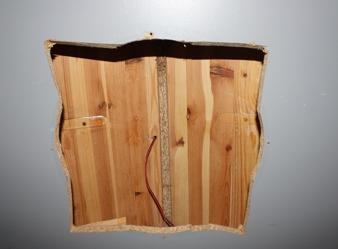

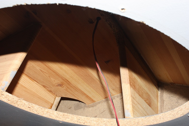

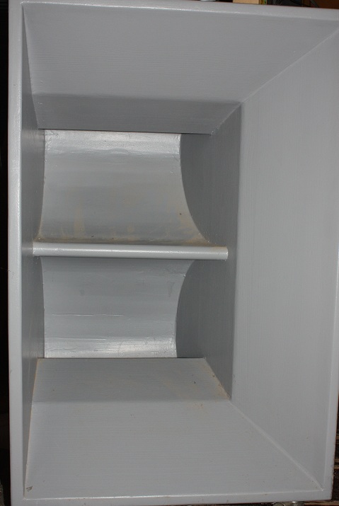

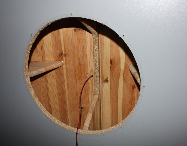

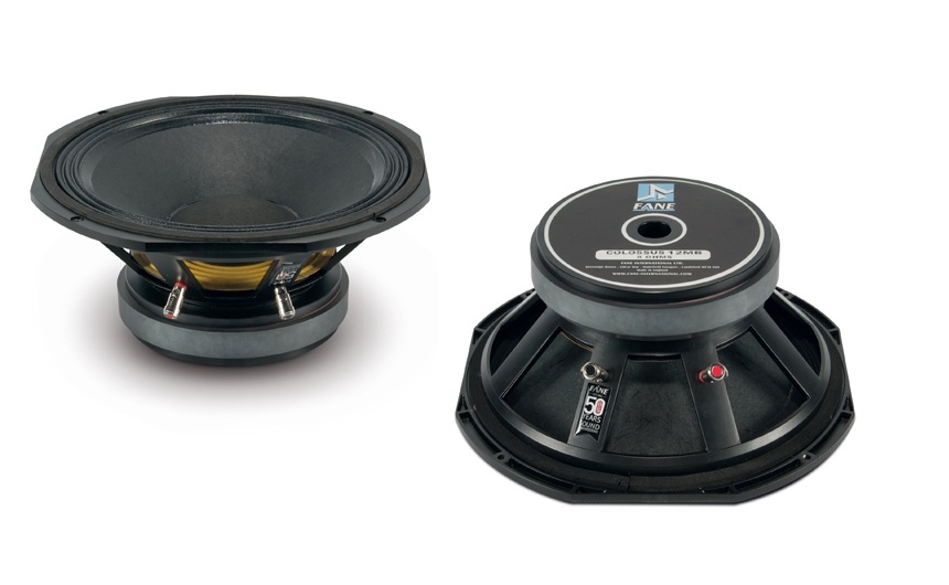

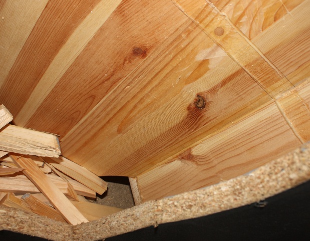

to those who wonder what this is all about
its calculated like a frontloaded horn
but built like a backloaded
and I was using a semi pro 15" with too high Qts
or at least I think its a major part of the problem
so, the project is to mount the woofer 'inside', giving it a small back chamber, as it should be have been from the start
