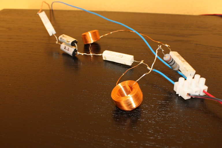

below is tweeter xo
just a series inductor on 8" midwoofer
and nothing on 15" woofer

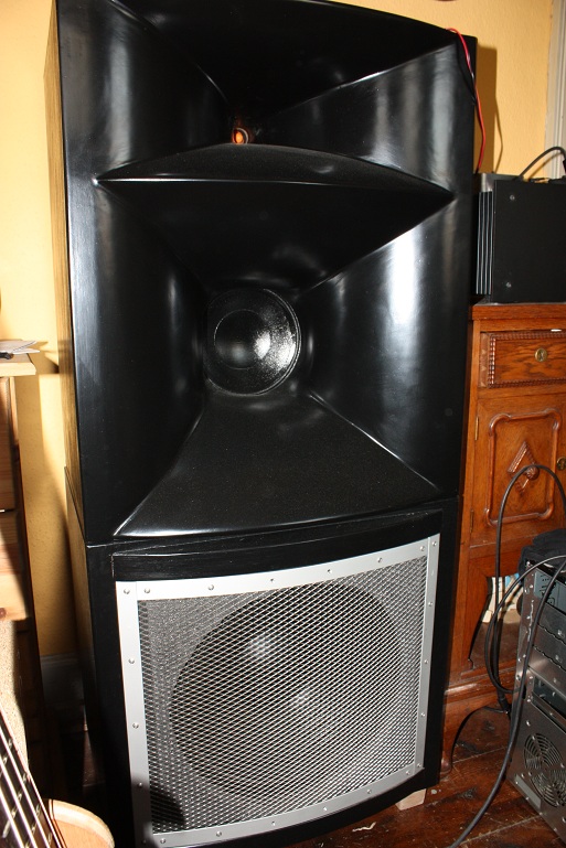

Ex-Moderator R.I.P.
Joined 2005

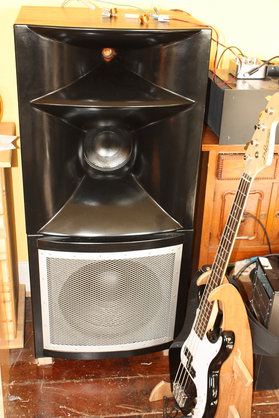

and this time hopefully a better photo of the finished speaker
have to say, its quite nice to have in the room :)
well, honestly, Im sure there are much easier ways to achieve the same
or maybe even better
but I had some time to kill
and it was fun
hope you have enjoyed some it too
cheers
Lars

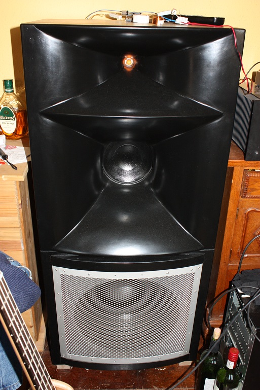

Ex-Moderator R.I.P.
Joined 2005
hmm, what can I say more about it
well, Im now playing better than ever before
and learning faster too
my two pre effect ''pedals' are now able to give me 4 different sounds, just by using their bypass switch
no other adjusting needed, once set properly
all 4 are good, for different kinds of music, and playing
each sound is not very different from each other, but still enough to affect how I play
so I guess thats ok

Ex-Moderator R.I.P.
Joined 2005
tweeter xo
I increased series cap from 4.4uf to 6.9uf
a step in the right direction
no sound heard from tweeter, as such
only faint hiss noise :mad:
but overall sound improved
playability and precision got faster, somehow
'touchy' stuff :confused:
allready thinking about a simpler 'version', with similar good sound:eek::D

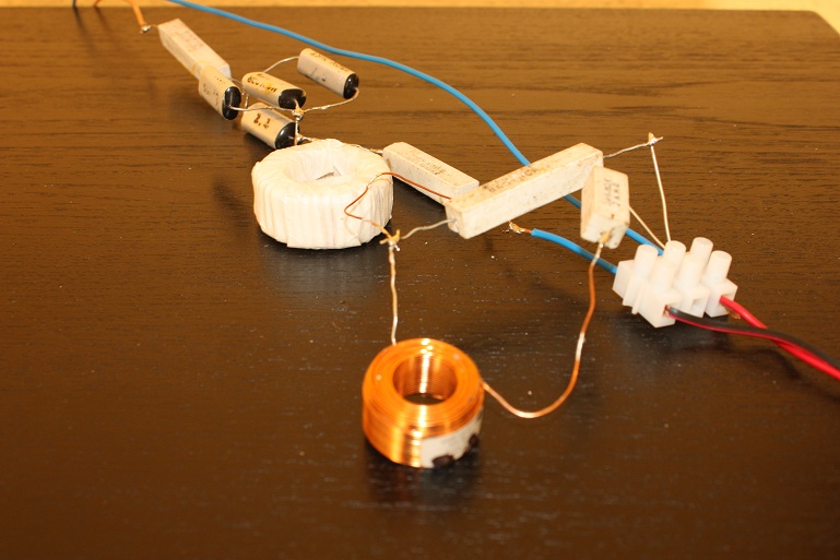

Ex-Moderator R.I.P.
Joined 2005

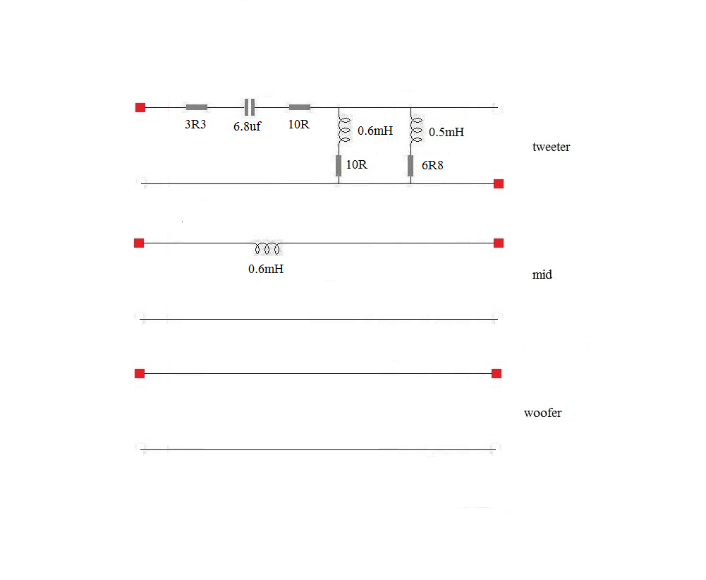

crossover, but still preliminary
not looking perfect at all, but it works
because I have made multiple changes and adjustments, and all resulting in improved precison and playability, I would say it is getting quite good now
but I need to buy more components to any further
still surprising how much a tweeter xo affects the playing

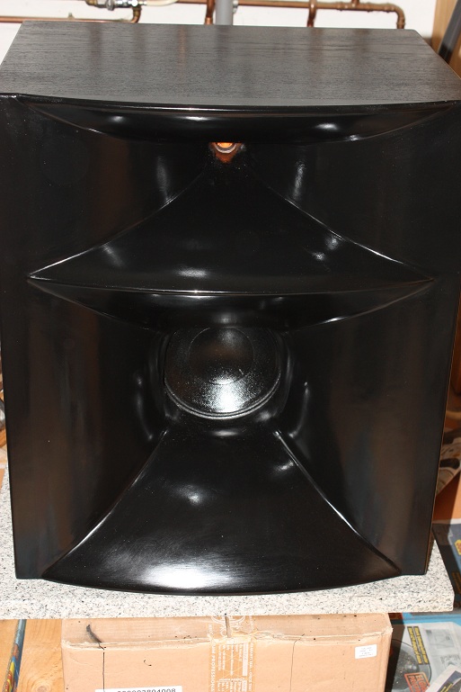

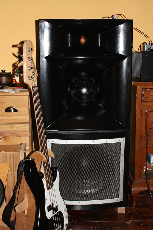

Ex-Moderator R.I.P.
Joined 2005
shoot, paralel inductors were shown/drawn with wrong connection
corrected, and a bit different :smash:
btw, I shot a few new and better pics of my project
I think you can take it just once more :D
Im beginning to enjoy it, and it more and more every day
got nice tune, and rocks, its good :)

Ex-Moderator R.I.P.
Joined 2005

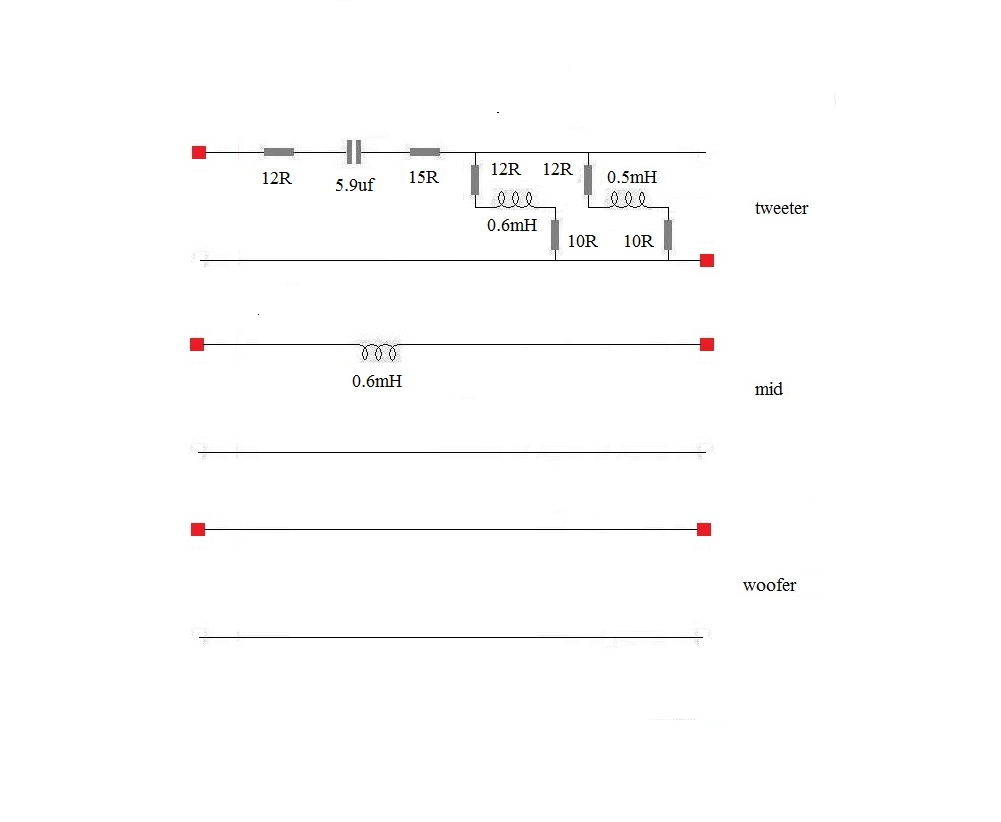

crossover change/update
less noise/hiss
and now the 'onboard' tone control pot on bass guitar actually works
makes the sound more airy, instead of just 'nasty'
and even better tune, improving playability further
compressor pedal arrives in a few days
will be interesting what that will do

I have now tested it with hifi music
better than expected, given the poor xo
but not much to write about either
but the tweeter is the really big surprice
and indicates that my tweeter xo might work
sounds very 'hifi', and clearly points the direction for my future home hifi
the next positive surprice was woofer lower midrange
but also clear that the early bass rolloff result in wimpy 'cardboardbox' bass
only way I can describe the effect
even so, for bass guitar it still produce very good and low bass
at times maybe even too much
just one of those weird things I guess
as for the rest...well
have to work on upper midrange(bigger inductor)
