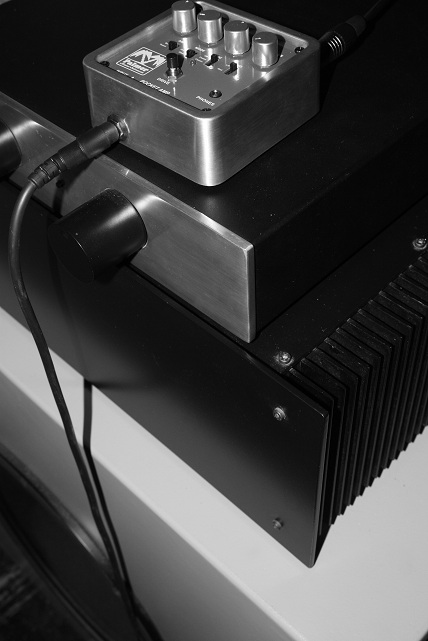

a good speaker still needs amplification
and hey, what can be better than a good handbuilt SS hifi 'monster'
bloddy expencive if you want to buy a good solid state bass guitar amp
but this an old friend of mine
and then theres the tricky preamp thing
tried a combo, which wasnt exactly love at first sight
so here is what I will give a try
Ex-Moderator R.I.P.
Joined 2005
so far, amp combination works
or should I say makes sound, with some noise
maybe its the low impedance load of receiver
power amp, 2kohm input :eek:
still some work to do :p
have the preamp(stereo) designed to drive this particular power amp
may need to drive through this
well, sound have definately improved, and got cleaner
but its very clear now that the horn I built is 'difficult' :eek:
its doing something right, but still a too 'ressonant'
Ex-Moderator R.I.P.
Joined 2005
and with the proper preamp, able to drive a 2kohm load, what a change
suddenly my woofer isnt so bad at all
clean clean clean
noise is gone, nada
and BASS in spades, DEEEEP bass
wow, huge difference, really
special case with this power amp
dont know how it is with other amps
but still worth a thought
not cool to think I was going to trash the woofer, and throw midbass horn in the dumpster, built with sweat
and now I hear the coolest bass ever
how lucky can one be :)
now I hear a song in my head...long and winding road
