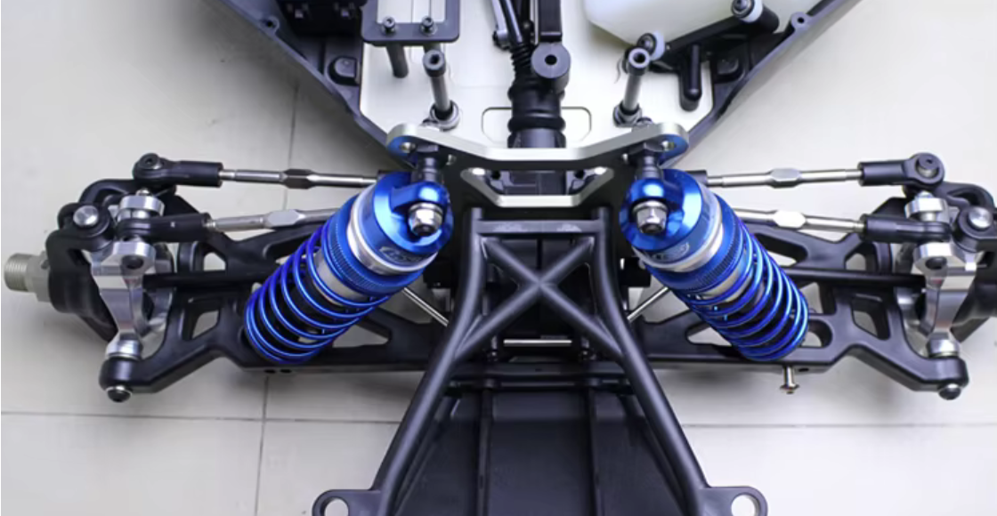

This pic below illustrates a front setup from the 5IVE-T 1/5 scale AWD that I will be borrowing parts from. Working from outside in, there are the hub and carrier parts that attach to the suspension arms

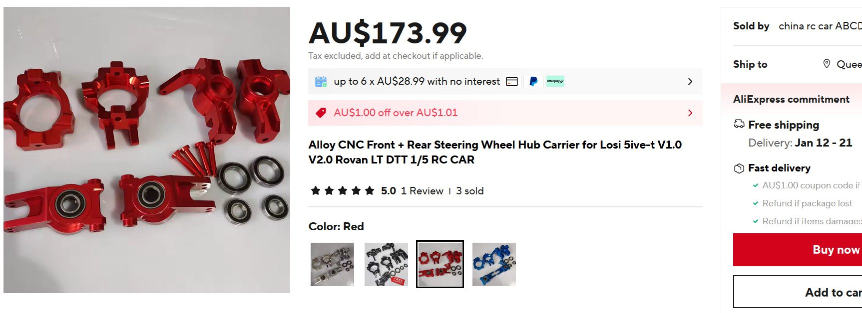

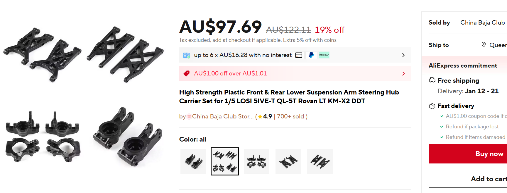

These are the parts from Ali in tough plastic and all the parts are also available in alloy
The 5-T has enough following and there are plenty of custom struts/shocks/tie rod options. I will be using 10mm shaft systems and have found that front knuckle can fit a stainless uni joint in the housing instead of the stock CVD. This will allow me to fit an all 10mm stainless axles front and rear. The bearings are also on Ali and the sealed types. They cost around $10 for 4 units, so can be classed as consumables

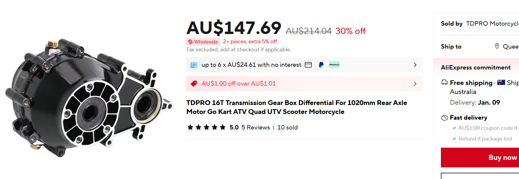

Thinking about using this diff in the pic below. My idea is to use this as a transmission for belt drive. The input shaft can accept power via belt from either an ehub or petrol motor. The output shafts are independent, as in a proper diff. I want to try to use the left output shaft to send power via belt to the left front and rear and right to the right front and rear. The pulleys on these output shafts can set final ratio and this can be a cheap DIY job
