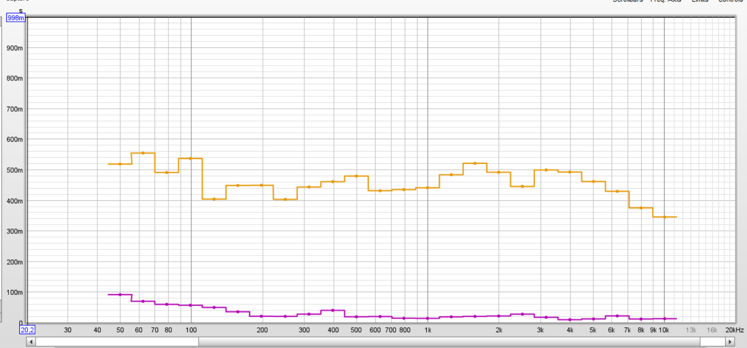

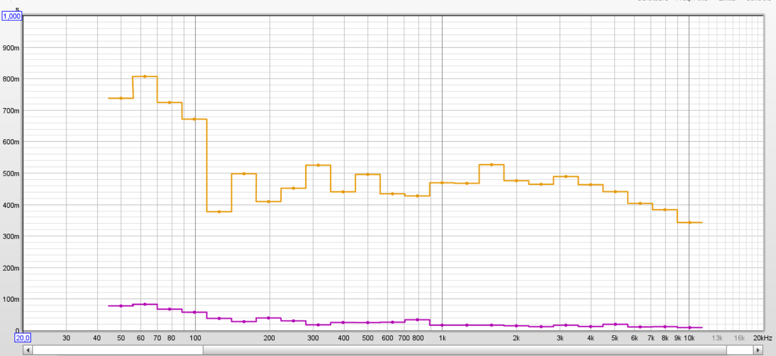

My sweetspot is front of sofa, but I'm often sitting at the sofa, using mic on stand front of sofa, and just rotate the boom to get the listening spot, left and right, and then sofa position. Measured LR playing together and SUB, then using the alignment tool exported aligned sums with 2ms delay intervals, and zoned in to lowest decays around 60-100Hz which seems to be most problematic for some reason. Zoned into a delay time, checked same delay with all the measurements and indeed decay times better on all of them.
Adjusted EQ some to knock out worst offender around 60Hz, and it didn't seem to affect decays much. If I did more EQ, there stareted to be some differences.
Frequency response is now different than before of course so hard to directly compare, need to listen for some time. From this quick experience it seems it's possible to adjust the decay times and frequency response somewhat separately: Use position and delay / phase adjustment to make lowest decay times, and then adjust with EQ if necessary.

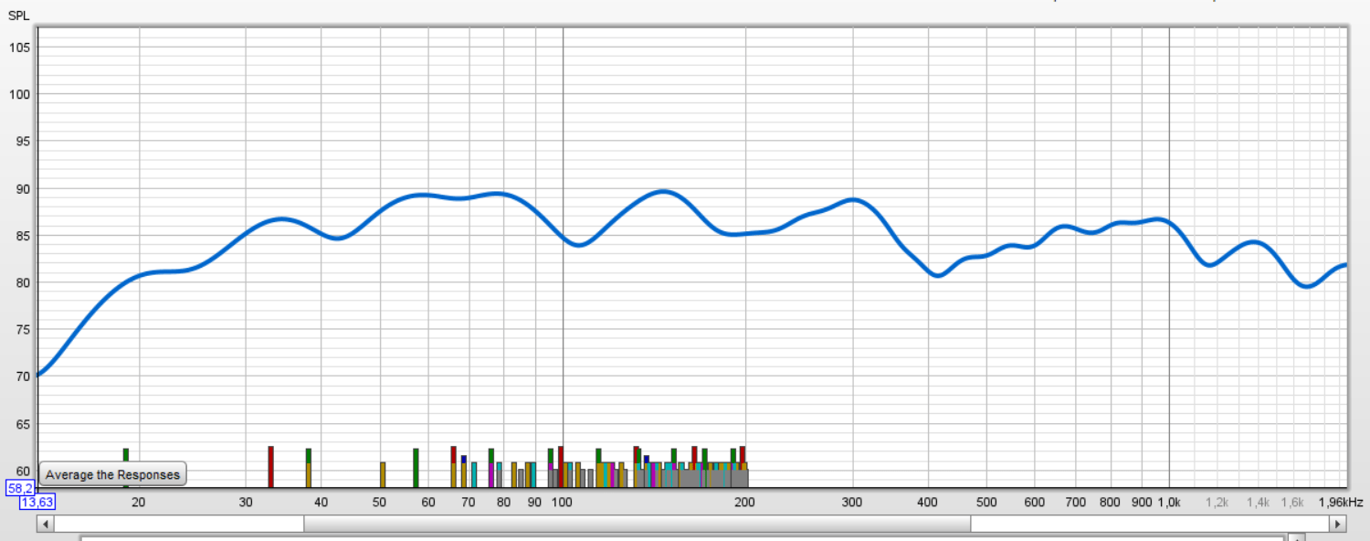

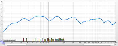

Here, one sub and mains, sub on the left wall on the first images and adjusted using all tricks to make nice nice frequency response, never though to check decay times. Decay times shoot up around 100Hz and below.

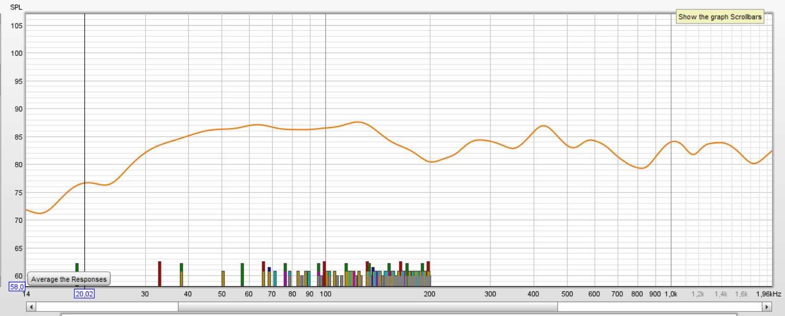

Here sub is on the back wall and delay adjusted for lowest Decay times, and then some quick EQ
These are from separate days so mic was likely bit different position, toe-in is different, sofa is likely bit different position and so on 😀 Just a demonstration that frequency response and decay times can be adjusted somewhat separately, even with one sub. Not sure how big audible difference is as I can't AB them due to sub position changed.
Subwoofer behind listening spot have been nice, I think it works as good as any position and setting I've had it. Hard tp say if it is best position and setting but seems to work nicely.
