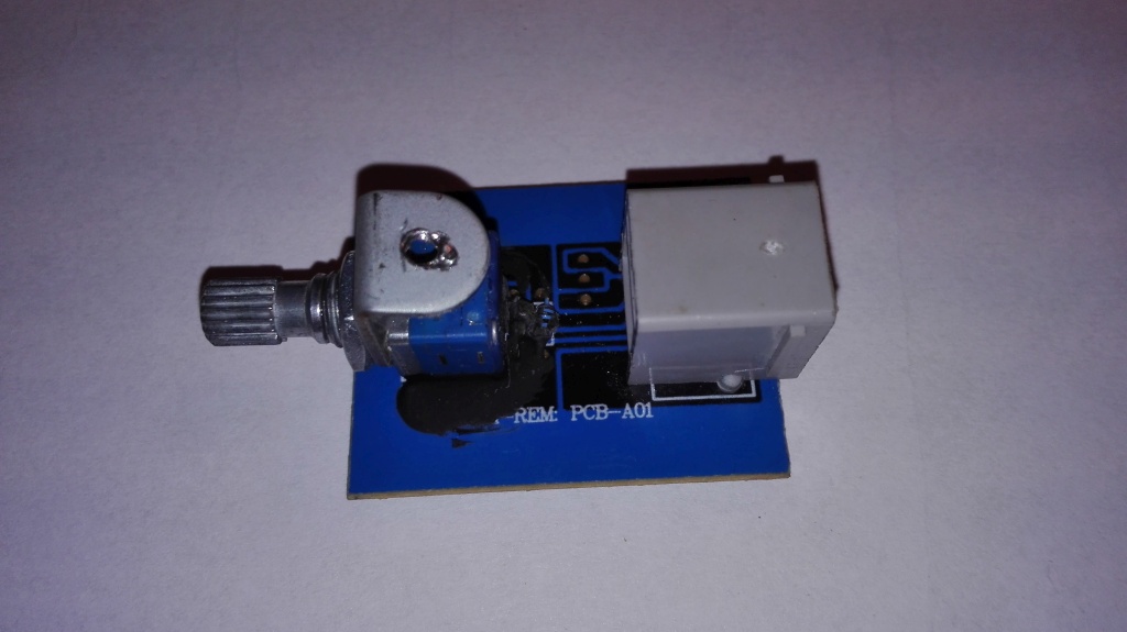

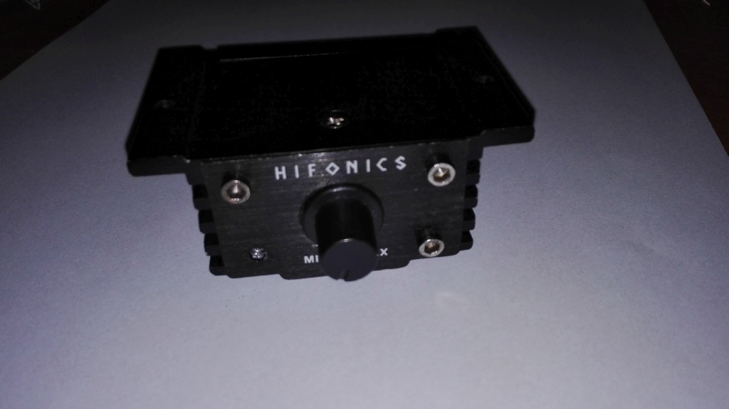

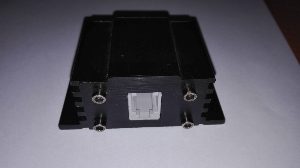

And i have remote bass knob (and cable) from Hifonics ZXI 9000.
When i connected this remote, sound is quiter than without.
Anyone know what i should change in my remote to get it worked with BXd?

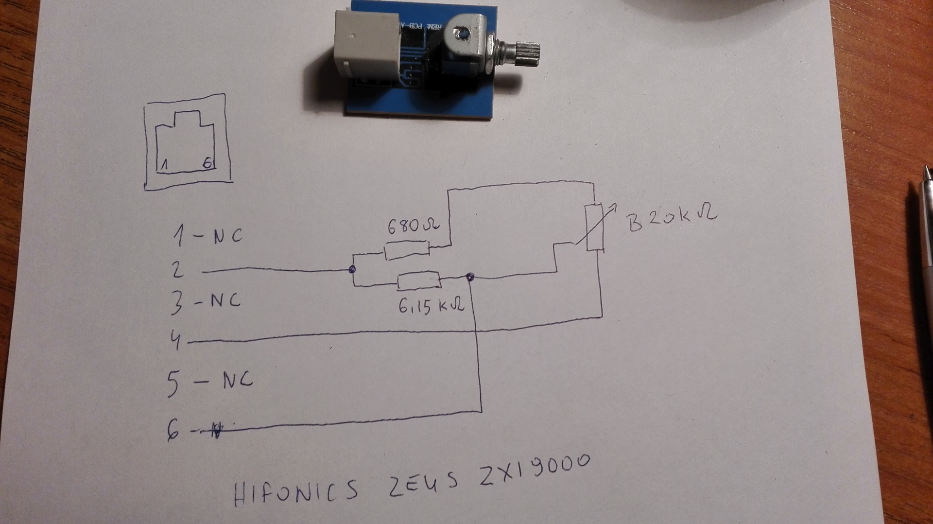

Anyone has knob schematic for BX series?
I posting photos and scheme - can be usefull if someone want to do itself for ZXI...
