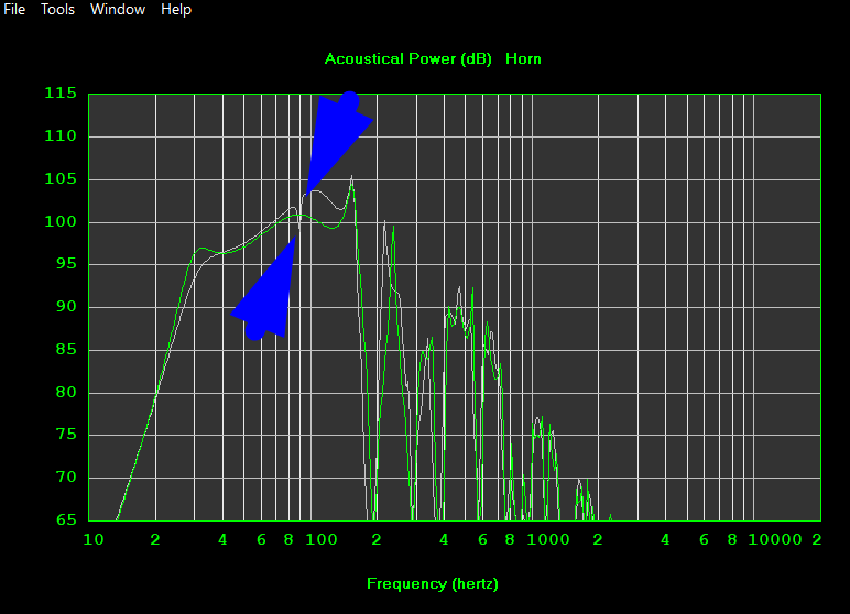

@freddi: IIRC Cubo 18 Standard is tuned to roughly 50 Hz, Extended to 40 Hz according to that Z-plot.
My sim has S1 at roughly 555 cm2 and total axial length at 86 cm. If you add a 3rd segment with 25 cm length, between the driver and the horn mouth, you can adjust for mounting the driver with the magnet in the horn/ chamber. Also TH mode in HR can make things 1 - 2 dB smoother based on the T/S-parameters.

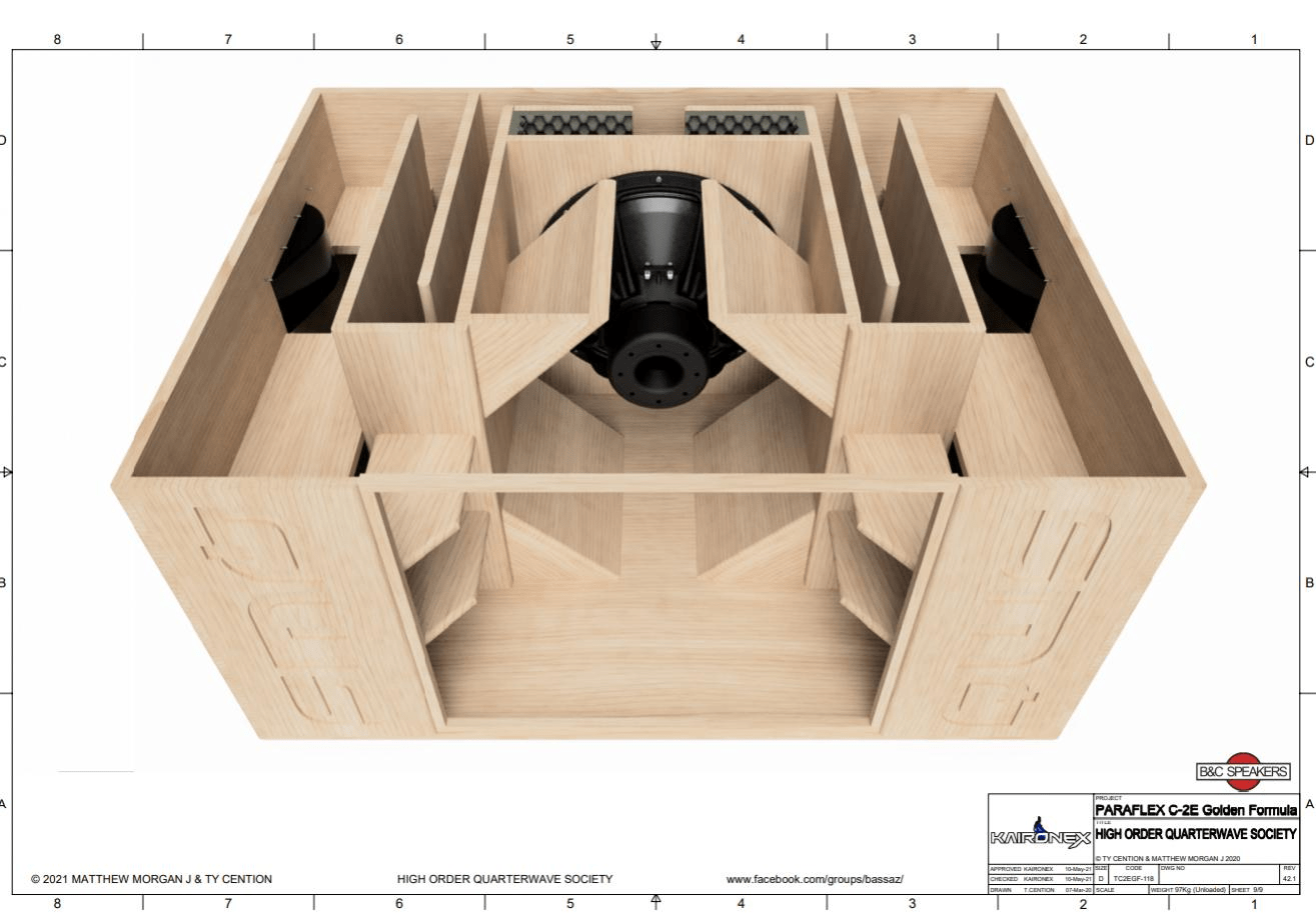

All low frequency cabinet designs "couple" when multiple radiating surfaces are combined.I know that Tapped Horns don't "couple" the way a FLH does, is there any reason to think a Paraflex design would couple?
The directivity index (DI) varies with frequency and cabinet design.
The relation of upper frequency to low frequency increase in multiples are dependent on the array configuration, driver exit orientation relative to each other and the ground plane, and the resultant DI.
Since FLH used for portable use almost always have undersized mouths, the LF increase vs upper frequency increase may be greater than TH or Paraflex.

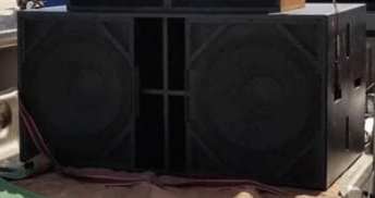

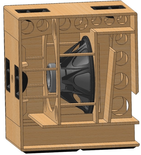

I don't have FB. When I searched "Scott Hinsons double 18," I see a FLH, not a BR enclosure. BP 4 life!for BR, I’m looking at Scott Hinsons double 18 design - https://www.facebook.com/share/p/6ngWaXTJrFypcyMu/?
https://www.sbaudience.com/index.php/application/dual-18inch-horn-subwoofer/
Skram = BP6P.
Paraflex = BP6S that acts like a BP6P due to the 2 exits being right next to each other.
Cyclops = BP6S...too much wasted space. Reflectors remove volume and lower SPL. See jbell's SS15 (BP6S) thread.
Othorn = BP6S.
Devastator = BP6P.
Othorn = BP6S.
Devastator = BP6P.
I like the single design over the double design.
The truck pic threw me off. The enclosure looks like a combination of the 2 designs. I see now it's the grills.

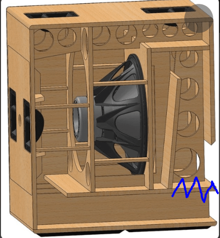

Whatever you choose to call the SKRAM, shortening it's bass reflex port would raise its Fb by a few Hz, certainly measurable, and audible if listening to music with low notes with few overtones playing around Fb.so then this is a 'paraflex'if imerge the two parallel resonators prior to exit instead? would this even be a measureable/audiblechange?
And the front "horn" would be shortened, affecting it's upper response.

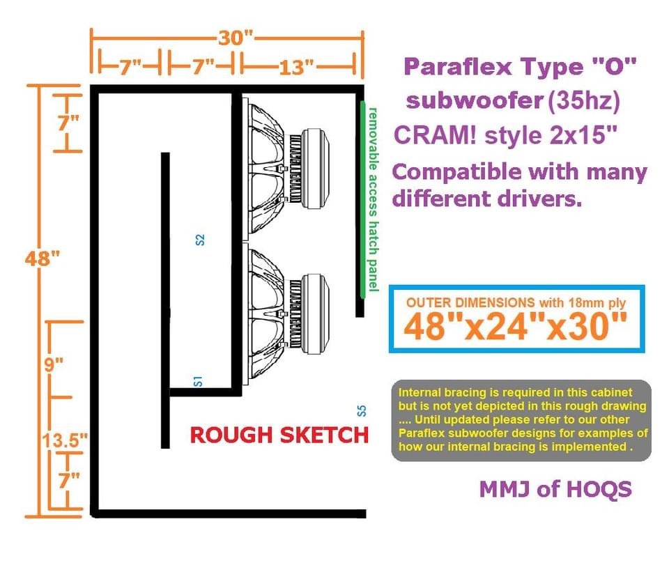

the ‘type ‘o’ paraflex doesn’t ‘merge’ like the other design posted. how does this change the result?
Correct, eliminating that blue panel changes the enclosure from a BP6P to a BP6S Paraflex.

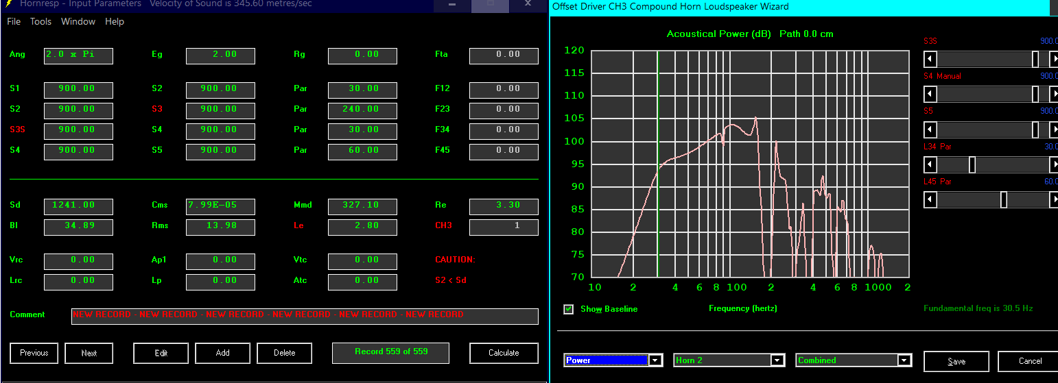

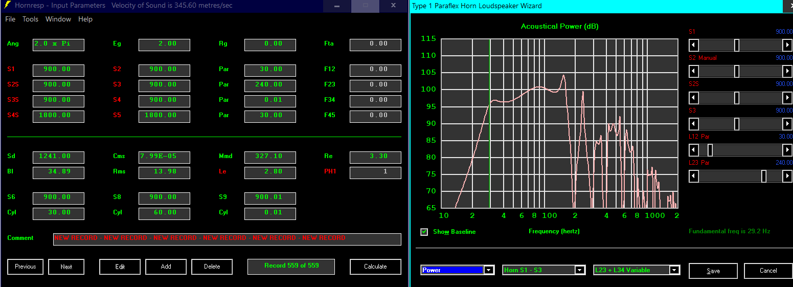

You'll have to go to the original Paraflex thread. I think 1 of the measurements lined up with a BP6P model instead of a BP6S model. After that, I want to say that's when DMB added the PH function(s) to HR.

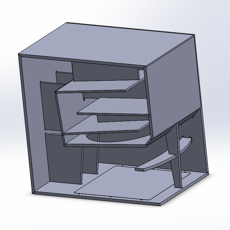

2. TH's are so much easier to model and build. Remember, the simplest TH uses 7 pieces of wood just like a BR enclosure.
Let me retract that statement. You can do a 7 piece Paraflex too. The mouth switches to the opposite end of the enclosure.

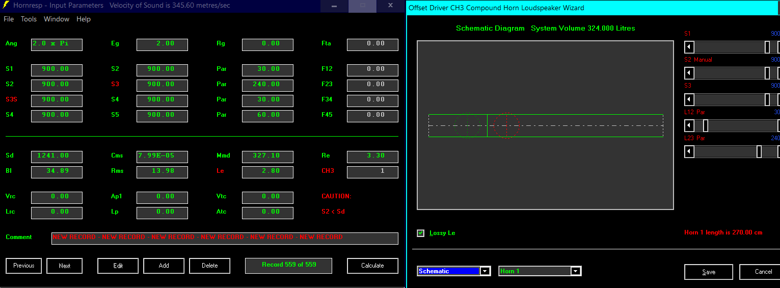

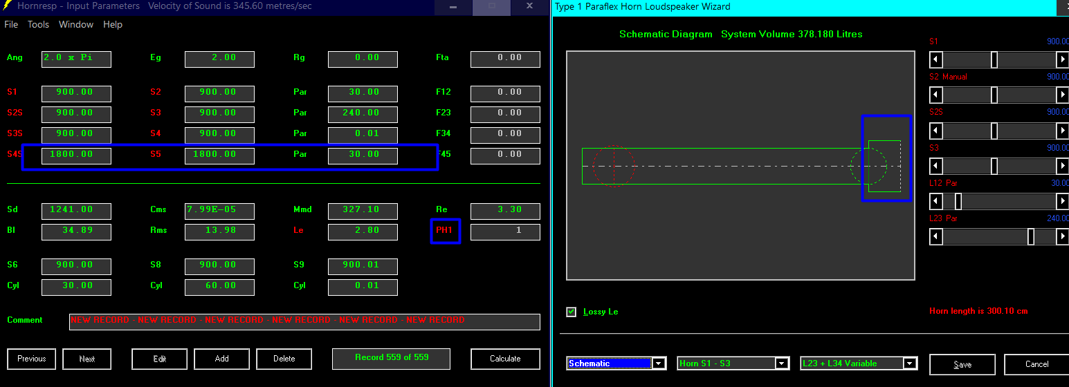

With the BP6 series function, can you change the position of the 2 mouths like the driver's position?
I'm thinking a straight flare PH might model the same as the CH or BP6 parallel functions in HR.

ill sim either in ch mode or PH mode and looksee

the little phase discontinuity in nontapped parallel qw pipes (seperated at the 3:1 odd harmonic interval) is unique? It doesn’t actually exist, but is just as tricky as offsetting a driver(1/3) in a standard qw pipe to encourage the same resonator lengths to overlapp without a hiccup ?
I really boogered this area up badly in some of my wooden(real) ‘paraflex’ designs with short wide high tuned resonators that didn’t compliment the low tuned section.
Yeah, path @ zero in ‘CH‘ and 0.1 cm (L45) in ‘PH’ are the same thing(as wood). The maths are slightly different so you get a little tiny skid mark at 3 x Fb of the low tuned section in ‘CH’ regardless I guess?
but it’s indicative of an issue that gets worse the further those resonators aren’t @ 3:1 . Mine would show up in the impedance measurent and phase was goobered in that area and everything sounded ‘weird’
