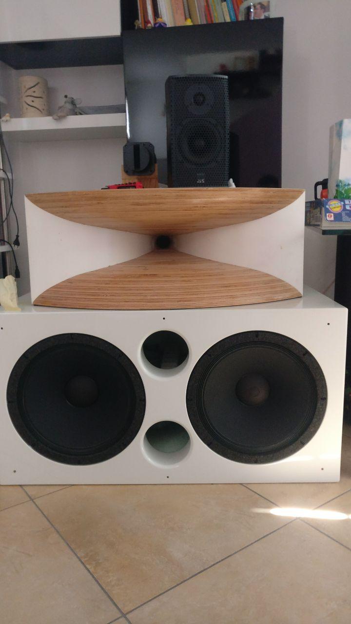

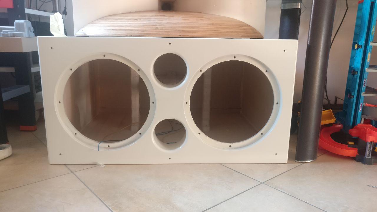

The box is about 350L and has 2 woofers.

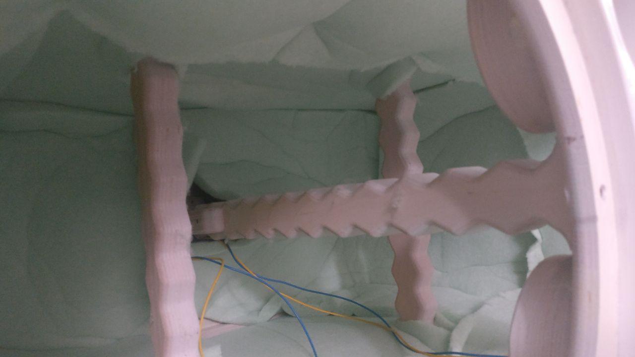

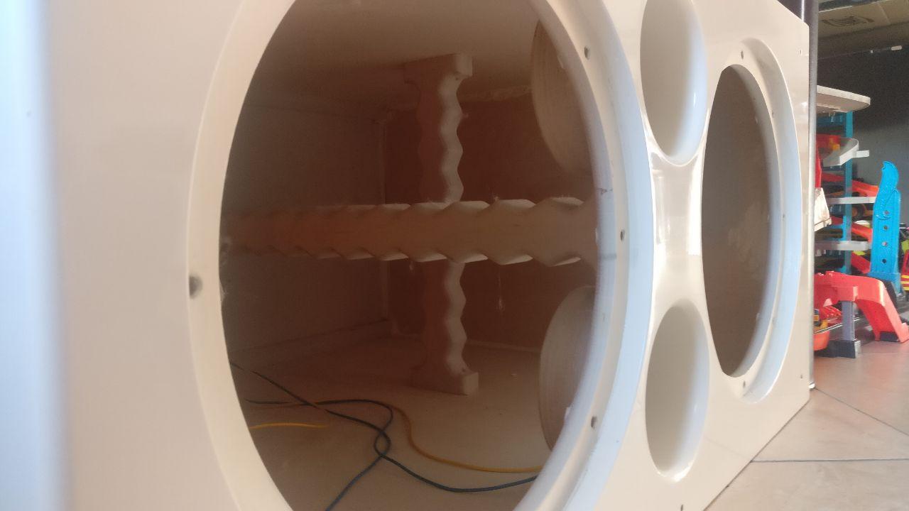

I attach some photos to show you the construction.

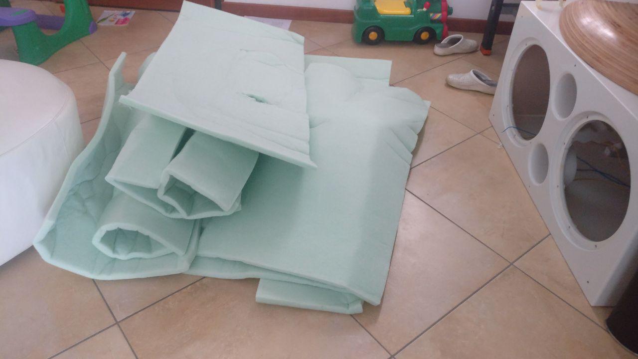

-take out ALL of the fiber.
Then listen again and take another Impedance measurement.

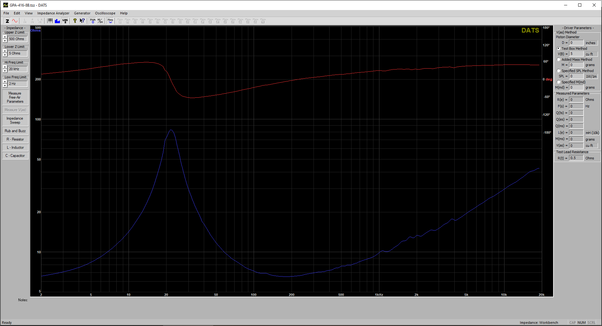

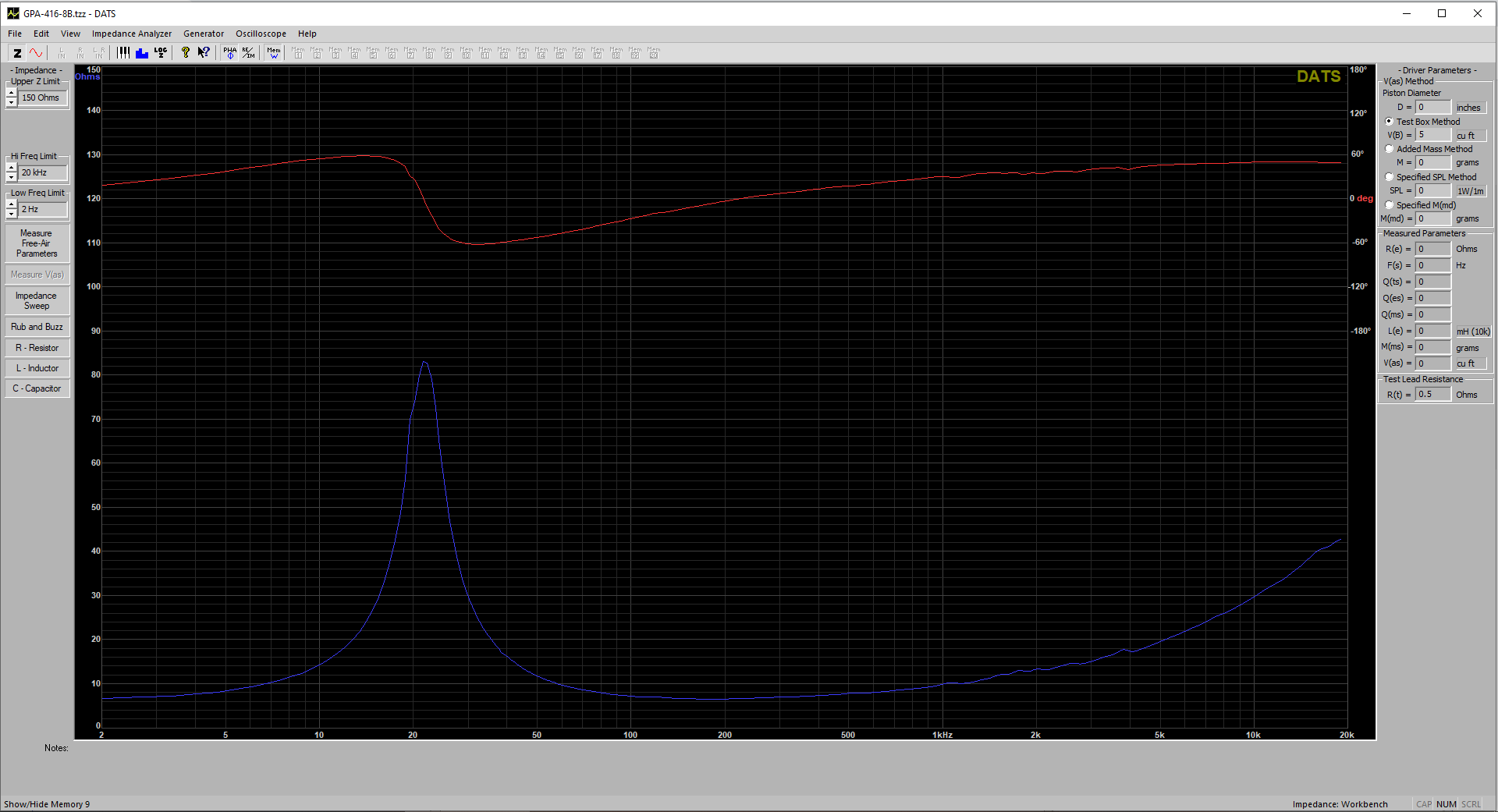

I removed all the internal fiber (what a sweat I did!); attached you can see the log and linear impedance curve.
As soon as I can I will try to listen again but now I don't like that peak around 250hz.
Thanks everyone for the help

How did it sound without the stuffing? (..the impedance is closer to what I'd expect without it, but still less in magnitude.)
Yes, the 250 Hz "bump" in impedance is worrying. With this design I'd be hanging (off of all interior surfaces) a 4 inch "sheet" of rockwool (mineral wool insulation) at about 3/4's of the way into the interior (from the drivers). The sheet at almost the same size of the rear cabinet panel. I'd also be thinking about a diagonal (relative to the side-panels) sheet of rockwool. (..and yes, I realize that it's more difficult to do so with the bracing.)
The foam you had wasn't particularly good for anything.

With regard to the impedance "bump" at about 250 Hz.
It's the driver. GPA's other drivers display similar problems (..the 12" 414 has it around 160 Hz), and yes it does generate higher levels of non-linear distortion.
Still, that shouldn't be a problem resulting in the subjective quality he's having problems with (..as others who have similar drivers would have noted).

Loose sheets of mineral wools (or other flexible absorption materials) are prone to nonlinear behavior. The sheets will resonate themselves at certain frequencies. Locating the stuff in the center of the enclosure is a good suggestion, but it has to be braced.With this design I'd be hanging (off of all interior surfaces) a 4 inch "sheet" of rockwool (mineral wool insulation) at about 3/4's of the way into the interior (from the drivers).
..and yet it works well in this capacity.
It does not have to be *braced, a very basic "tie-down" (like 4 corners) suspending the "sheet" (..more of a panel really) does the job well. I should note that I've done this sort of suspension before with a very open-weave thin fiber poly net (..cheap fish net).
It will generate turbulence, but that turbulence interferes very little with the driver's motion because it's not well coupled to the driver (..not being on-wall).
It does need to be off of the walls though, or you start into mechanical motion losses of the driver. (..in this respect the sheet should be about 4" less than the interior of the rear panel on all sides: in total 8" less horizontally and 8" less vertically at a minimum.)
4 inch rockwool has decent absorption down to below 200 Hz (almost 150 Hz).
*moreover, frame or "window-pane" bracing common to supporting a rockwool panel creates turbulence that does interfere with the motion of the driver.

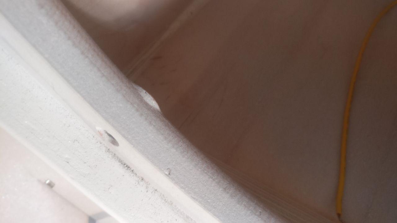

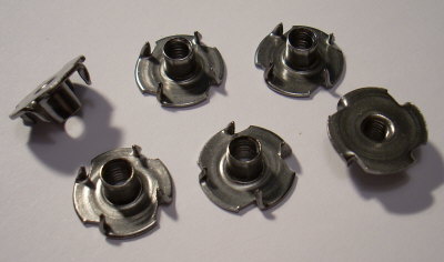

I would tend to exclude the problem about the mechanical solidity between the front panel and the woofer, or the sealing between the woofer and the panel.
The woofer seat is obtained with a CNC machine and is "perfectly" planar.
Each bolt is inserted into the wood with a kind of "spider" that couples the bolt to the wood itself.
I attach a photo hoping it will be a little clearer.

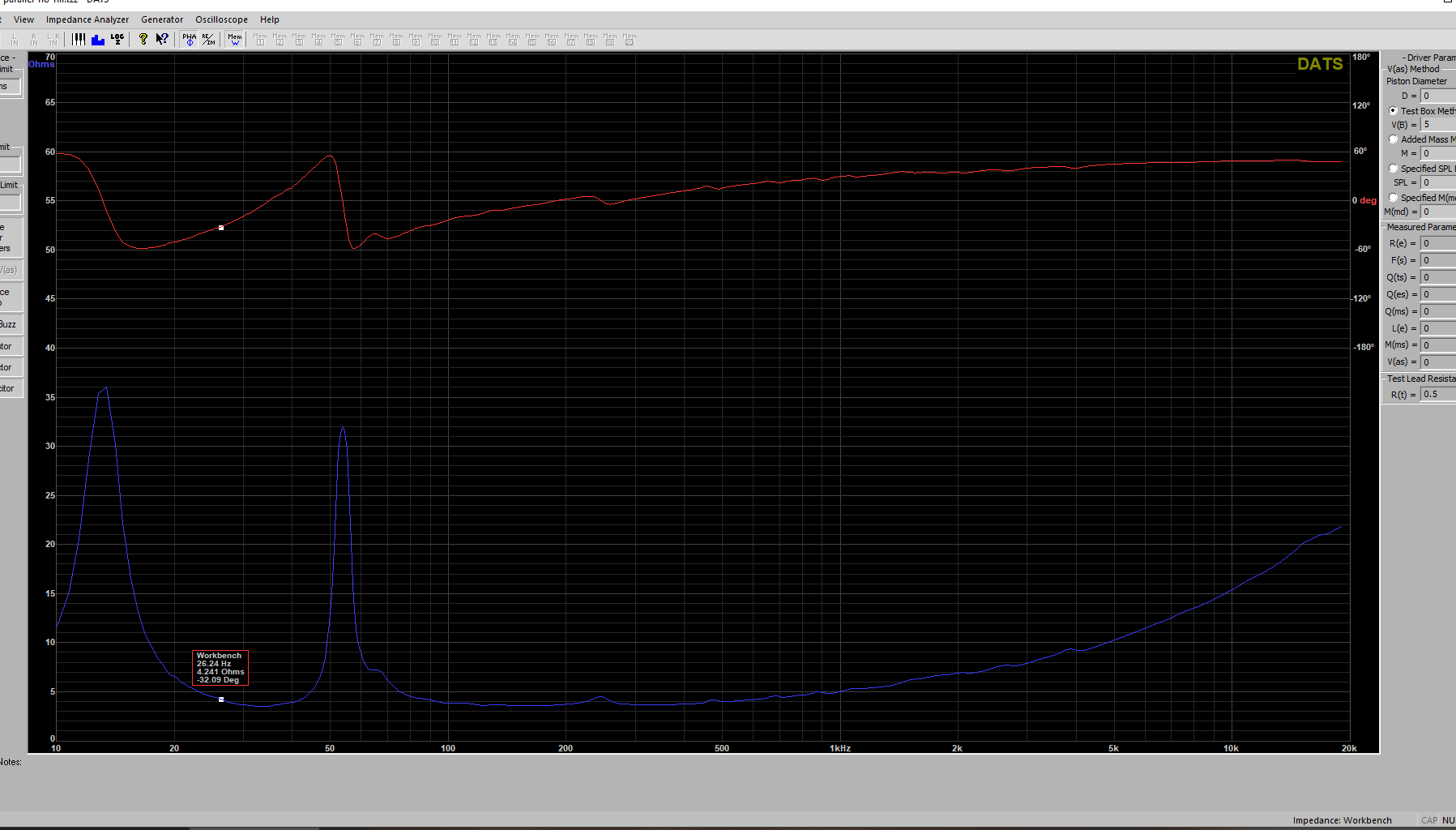

ScottG wrote that it could be the woofer itself that manifested that peak around 250hz, I tried to take a measurement of its impedance (free air) but I don't see peaks around that frequency.
Ah I also tried to take an impedance measurement with the two woofers in series, but the trend of the curve does not seem very different (clearly they are now 16 ohms nominal).
Attached are the graphics of the woofer and the curves of the woofers in the cabinet connected in series.

1st driver is really clean, 2nd has a very minor "bump" around 130 Hz.
The 414 (which is why I thought it would have been the driver's):
Yeah, it looks good. I'd make sure that I caulked a seal around it for final installation though.
Note though that it COULD be the baffle itself.
That panel is large and there is a lot of stress/vibration put on it with the two drivers (..and the ports).
Sorry I did not specify that the two measures were referred to the same woofer.1st driver is really clean, 2nd has a very minor "bump" around 130 Hz.
The second was in log scale.

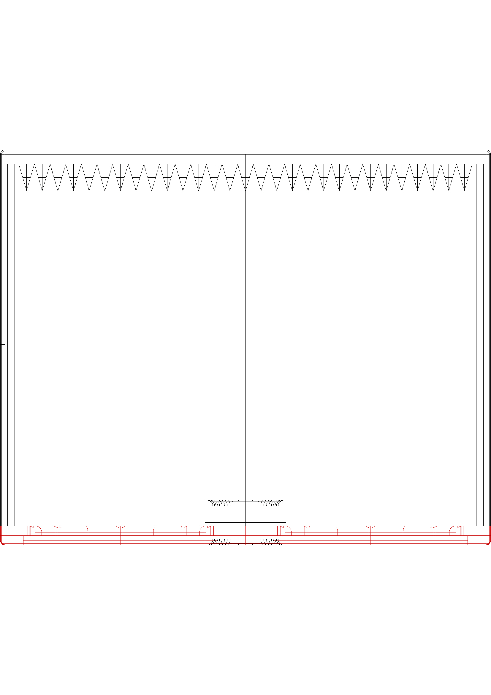

Attached is a drawing of a hypothesis on the rear side of the box (pyramidal geometric shape).
Might it make sense to give it a try? (for me it would be the easiest one to make)
Could it make sense to do it on the sides of the box (left and right) instead of the back side?
If it doesn't make too much sense, I would immediately try the solution with rockwool panels (positioned in the way you explained to me).
