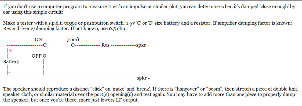

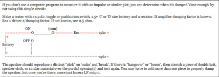

IME only from a construction POV as critically damping a vent yields ~the same or better GD than sealed, so your call.
Reactions: camplo
Cool, I’ll look into damping a port. Traditionally I’ve come to the belief that damping a port tube to quell some undesired behavior generally leads to diminished port spl as the tradeoff. Many of my perceived problems with ports have heavily biased me towards the passive radiator.
True, though the pioneer's way minimizes it versus moving towards ~aperiodic, i.e. heavy damping the box and/or the time honored 'sticking a sock in it' (vent).
Don't see a way ATM for me make an overlay of a Hornresp (HR) sim of GD for 'critically damped' BR (CDBR) Vs PR, but looks like the PR is a little lower till near tuning where the BR rather ~abruptly 'flatlines' and the PR shoots up another 2-3 ms before inverting, so leaves me satisfied that to my hearing, etc., comparison (no measurements beyond SPL matched) of my dual 15", ~14 Hz (CDBR) Vs my long gone dual 15" ~14 Hz Servo-Drive PR subs were 'six of one, half dozen of the other' when it came to SQ BW limited to 120 Hz/2nd.
