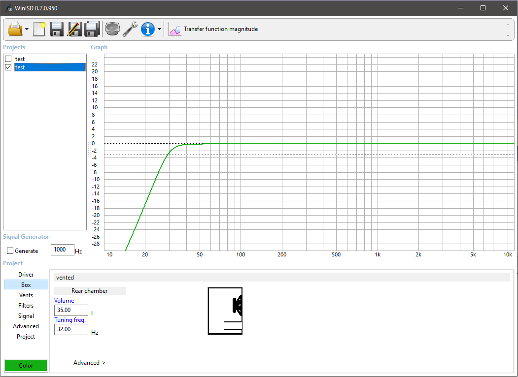

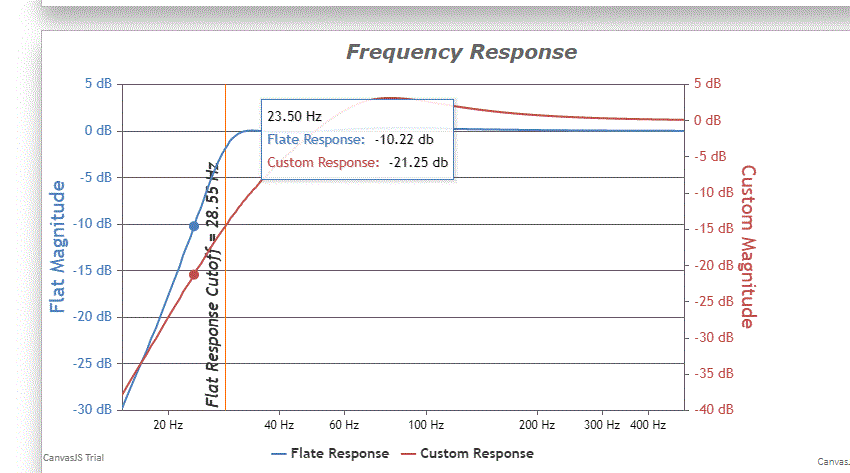

never trust those online calculators but use proven software like WinISD, Hornrsp, VirtuixCad, ... (actually, those three are the highest rated freeware ones down here)
Most of those online calculators are very basic and not precise at all. I don't know the one you use, but in general they can't be trusted. I used WinISD for this, and checked it in VirtuixCad with the same result as i'm using one of those in one of my own designs. I may publish the design when i've build it, but it's in ready to order the wood-phase.
And this driver was used in a smaller case (14L) by Jeff Bagsby (a very famous speaker designer) in his tango kits tuned flat until 55Hz (-2dB) and 40Hz F3. The tweeter is the now unavailble Dayton RS28A tweeter. No way you need 135L to get a flat response with the RS180-4. It's that speaker, that a friend have and i know, that inspired me to make a variation with a different tweeter (the SB26ADC).

@ waxx Ok I thank you very much .35 liters is the max volume for this driver SP90 ?

No, the sp90 does not work for what you want. It’s a lowmid driver, not fit for bass. The 35l is for the dayton. And that visaton is also ok for bass, but not to pair with a tweeter i think. Then you will need a mid driver in between

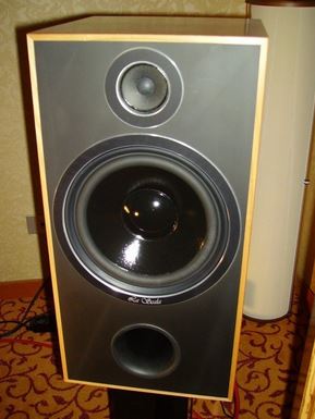

We have built a few speakers with the Visaton W200S-8 and the TW70 cone tweeter:
W 200 S - 8 Ohm | Visaton
Latest Project With Thanks To system7
