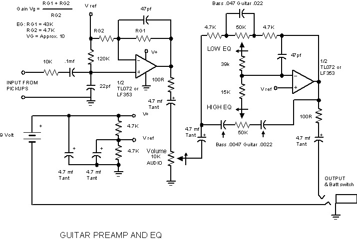

Here's a simple preamp with 2 band EQ which works great for bass or guitar (change the EQ points). The gain can be set to drive a power amp just fine.
DolbyR said:
I am thinking about building this preamp cable http://www.till.com/articles/PreampCable/index.html for my bass...but is the 3db gain too low?
I'm usually connecting the bass to my PC but the signal is a bit on the low side, so would this preamp cable be enough or should i just go for Albert Kreutzers JFET preamp?
The JFET version would give you full controls, just like a poper preamp, if all you want is some extra gain just use a simple opamp to give you the gain you require.
The PreampCable isn't really designed to give 'gain' as such, just to help prevent possible losses in the cable.

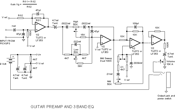

Need Help...
I have a RBX 360 Yamaha bass with a passive tone control featuring volume, pan and tone. I recently modify the circuit by an active one I built myself. The circuit features a mosfet (2sk30) in the first stage followed by a 3 band EQ. I also replaced the original pick-ups by active Basslines Seymour Duncan. The result is enough good with a neat and clean sound probably because of the high input impedance of the mosfet and a little hiss on full treble boost. The only black spot is the low output may be half the value of a strong passive single coil pick-up. The pan control is 20 kilo ohms (ganged) followed by a high value 500 kilo ohms for volume. May be the output from the active pick-ups is too low...
Can someone help me please or send me an active circuit shematic bass, mid and treble with enough output but with no mid sweep.
Thank you in advance.
