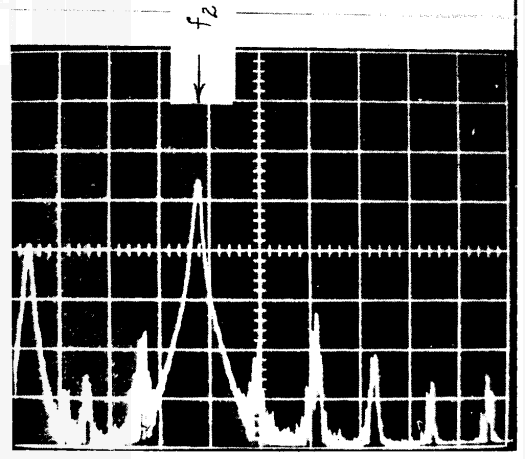

Right now, I will just give you a graph of an 8 inch speaker, playing two tones at 90 dB. The first tone is 50 Hz, and is so low in frequency that it is not on the chart. The second tone is 300 Hz, and is clearly marked with F2. The vertical divisions are 50 Hz, the horizontal ones 10 dB. Look at the interference. Remember, this is from an 8 inch speaker-which needs to move less than a 6 1/2" speaker-played at a comparatively soft level. In a perfect world, the only tone that should show on the graph is F2 at 300 Hz. The others are all distortion tones.
The louder the level, the worse the situation becomes. Ported boxes offers an improvement over sealed box in this regard. Nevertheless, the phenomenon exists in the ported box as well.

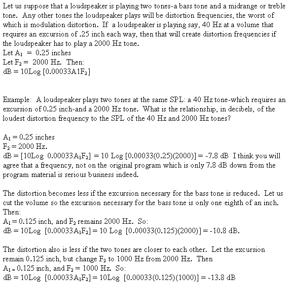

Here is the formula and examples. I will probably be devoting a whole thread to this soon.
All of this information is taken from Paul Klipsch’s two articles in the Journal of the Audio Engineering Society. The articles are: Modulation Distortion In Loudspeakers, Part I in the JAES, April 1969, and Part II in February 1970.

Good idea. The less the cone must move to produce bass, the clearer will be the midrange and higher.
For some reason, modulation distortion does not get much discussion in audio circles, but I think it is a major determinant of sound quality. I think such things as crossover slope, etc, get much more discussion, but here you see foreign tones being introduced into the program material at amplitudes not far behind the music you want to hear, and nobody talks about it.
