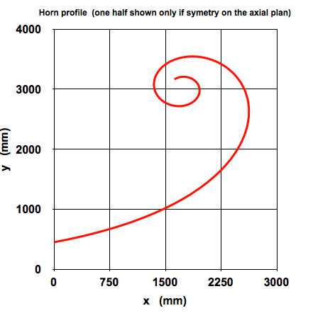

Jmmlc said:Hello,
The horn is calculated using the version of my Excel spreadsheet devoted to the calculation of horns delivering quasi cylindrical wavefronts.
http://ndaviden.club.fr/outils/cylind.zip
In the case of that given horn, a lateral wall of the listening room is used as symetry plane.
The geometry of the common curved part between the 2 horn is explained on the graph at:
http://www.revue-audiophile.fr/index.php?q=node/21
few informations in French about the building:
http://www.revue-audiophile.fr/index.php?q=node/15
Best regards from Paris, France
Jean-Michel Le Cléac'h
i don't speak french, so is there an english version of these links?
it would be nice to have a sketch or drawing showing the horn implementation (that's underneath the raised floor).
thanks.

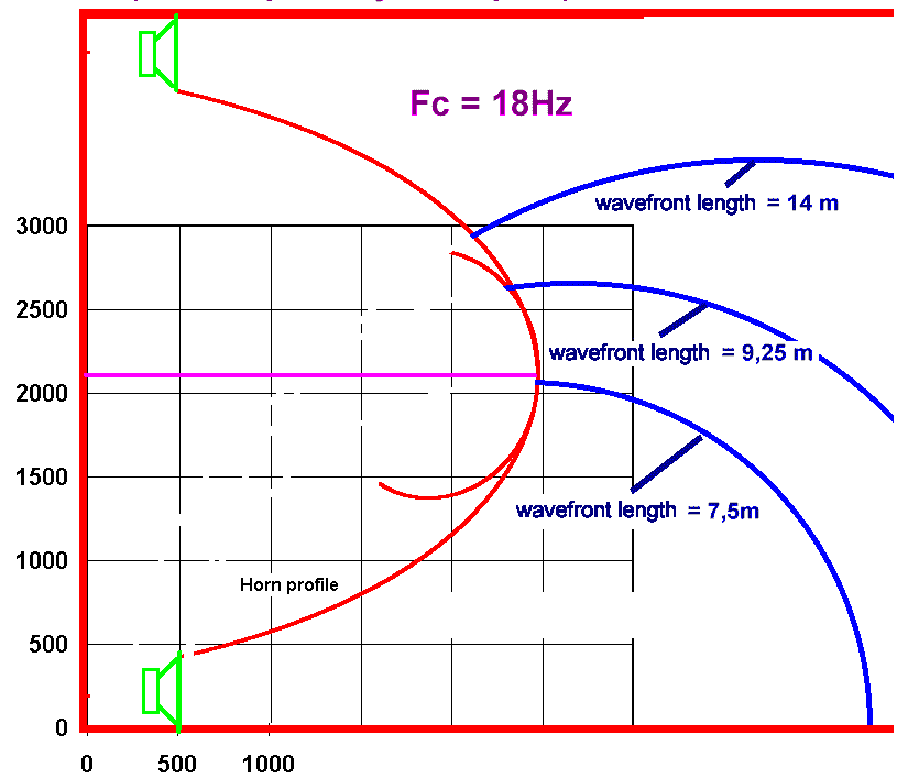

Re: Re: Re: Re: Re: Re: Re: Bass horn driver?
Hello,
You'll find in attached file a schematic horizontal cross section of the bass horn.
Hello,

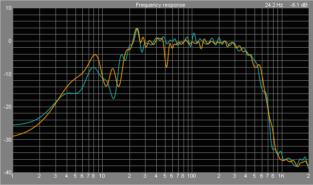

Hello,
Here you'll find reponse curves obtained by Frédéric Lebas (with equalization)
Hello,

Re: Re: Re: Re: Re: Re: Re: Re: Bass horn driver?
totally cool and strong response, almost as low as the TH.
are the drivers mounted parallel, series, separate amps, push-pull, etc.?
and are the drivers mounted in separate enclosures connected to an acoustic shell, etc.?
thanks.

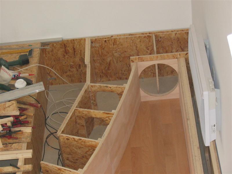

Re: Re: Re: Re: Re: Re: Re: Re: Re: Bass horn driver?
Hello,
Each one of the 2 channels use an Altec 515.
The rear volume (closed enclosure) for the Altec 515 was optimzed using Hornresp (specially a reduction of phase in the range 30Hz-100Hz was looked for).
Here is a picture of the building of the rear volume.
Hello,

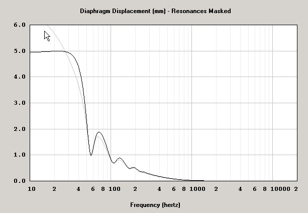

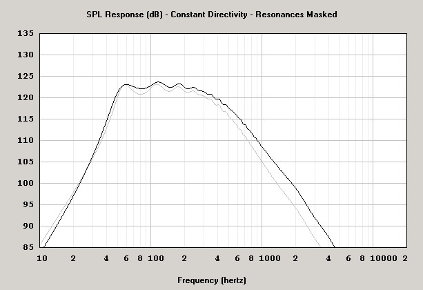

Oh dear, looks like my "modest" RT-2 horn has been overtaken by some serious French project! 😀
Anyway, very interesting reading although it is well beyond my scope of ambition, not to mention living-room space! 🙂
Interesting to hear your recollections of your experience with these horns Peter!
The "mule kick" sounds most encouraging, but lack of low bass perhaps a bit disappointing again...
Anyway, the woofer is ordered and the MDF has been cut, so I can only hope for the best now!
Ah, speaking of which, back to the original topic.. The driver i finally settled for was the Eminence Delta-pro 12.
In the simulations I did, it showed less ripple and slightly better low frequency extension than the Kappa with comparable efficiency. It also seemed to be a perfect match to the closed rear chamber with the cone excursion rolling off and flattening out at 30 Hz, still well below maximum driver excursion.
I'll try and do some photo's during the build process and see if i can post them under a new thread in due time!
Enclosed is the response of the Delta-pro sim compared to the Kappa-pro in grey..

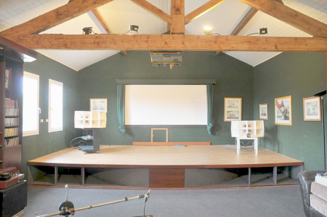

Hello,
here is another basshorn just finished to built here in France:
http://img383.imageshack.us/my.php?image=dsc30511280x768ac0.jpg
the frequency response is here
http://img383.imageshack.us/my.php?image=dsc30371280x768ky8.jpg

The Gamma driver has a -10 dB at 55 Hz and in a domestic setting the far lower maximal sound level hardly matters.
Black trace is Beyma G320 a classical horn driver enormous magnet system giving a Q bellow 0.25 and the Fr is about 60 Hz.
The red trace is an Eminence OEM version with Q of 0.5 and Fr of 50 Hz
The bottom trace is Gamma LA1232 a vintage drivers for very large closed boxes. Vas is 300 liters Fr 25-30 Hz and Q about 0.4. The funny thing is that it despite a mass roll off at 150 Hz or so keeps up to 1 kHz!
In PA the +10 dB sensistivity and higher powerhandling of the Beyma makes it a very good driver. -10 dB is at 90 Hz compared to the output between 200-1000 Hz.
