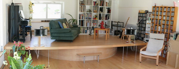

Hello,
There is often a solution for bass horn that is still WAF.
In the attached picture you'll see the (Le Cléac'h) bass horn built by my friend Frédéric Lebas.
Best regards from Paris, France
Jean-Michel Le Cléac'h

What horn,
Well, that's a valid question to start with..
This is a front-loaded wall-horn where the body of the horn is actually standing on four legs, using the rear-wall and floor as part of the horn.
The theory is that the opening formed between the horn body and the floor acts as the horn mouth. Further to this, the horn is based around the theory that the relatively narrow horn mouth will have its effective area doubled by floor reflection.

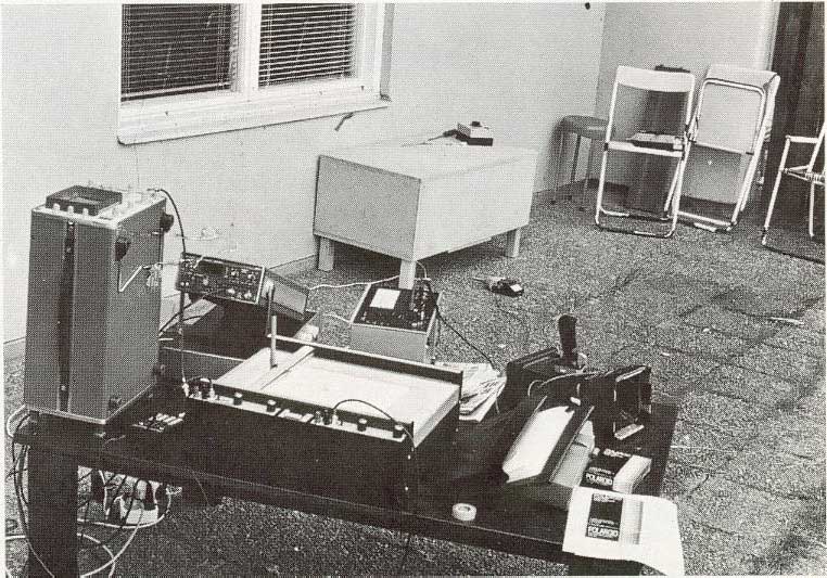

This horn was originally designed and published by "radio & television" in 1973, known as the "RT-1" horn. This horn was designed for 10" woofers.
In 1978, the horn was re-launched in two new versions intended for 12" drivers; "RT-2" with approximately the same size and cut-off as the original RT-1 horn, and a slightly smaller horn, RT-3.
On the enclosed image, the smaller RT-3 horn can be seen.
It is the larger RT-2 I am most interested in.
The horn is cited as being capable of 30 HZ, and some measurements show a roll-off starting at around 45 Hz. These measurements were however taken at the horn mouth, thereby not giving the benefit of any room assistance.
Wether or not introducing a bass-horn in the form of a plateau in the living-room is wife-friendly, may of course be subject to debate, but what i like about the RT-horns is that they are fairly large horns which lends them selves rather nicely towards blending in with furniture.
It would make for a great TV table provided the vibrations are not to severe.
