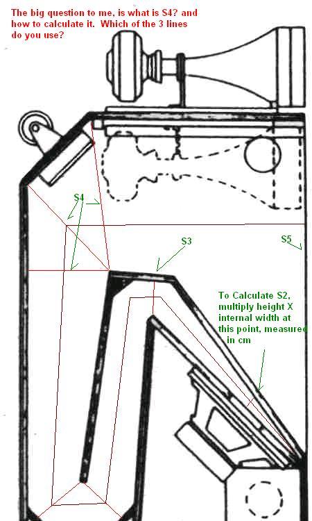

You did a standard front loaded horn, where the driver starts at the beginning of the flare. I did an 'offset driver' horn, where the driver enters along the path somewhere. Yes your caveman drawing represents the flares that I was referring to. In an offset driver horn the first flare defines the distance from the start of the horn to the center of the driver.
There is more than one way sometimes to sim a cabinet, some better than others -- as oliver alluded to. Hornresp assumes a flat piston driver, not a cone, and as such, olivers suggestion on how to define the compression (small opening driver fires through) would be correct.
A better way may be to do offset driver, use black as is for first, do the first short blue line as the 2nd path, then the vertical blue and yellow as the 3rd, then brown for 4th.
glad to see your taking to hornresp -- it's a great tool.

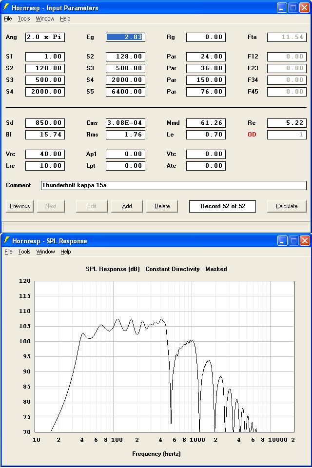

I played around with this a little bit more, and I think this is getting closer to the actual cabinet. The one thing I did is reduce the rear chamber size down to 40liters. Reducing the rear chamber size really smoothed out the bottom end. You can add solid styrofoam blocks to reduce the chamber size, works great.
If you steeply high pass at 40hz, you can almost put 100watts into the kappa 15a and stay within it's 4.0mm xmax. That's pretty impressive for this driver. A 3015lf gives almost identical response, but allows up to 500watts input.
I have to say... I'm pretty impressed with this 1975 horn. With a multicell on top crossed at 500hz, I believe it really is all it claimed to be... full range from 40-15000. While I think 108db is stretching it a bit, 105 is very doable with this cabinet.

Im using the figures that you created Jbell for my S1-S5, although i would rather calculate my own they will do for now :) when i press calculate i am ask if i want to mask the throat chamber and rear chamber resonances?... Do i?

Also, when measing the CON measurements, where in the flare do i measure to/from, do i measure the longest point of each triangle, or do i measure from the middle of the triangle.... cue caveman illustration....
Woo managed to attach it! So which colour is the measurement that i should take?

maybe this helps?
To measure lengths, using the 'centerline' method is probably the easiest. However as I said, figuring out the 'best' way of defining the flares into the 4 flares that hornresp gives you is a challenge some times.

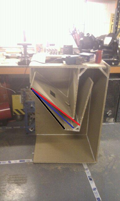

Sorry about the lack of replies over the past 2 days, left my laptop charger at our workshop and ive been onsite so not had chance to get it!
Il do some research into the phase corrective throat TB, i have a feeling it may be 2 baffles (not sure if thats teh correct terminology) that i actually missed out of the marque 1 haha) they are two angled pieces of wood that go into the 1st flare from the beginning of the horn to the start of the second flare that create a V shape.
An illustration would help, ill put on one later, just going to try and do some measuring out for the next box so i can enter the data into Hornresp later
Throat dimensions

I'm looking forward to see the dimensions of the horn throat. It makes quite a difference in Hornresp, especially in the way the impulse response looks. Also, what is the size of the rectangular opening into the horn?

Problems with the box are that at certain frequencies it has a very high SPL, yet at a 10Hz difference it sounds pretty dead, also the box seems to have one tone?
After speaking to a guy who i know has built a few of these boxes he found that the bigger the aperture for the driver (does this hole actually have a specific name, i just keep calling it the driver aperture), anyway, i digress, the bigger the aperture the higher the box went without affecting low end? But i also assume that this means the internal pressure of the box would also drop?
Unfortunately i don't know enough about speakers to understand what any of that means haha. Here is my Hornresp report so far, i didnt note what i was getting SPL peaks and troughs at but 50hz was definitely the loudest frequency, 60hz was very quiet, 82?Hz was loud again, followed by a quiet patch up to 90something which was loud again.

My Hornresp simulations do not show a peak @ 50hz, but there are a number of peaks and valleys starting @ about 60Hz. I assume you have tried to look for all the ususal suspects: air leaks in the horn path, rear chamber, driver mounting, room modes? Ideally you should measure outside, but that may be a tad cold right now, anyway measure the relative response right at the mouth, and don't rely only on what you can hear.
The reason I asked for the throat geometry before is that it makes a difference in the model. If the horn throat starts as shown in the drawing you have an offset horn with the driver entering @ S2. If the horn starts with two slanted boards right next to the throat chamber opening (aperture sounds fine to me), and a sideways board also at the opening, you could model it as a offset horn with a very short L12 (distance from sideways board to middle of horn chamber opening), with the cross-section @ the sidways board being S1 and @ the middle of the chamber opening being S2. Or, you model in Nd as a front loaded horn (FLH) using the opening as S1 and the cross-section of the horn right after the throat (opening/aperture) as S2. S3/S4/S5 all stay the same.
If you model it both ways, you'll see the difference.

back toward the beginning of this thread, when I first posted a guesstimate hornresp of this cabinet, you saw a huge one note peak. (which sounds like what you are seeing)
One of the things I have done in hornresp to tame that peak and level out the response is to reduce the size of the rear chamber.
Just add solid blocks of rigid foam to bring down the rear chamber 'air' volume to about 40 liters.
