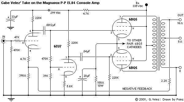

I've been thinking SY's Red Light District amp (search here) could be a cracker though I'd experiment with cathode bias as well and maybe trioding the EL84's.brsanko said:any suggestions for the amp
For a preamp, copy something you like, maybe a couple of different designs as it's very cheap to make it 3 or 4 channels once you have the PSU, case and output iron. A few more tubes and passives don't add much.
Otherwise, I'm quite fond of this cct, with some mods (6EU7 is a 12AX7 with different pinout)
The Red Light is in here (4.5M .pdf)

not quite ready to tackle building my own amp quite yet(though it is a dream of mine). I think for now I'm going to build the guitar (vintage 30 with open back) and bass speaker cabs and buy the amps. Tubes would be great but I am on a rather limited budget. I hope to do both guitar and bass speakers and amps for about $500 is this possible or reasonable?
I could build it all for that. A small tube amp isn't that expensive. The ones I suggested are 15W and don't need any expensive parts. Best of all, build it in a big box (like a head) and you can use the same poweamp section, with different pre's for bass and geetar.brsanko said:not quite ready to tackle building my own amp quite yet(though it is a dream of mine). I think for now I'm going to build the guitar (vintage 30 with open back) and bass speaker cabs and buy the amps. Tubes would be great but I am on a rather limited budget. I hope to do both guitar and bass speakers and amps for about $500 is this possible or reasonable?
However, as you're time and budget limited, buy the amps and drivers secondhand; pick the amp well and you'll be able to resell later for little loss. Maybe a small (tube) combo guitar amp you like the sound of, with a clean channel too, and a build a bass cab: use the amp for both Would be the cheapest and simplest option I guess. But I don't buy guitar amps (I build guitar and harp amps), and am in Australia, so no real clue re secondhand prices. I must admit, I have a weakness for Peavey gear.
When you get the guitar amp, try it as is with bass at sensible levels and see how you like it. You might be surprised, esp when mixed with a DI signal. You don't need to close mic it either, sometimes further out into the room will give a lot of warmth and natural (sort of) reverb.
