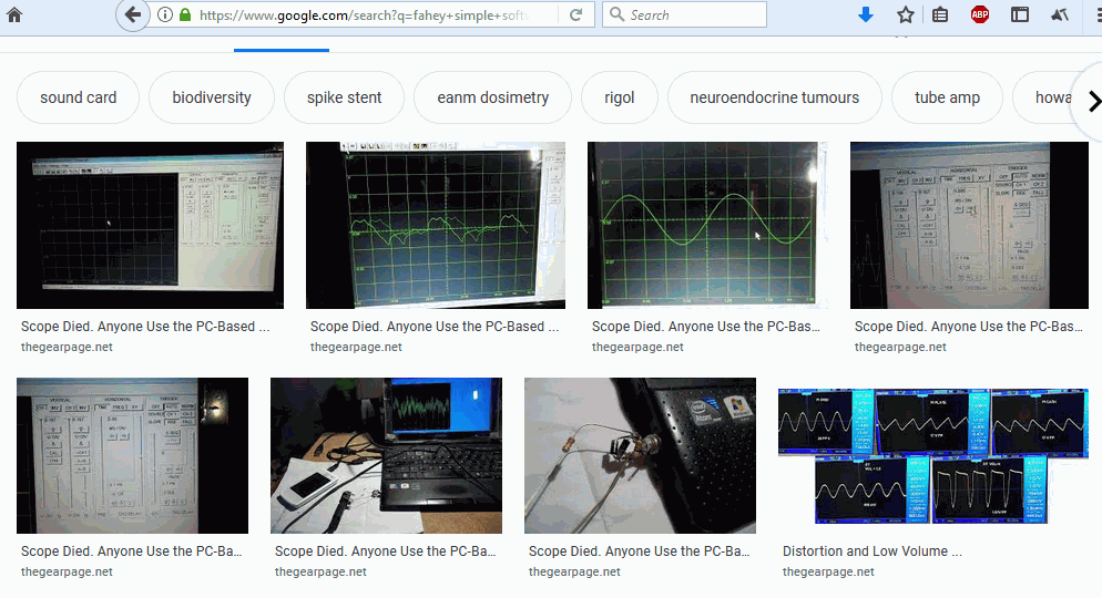

If you have a notebook with a microphone input available, you can use it as a very useful hobby scope, by installing Scope freeware and building a *simple* attenuator (2 resistors, 2 diodes and 1 capacitor)
I published it in The Gear Page.
Sadly for some unknown reason my ISP was banned there so I can´t get in, but if you wish feel free to read and follow it:
Search Results
Web results
Scope Died. Anyone Use the PC-Based Ones? | The Gear Page
Search for: "fahey simple software scope attenuator the gear page"
For the signal levels you are using I suggest 47k>1k attenuator values and add a .1 or .047uF capacitor in series to keep DC out.
sample search images:

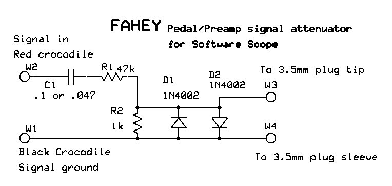

Couldn´t edit because of time limit, so here it goes:
EDIT:I think (can´t get in to check) that the attenuator schematic was lost , so just in case here it goes again, with pedal/preamp friendly values:
You make 2 probes: red and black crocodiles (and cables) to connect to preamp ground and visualized points, and attenuated output goes to a 3.5mm microphone/earphone jack into notebook Mic input.
