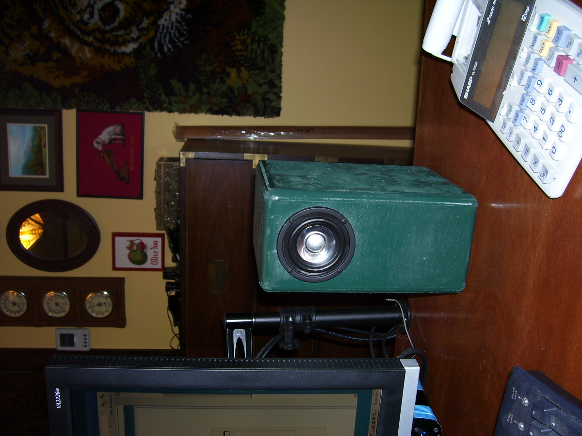

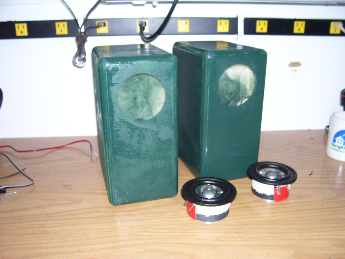

1.5 L, tuned to 90 Hz, rear port. 5 ply birch. Lightly filled with wool. .45 mH and 6.5 Ohm BSC. Three coats of goo on the dust caps and moretite on the frames. The total investment is well under $100. So for a comparison, are they better than baby Warfdales for the same investment? No. Are they better than anything sold in the office store as computer speakers? Yes.
Actually to get 100 Hz out of a 2.25 driver is quite something. A bigger box and any games that did not provide Fs control would be a disaster. Drivers don't sound very good after you smash the former into the pole piece and then rip it out the front.
The basket has some limitations as so much of it is there to reflect back. I did not recess them in this set as I am planning on a felt pad to come up flush. I did verify with duct tape the improvement in response if they were flush. It does make a sizable difference. I have not made the order to McMAster Carr yet.
Fun little project, but not a direction I have any interest in perusing further unless I want to make more attractive boxes.

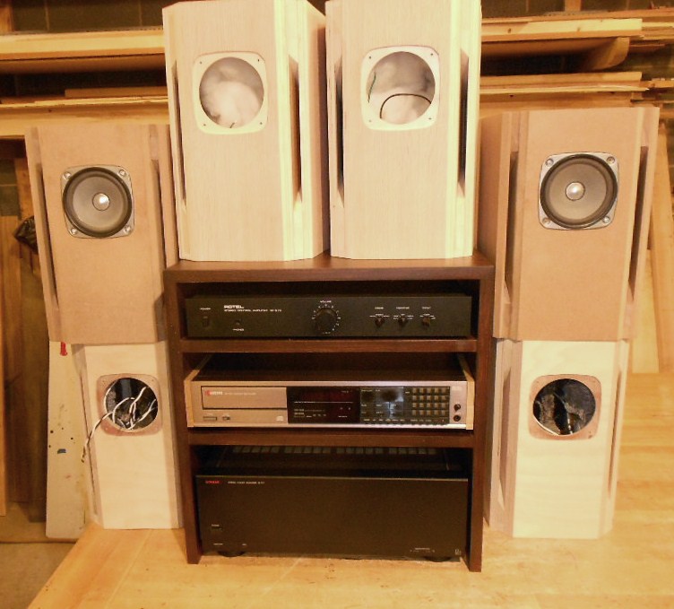

Any other feedback about LT vs vented for extended bass response for such a small driver?
LT and a sealed box is smaller. A high order alignment is bigger, but more efficient. Either case, you must not exceed the ability of the driver to move air. A 2.25 inch driver flat does not push much air. Usable 100 Hz nearfield is darn good. More expensive drivers may get to 80. Sonically, that is a big difference. To get to 60, which gives the perspective of full range just is not going to happen.
