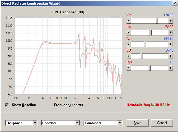

Hi Nathenry,
I generally agree with sreten's comments on tuning and filtering, it may be important, to point out, that he is referring to the box recommended in the factory data sheet, not the B&C SUB18 as recommended earlier in this thread. As to filters, it is my opinion, that a bass reflex enclosure should not be used in high power applications (i.e.: PA or block parties) without a suitable low cut (high pass) filter; when the low frequency content of the music drifts below the tuning frequency of the enclosure, the excursion of the driver will become excessive...
The 18TBX100 data sheet shows an example of a BR enclosure w/ a volume of 200 L and a tuning frequency of 34 Hz. It uses a port with an area of 339.6 cm^2 and a length of 26 cm.
The previously recommended factory B&C SUB18 (Post #9) is 183 L and tuned to 35 Hz. It uses a split slot port with an area of 541.2 cm^2 and a length of 32 cm.
I want(ed) to point out, that you can reduce the internal volume even more without any negative effects. I'll attach another Hornresp Wizard screenprint, this time I shortened the port(s) to 25.40 cm (10"). You can see the effect on the frequency response, and the tuning frequency (bottom right: Helmholtz freq is 39.53Hz). In other words, you can tune either one of these boxes high or low. I also tried to make this box as easy to build as possible.
I'll also attach a Rev. A of the drawing:

Ok more info coming in. the speakers my husband used above his bass speakers is one of Bill fitzmaurice DR's top.
183L tuned to 35Hz will work fine, not a lot in it versus 200L/34Hz.
