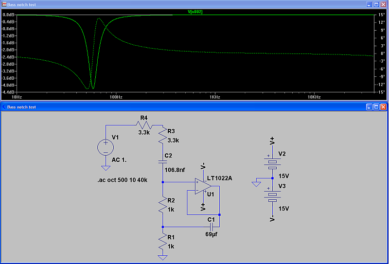

Are you going to stick with an active crossover?
If so, the Behringer DCX2496 would be the ticket. Then you can do everything before the power amp.
The DCX2496 has a built in parametric EQ as well as 3-way crossover and time delay for phase adjustment all rolled into one box.

I'll be going analogue using Rod Elliots PCBs which I have (along with some notch filter PCBs which I'll have to source). For now everything is breadboarded and using TL074s! The DCX2496 does sound like a brilliant unit for getting things right but it's quite expensive. Good value for sure, but still a fair whack.

This sounds like the wrong approach. The DCX2496 is a bit costly ($260 USD, less used), but I think it is a good idea to DIY, too. So, rolling your own active crossover is a good learning experience.
That said, the worst thing you can do is make a passive notch filter. Why undo what going active brings to the table? I would make that filter and put it after the active crossover and before the power amp.
Doing it this way makes it a lot easier to experiment, component costs are much cheaper, better phase control, and you maintain the direct connection between amp and woofer driver.
If you can borrow a parametric EQ you can experiment very quickly and dial it in, then once you have figured out what you need, build a circuit that does that.
Sorry, mentioning that large capacitor probably made it sound like I was using a passive notch filter. Is is in fact an active gyrator based notch filter, but to create a relatively high-Q notch with this at low frequencies requires a large capacitor. Perhaps a twin-T or something would be more applicable? The circuit is attached. I agree doing this passively, especially on only 1 channel, would be a poor choice!
The only passive component is a 4.5uF capacitor in the tweeter lead, a sensible precaution as it is a planar driver. In this case, I have defined it to form the 4th pole of an LR filter slope by using an 18dB BW active filter alongside. The flat impedence of the planar driver made this easy 🙂
I am still experimenting with active filter stages on the breadboard and check the electrical responses in HOLMimpulse and/or with a scope 🙂
I understand now. Looks like you are on the right track.
