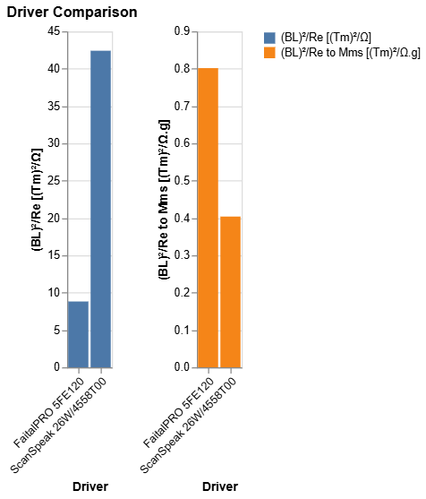

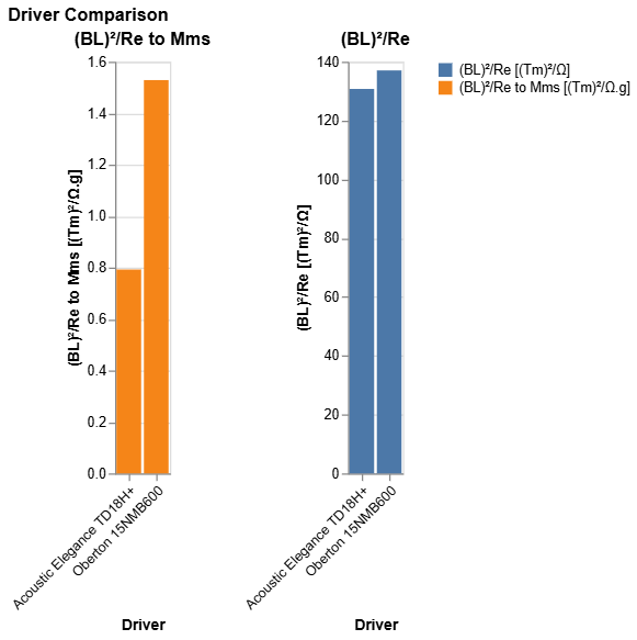

I fixed the name... sorry... Its a chart... motor strength (BL^2/Re) and motor strength per gram (MMS). If I were to say these specs are accurate, it looks like the FaitalPRO has much more motor per MMS, double what scan speak is showing... it would be easy to point the finger at this aspect as the reason why bass was less impactful on the scanspeak.... I am still pretty sure that the effect of this on the signal will be seen in Group Delay/Time to peak SPL.
Speaking of Q.... the Scan speak Qes says 0.3, the FaitalPro Qes is 0.5.... based on that, I would not of predicted this outcome but I will keep this in mind in the future.
These are the drivers I am designing with
This is what i was trying to say with my "calculations" .

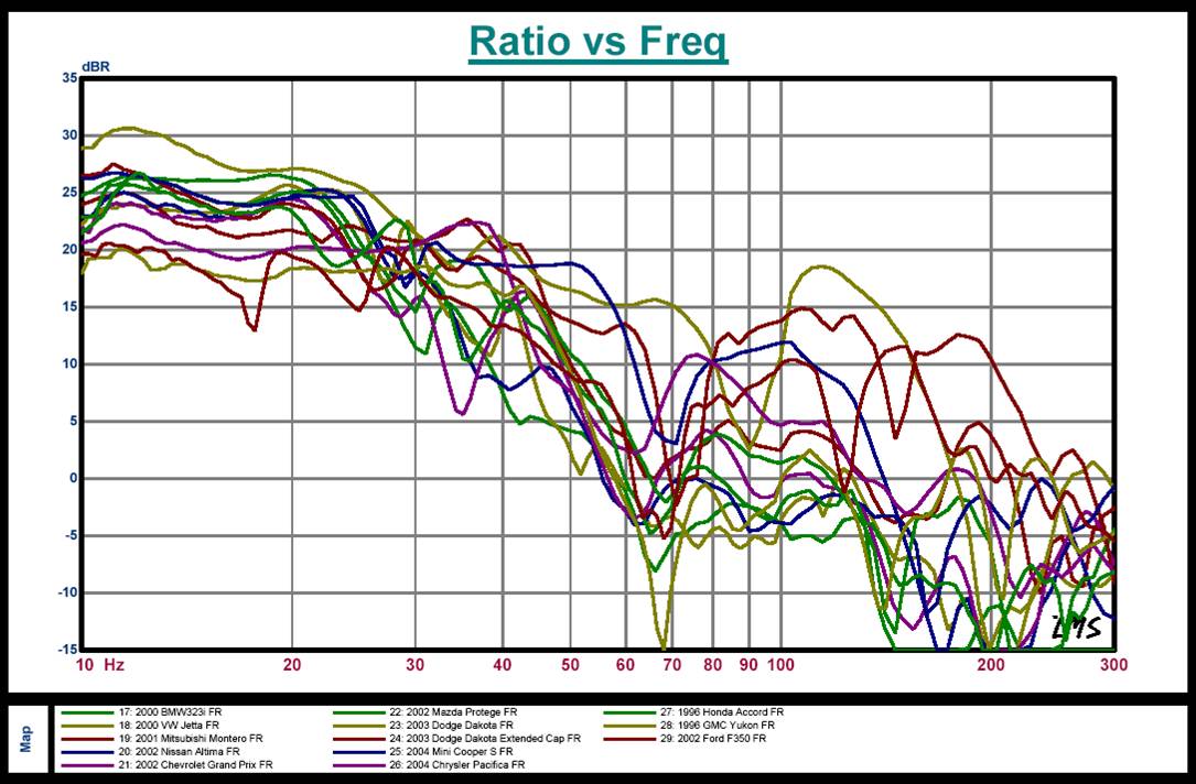

Car cabin gain increases SPL below 30Hz, generally associated with occipital lobe excitation ("eyeball wobble") and may reduce the relative mid bass "kick" in the 50-200 Hz chest resonance range.I had some powerful multiple, subwoofers in my car, it can get so loud that makes your vision blurred! Literally (At midass frequencies)
But, no, or just little midbass kick.
If you want more "kick", EQ your speakers to have a more flat response through the mid bass region.
Or use speakers with less low bass to result in a flatter cabin response.
That said, car environments can cause lingering resonance that masks any low percussive effects- you don't hear/feel much "kick" when there is a louder "drone tone".

I am the calculator... Sort of... I told AI the formulas, and then hand fed the data and eventually created a graph I liked after trial and error.Where i can find this calculator?

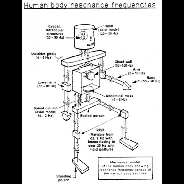

Everything has resonance frequencies including human body, so check the attached image.
Many frequencies below 20Hz the body can feel although the ears do not hear.
How does this work when none of those body parts share any dimensions relevant to those wavelegths (or if we used speed of sound in water/cells)?
In a enclosure/box, you want the sound wave generated by the driver to be reinforced (gain sound amplitude dBA) itself while you want the box to be as stiff as possible and in this case geometry is easier correlated to the wave length you are interest.
In body resonance (human or object) it's not that easy to correlate wave length to body size, material plays a lot, a bosy with the same size and different material will have difference resonance frequencies, it's much more complex. In this case the sound wave will reinforce body vibration (gain vibration amplitude m/s²).
Think in terms of Helmholtz resonance, one can tune any cavity to any frequency using the correct ratio of cavity volume to port volume, regardless of dimension.How does this work when none of those body parts share any dimensions relevant to those wavelegths (or if we used speed of sound in water/cells)?
The most easily "felt" resonance in most meat bags is usually the chest cavity/throat/mouth system, which happens to correspond to the "kick" range.
It's Helmholtz resonance changes depending on how much air is in your lungs at any given moment.
Since people have a wide range of body/chest size and muscle density, they respond differently to the same impulse.
Other parts, like eye sockets, tend to be more fixed in frequency, and take higher atmospheric overpressure/underpressure variations to notice.
I mistakenly substituted "occipital lobe", the back part of the brain that processes visual information for "orbit", (the eye socket) in post #46.
I've never experienced anything loud enough to directly "feel" vibrations in my occipital lobe.
At any rate, it takes about +20dB more pressure for my eyes to wobble than to feel it in my chest.
