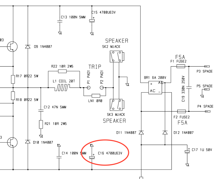

The rail I think would get to more or less 50V, transoformer gives 36Vrms for windings.

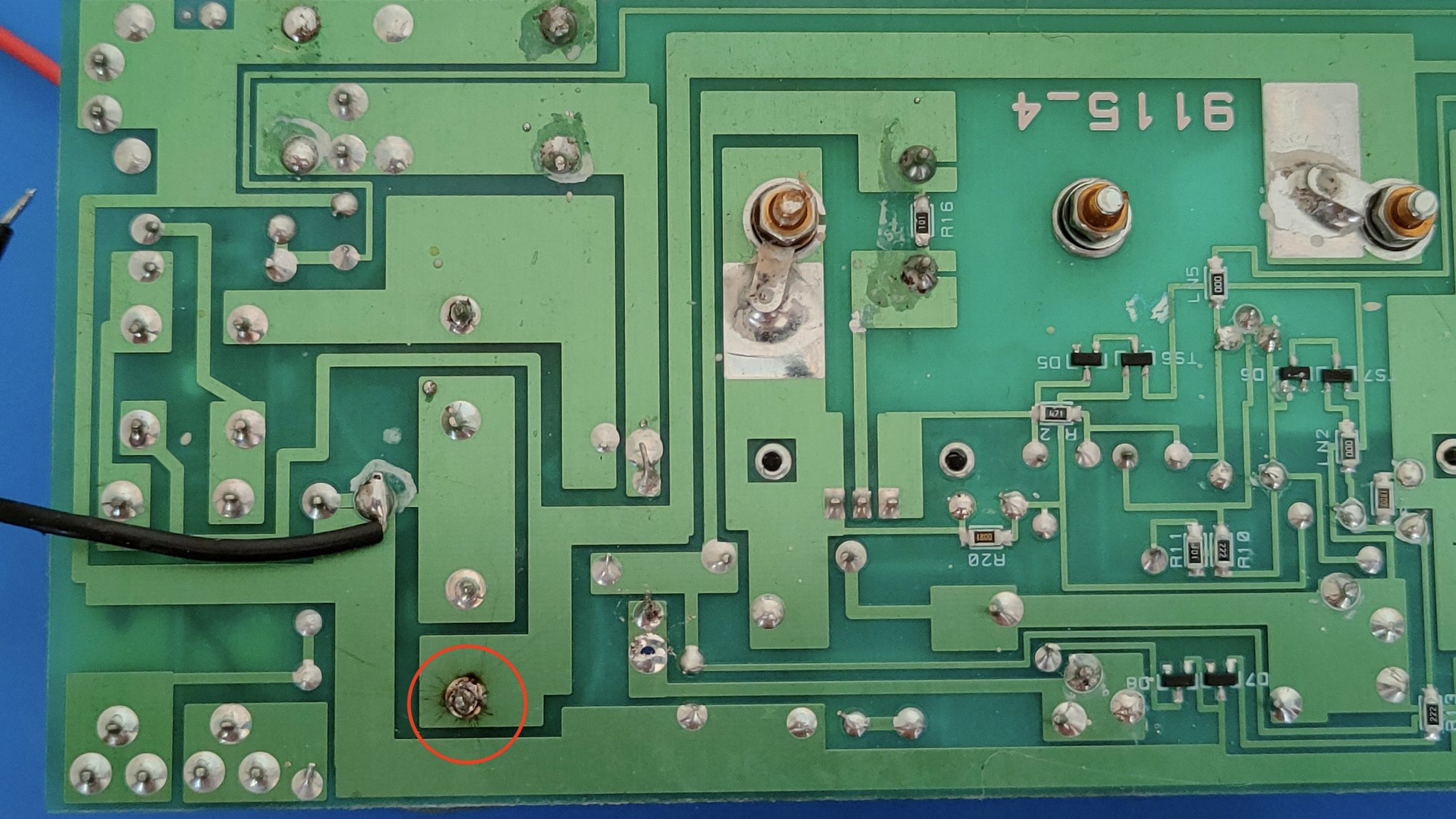

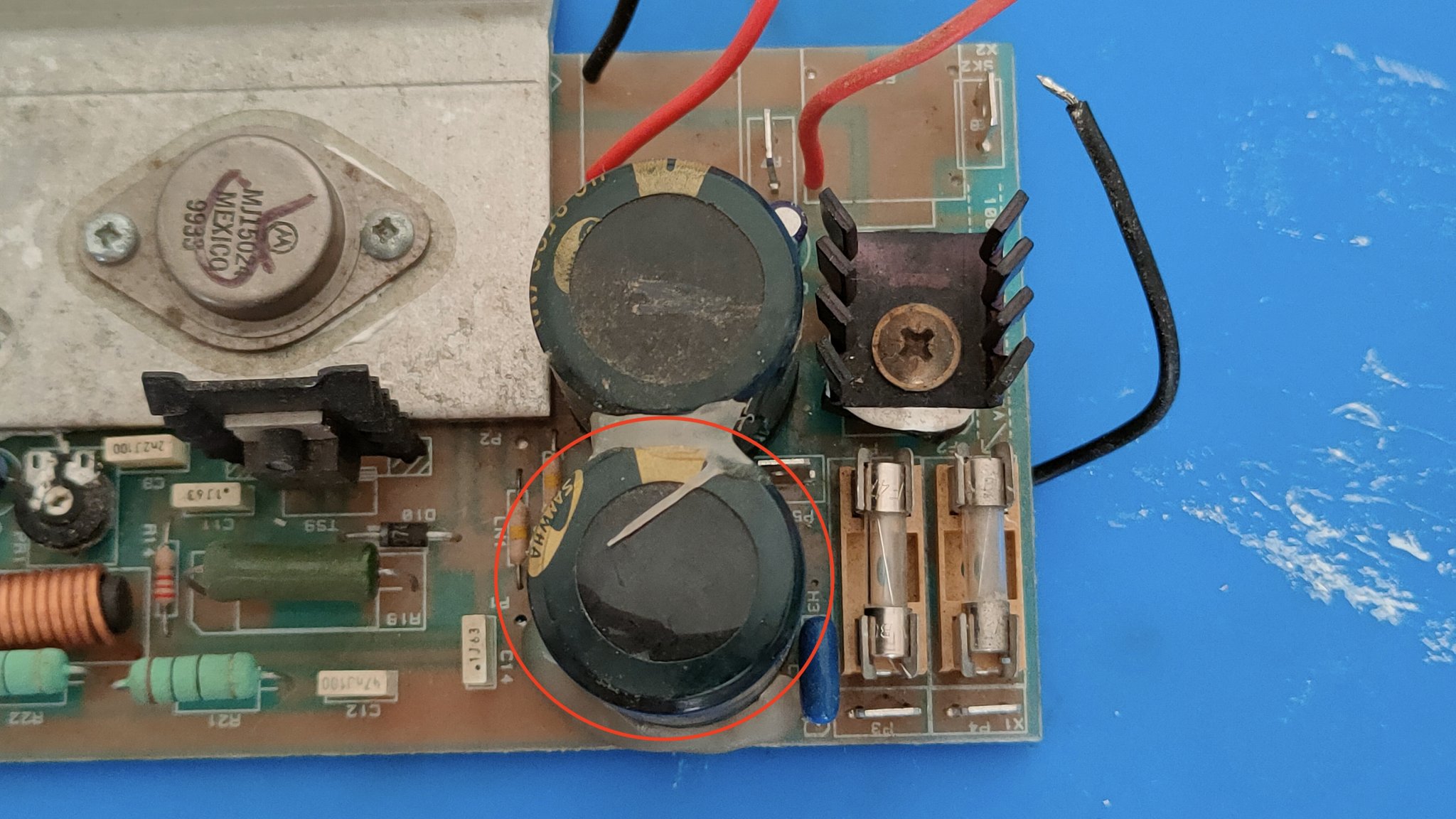

In the meantime I post some pics of the power board I've taken
This joint looks quite burned... lol (also the board has a lot of white paste, flux I guess, around joints)
Joint is for -rail reservoir cap
EDIT. Also the joint for the other reservoir looks... "cracked"?
That looks definitely ugly, cracked open, burning around comes from the electric arc (always VERY hot) caused by current jumping the gap.
Those big heavy capacitors wiggle them free by vibrations, doubly so in a Bass amp.
Although you will eventually replace those caps as suggested above, forn testing repair those joints,those caps were working 1 week ago, "aging" is sloooowwww.
So unsolder and remove both to better clean solder pads, apply fresh solder to them, melt and wipe it away to carry all the crud with a small ball pf paper, clean area with alcohol and a ball of cotton or rag or an old toothbrush, lightly scratch away any carbon you see, and resolder caps with fresh solder.
I bet it will work.
I bet it will work.

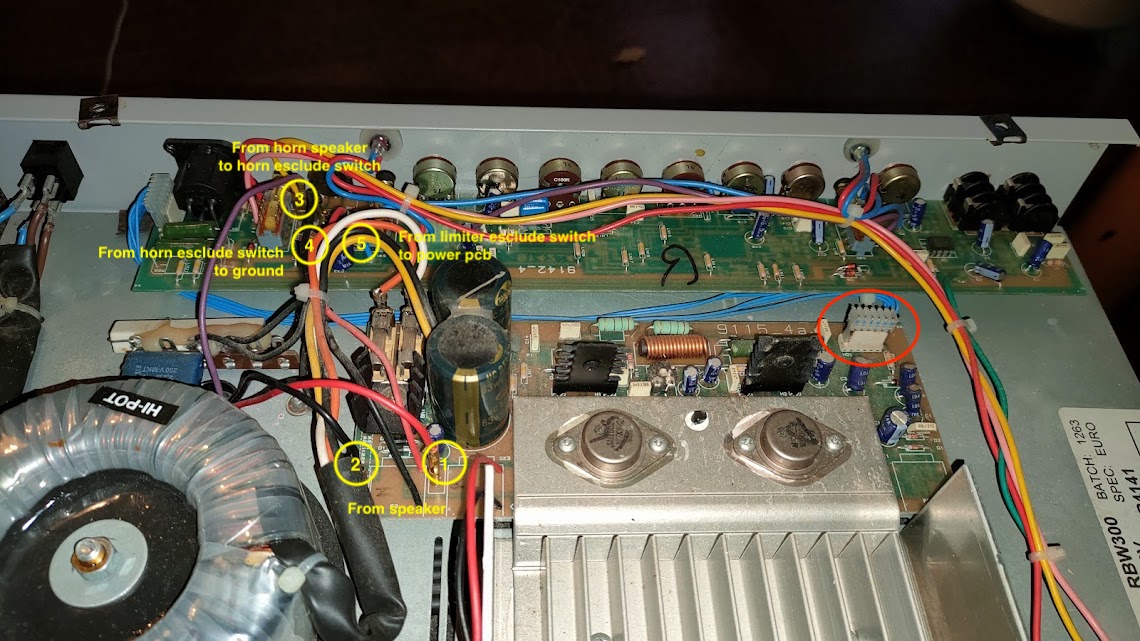

I was wondering, would it be better to exclude the preamp pcb (by disconnecting the red circled connector below) for testing or it can cause problems?
I'm also disconnecting 1, 2 , 3, 4 and 5 to exlude the speaker and horn.

Do not throw new variables into the problem, just-do-as-instructed and post results.
99% that your problem is there.
You will burn nothing since your problem is mechanical, not electrical.

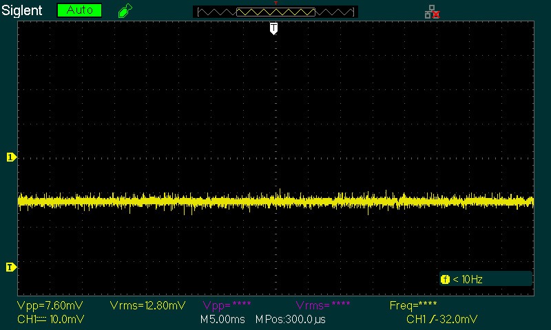

I've followed what you suggested for the capacitors joints, I've also redone some other solder joints that seemed bad.Oh, replace them if you wish.
I am trying to find now whether that´s the problem or something else, not wait 1 or 2 weeks for new capacitors to arrive.
This is the results with no speaker connected. (+/- 45V on power supply rails, with full mains voltage)
GO-OO-ODDDD!!!! 🙂
Call it "repaired" 🙂
Replace them if you wish, for peace of mind, but it´s already working, ready to rock onstage 🙂
No more hum on speakers, of course.
