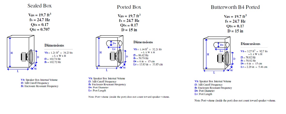

The 515B might not do well in a small enclosure. Some of these old speaker designs want a 10 cubic foot box for a maximally flat alignment. Try to find the Thiele-Small parameters or measure them, then do a simulation. You want to find an alignment with a controlled mid-bass peak (1 or 2dB) and gentle roll off to perhaps -10dB at 40Hz. Resist the temptation to tune the box higher than 40Hz to keep the cone from farting out.
Thanks Guys. Loudthud, I did find the thiele-small parameters for the Altec 515B. Attached is the suggestion of the online bass box software that I used. I'm not locked in to the 515B, I just have one. I also have two of the Morel MDM55's. I'm not a bassist but have always wanted to build a bass guitar amp. Sreten, thanks for the ideas. I love that bass horn. I was trying to use up stuff that I have but it is pretty cool.
