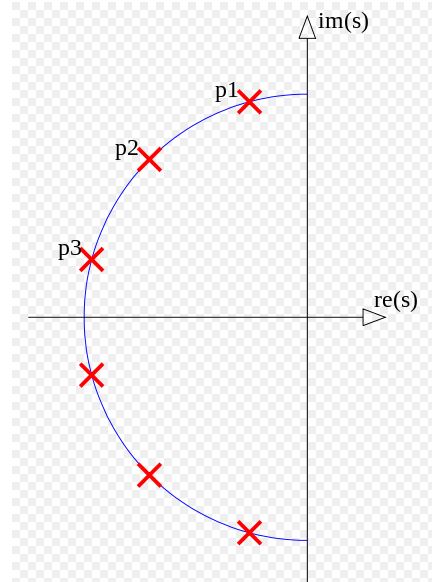

Those of us who understand filters know that a 6th Order Butterworth highpass looks like the below diagram except that there is a sixth order zero at the origin.

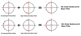

The reflex physical speaker poles correspond to p2 and p3 and the reflected poles below. The electrical filter corresponds to p1 and the reflected pole below.
The electrical p1 filter, by it's very closeness to the imaginary axis is a High Q filter. Probably around Q=2. I can't explain it more simply. This is deeply mathematical. Because the poles are on the l.h.s. of the axis, being a real world application, group delay is positive. The bass lags the main signal. 😎
... I'm not sure it's really worth the effort. If you think that closed box is second order, reflex generally 4th order at whatever steepness you fancy, then even steeper 6th order is pretty small beer in the overall scheme of things...

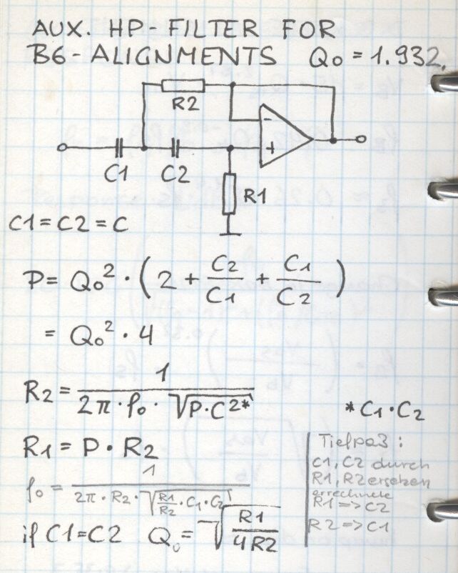

For the alignment I described in http://www.diyaudio.com/forums/mult...ment-filter-b-w-matrix-805-a.html#post3480595
you use a second order high pass filter with Q of about 2 which gives you 20*log(Q) (+6dB) boost at the filters resonant frequency.
Have a look at Fig.2 here B&W Matrix 805 loudspeaker Measurements | Stereophile.com
The fourth order response of the (ported) loudspeaker system combined with the second order filter
gives you a sixt order response with lower f3.
I have attached an old (from the 80ties ;-) ) note of mine how to calculate such a filter.
For the B&W Matrix 805 you need a filter frequency f=36Hz with a Q=2.
Example for f=36Hz and Q=2:
C1=C2=100nF
R1=176.838826 kOhm
R2=11.052427 kOhm
To arrive at the calculated values you can paralell standard (used here E48) values :
for R1 316 kOhm paralell to 402 kOhm = 176.924791 kOhm
for R2 16.2 kOhm paralell to 34.8 kOhm = 11.054118 kOhm

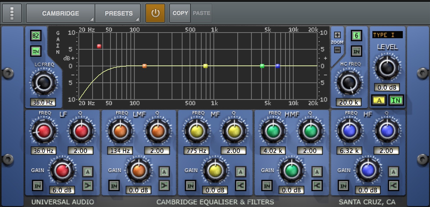

Sorry to revive this thread. I have a very lay-person question;
Would a butterworth 2nd order filter, such as the one below "B2" on UAD's Cambridge EQ, theoretically give me the same results as the BAF filter?
I do not need to boost the resonant frequency?
Thank you!

Short answer is no. You do need boost. YMMV but 6th order
Butterworth is a recipe for bass boom, room and speaker
placement dependant. The above is just a sub filter.
rgds, sreten.

So I found this page:
B&W Bass Alignment Filter
On which I found this chart:
This should take like 30 seconds to do with miniDSP or just about any similar thing. It looks like a 4th order high pass filter with an extra bump at 36 Hz (per discussion) or maybe a 3rd with very high Q. 😀 😀 QED.

Thank you eriksquires!!! I went with the miniDSP-2x4-HD and that's NAILED IT. I dialed in the chart you showed and the improvement was surprising. It was better than expected. I have enough bass, but no "booming" to it. I can now distinguish the different bass notes and "color". I really appreciate your time, attention and expertise. With your help I'm a happy listener (at least for now...you know how this goes).
