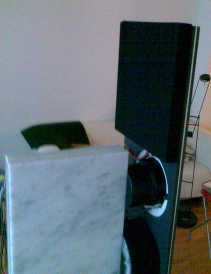

Great idea and I am sure it works a treat. I am currently building an open baffle system where the 4x 12in woofers are mounted in a similar way. IN my case I built 2 concrete block columns then mounted the drivers in a MDF cradle, which then attaches to the column but is slightly de-coupled by felt pads. The actual baffle does not touch either the column or the cradle. The drivers shown in the pics I attached earlier in this tread sit on top of the columns.
The only thing we need to be careful of with magnet mounting is to make sure the rear vent on some woofers is not covered, this is rare however and most unusual on mids. In your case the cold mass of the marble would help wick away some heat from the drivers, which is hardly an issue in your application but could help with bass drivers that are being pushed to their thermal limits.
I will try to grab a pic tomorrow and post it.
Elbert that bitumen stuff is very good, some neoprene or rubber non-slip matting added over the top of it might work even better still as it will stop reflections as well as damping the resonances from the basket.
