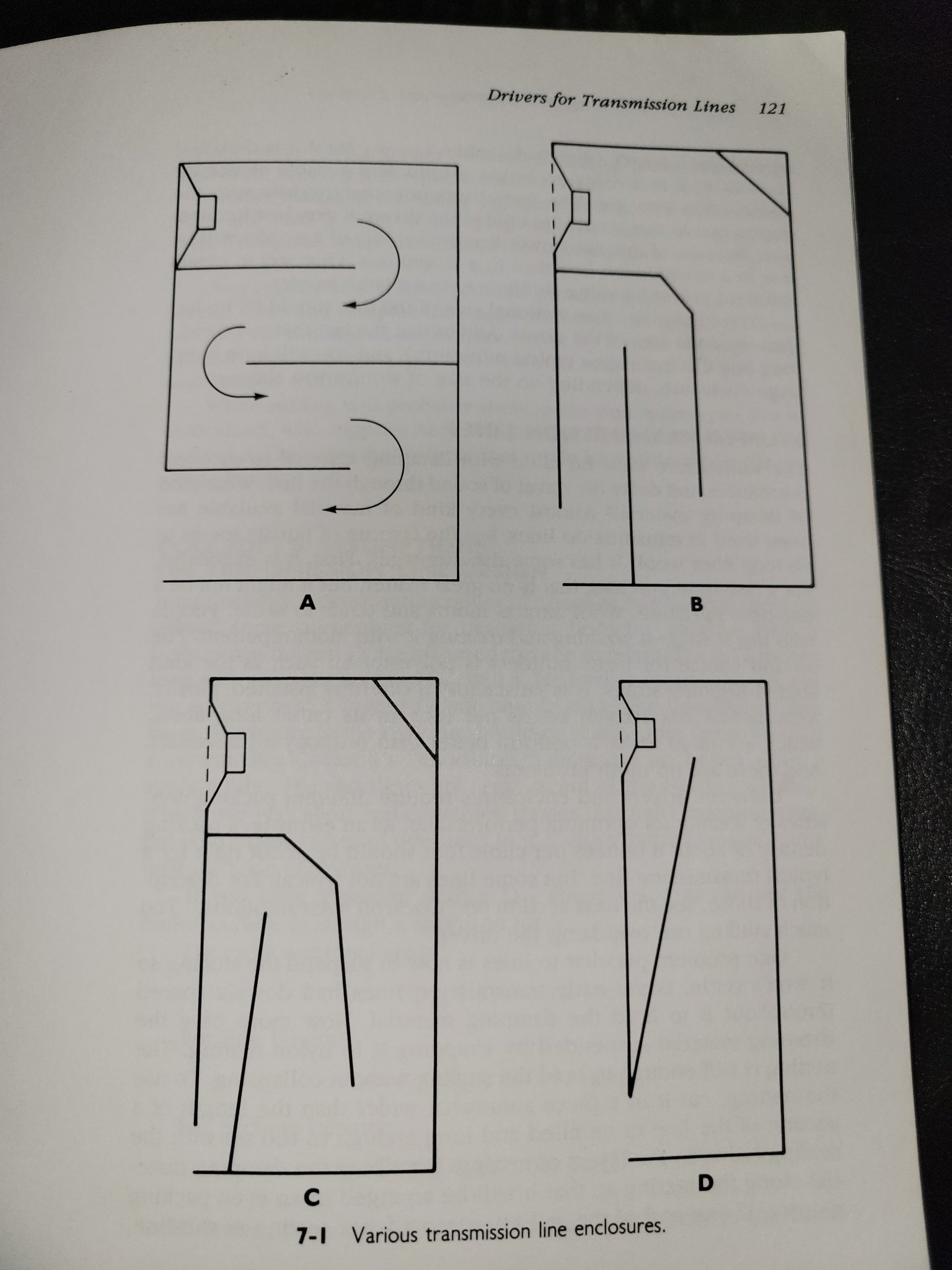

Tapped Horns are BP6S or 6th order series tuned bandpass enclosures where the whole enclosure is the horn, vent, or port.
Positive flare TH = high efficiency, big enclosure, plays low.
Negative flare TH = low efficiency, small enclosure, plays low.
Straight flare TH = is in between the 2 types above. No angles, so ease of build.
There's your example of Hofmann's Iron Law...efficient, small, low...pick 2.
Transmission Lines (TL) follow the same laws as TH's.
TL = the driver is mounted on the outside of the enclosure and has bass reflex (BR) properties.
TH = the driver is mounted inside the TL enclosure and has BP6S properties.

Like a said before, model a positive flare TL and a negative flare TL of the same volume and you'll see a prime example of Hofmann's Iron Law.
A TL is a BR enclosure where the whole enclosure is the port.
