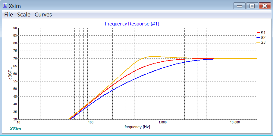

I've shown here the effect of using a crossover with different loads. The middle is the 8 ohms it was designed for, the others are 4 and 16.
This is a second order crossover and this is what many pre-made crossovers are. Unlike first order pre-made crossovers, 2nd keep the same slope/frequency when you use a different load impedance, which is why they're more often used. Their difference is around the 'knee' near the crossover frequency.
