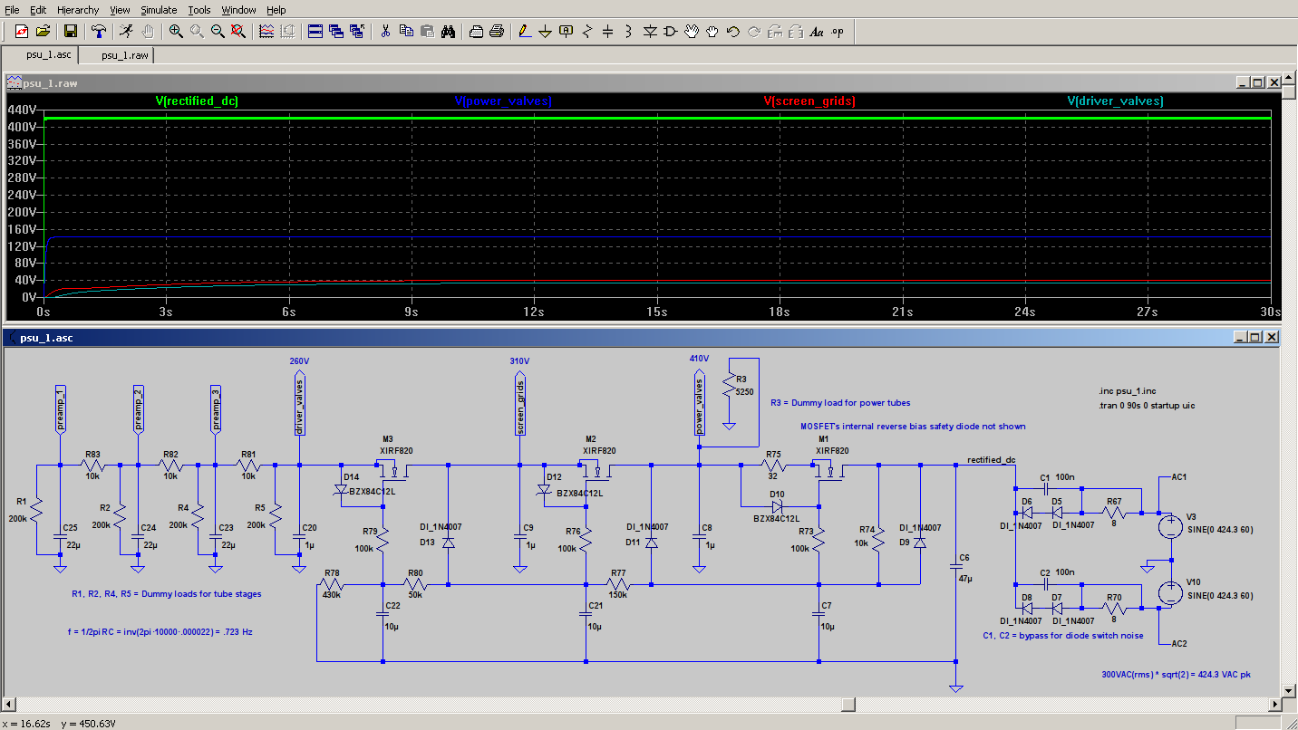

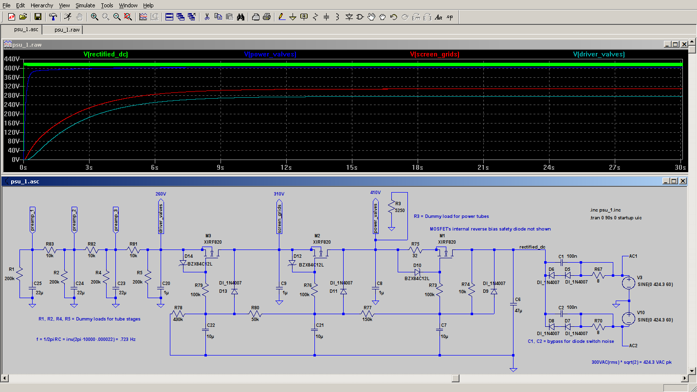

I figured it out! This one hurt my brain.
Tony,
Attached are 2 screenshots of an LTSpice simulation of the power supply, which includes some dummy loads for the valve stages.
In the first screenshot, I have diodes D11 and D13 placed wrong. D11 and D9 share a common node, which caused a large voltage to be dropped, and D13 was also misplaced.
In the second, screenshot D9, D11, and D13 are properly isolated from each other with biasing resistors.
My first step to solving this was to remove D9, D11, and D13 from the circuit, at which point it behaved correctly. Later, I saw the misplacement of the diodes and resistors. I think D9, D11, and D13 actually are not necessary, since the IRF820 already has internal reverse bias protection diodes. Correct?
I will have to think to get clear in my mind exactly why these errors caused the circuit to behave the way it did. Once I saw it, though, I knew it was a (now) obvious mistake.

Tony,
Please, let me know what you think.
Thanks,
Dave

My psu design is based on Merlin Blencowe's book, "Designing Power Supplies for Tube Amplifiers". He does a great job of explaining this circuit and the function of the various components. The 10uF caps tied to the MOSFET gates have their effective capacitance multiplied by the gain of the MOSFET. This allows for smaller caps and an extremely quiet HT supply.
Kevin O'Connor's book, "The Ultimate Tone", also describes a similar psu topology. Both are great books, but, like I said before, I think Blencowe is a better teacher. After reading Blencowe's book, I now feel I can get something from O'Connor's explanation.
Based on aardvarkash10's advice, I am using passive RC decoupling past the driver tubes' HT supply. In "TUT", by O'Connor, he says you drop about 1V for every 1k of resistance in an RC decoupling network. An LTSpice simulation shows this to be a pretty accurate estimate.
Thanks,
Dave
I will look into increasing the reservoir cap, as you suggest. I need to make sure that I do not have too long of an inrush current - I don't want to fry the rectifier caps. I am now noticing that there is a marked difference in the size of reservoir caps between guitar amps and hi-fi amps. The hi-fi amps choose much larger caps.
Thanks,
Dave
Be mindful that you need a tube in place to pull down the voltage in each RC decoupled stage - so best to use cap voltage ratings that can cope with no tubes present (or place the nominal discharge resistor at the end of the preamp RC daisy chain, or augment with some HV zeners).
Edit: dang - missed the posts on the second page! Anyway, still valid for those of us that just use RC decoupling from output to input, and suffer lots of drop from one end to the other.
trobbins,
I am using RC filter networks for the last valve stages, so what you are saying applies. I am interested in your advice on using a zener.
So, with the zener, you would jack up the negative terminal of the filter cap? For example, if you had a 260V HT, you could put a 160V zener under the cap, and now use a cap rated at around 100V?
No that wasn't my intent with zener. The intent was that if you had say a 300V electrolytic with a nominal 260V HT (all tubes in) at the end of a few stages of RC droppers/decouplers, but if the tubes were pulled out then the 260V would rise above 300V, then put a 300V zener across the 300V electrolytic. The upstream R's in the RC decouplers would (depending on design) limit the cap voltage and not cook the zener. I just had a few 150V 5W zeners lying around so have used them for that application in a few restorations. However it may be an expensive option if you have to go buy them.
Ciao, Tim
Ciao, Tim
