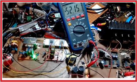

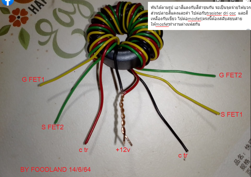

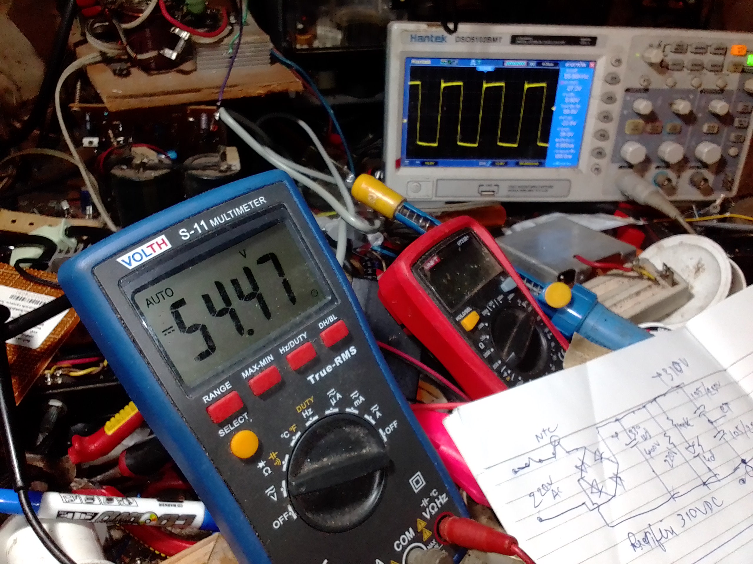

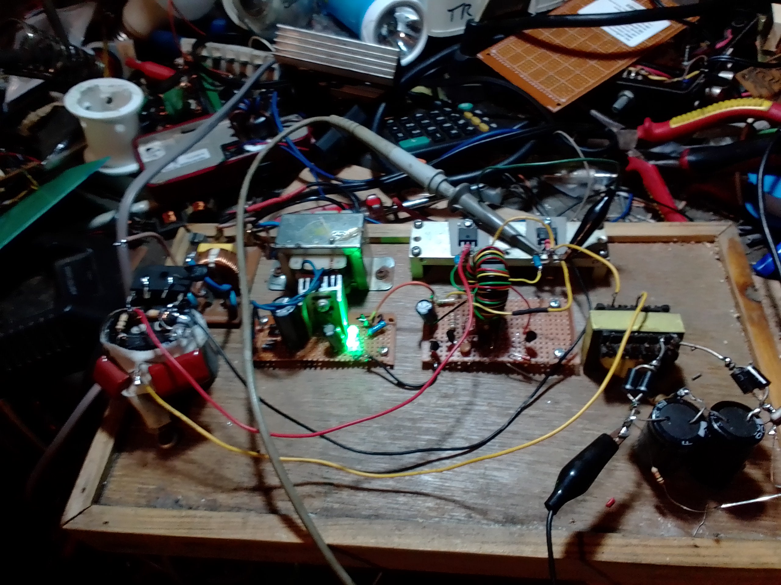

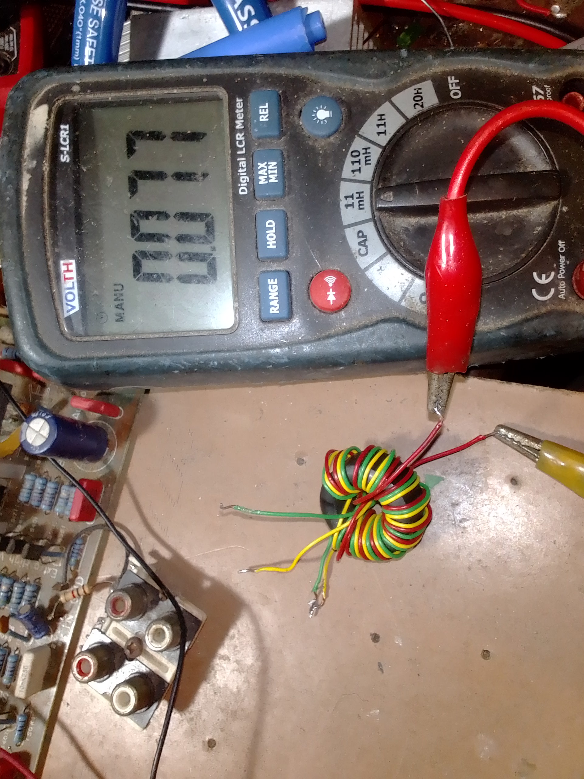

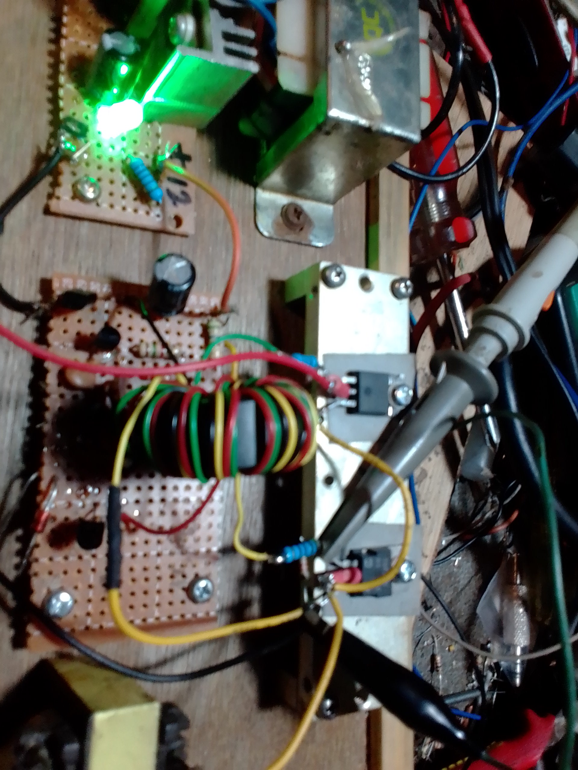

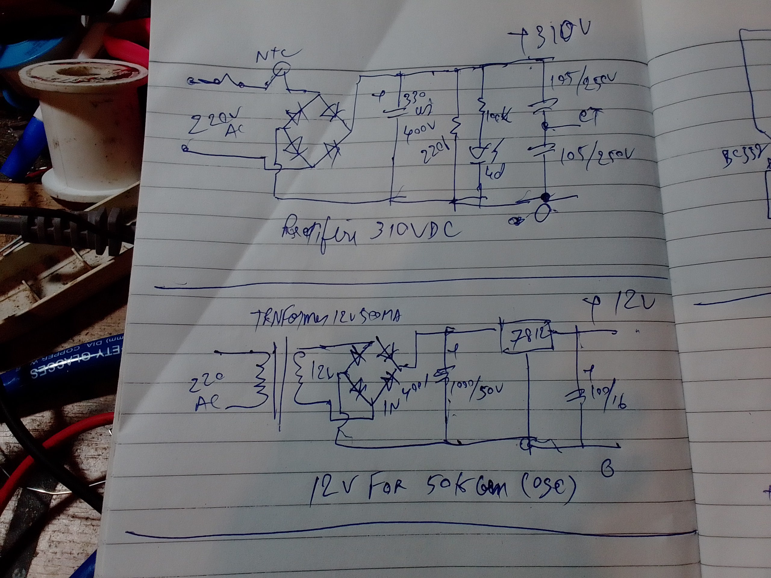

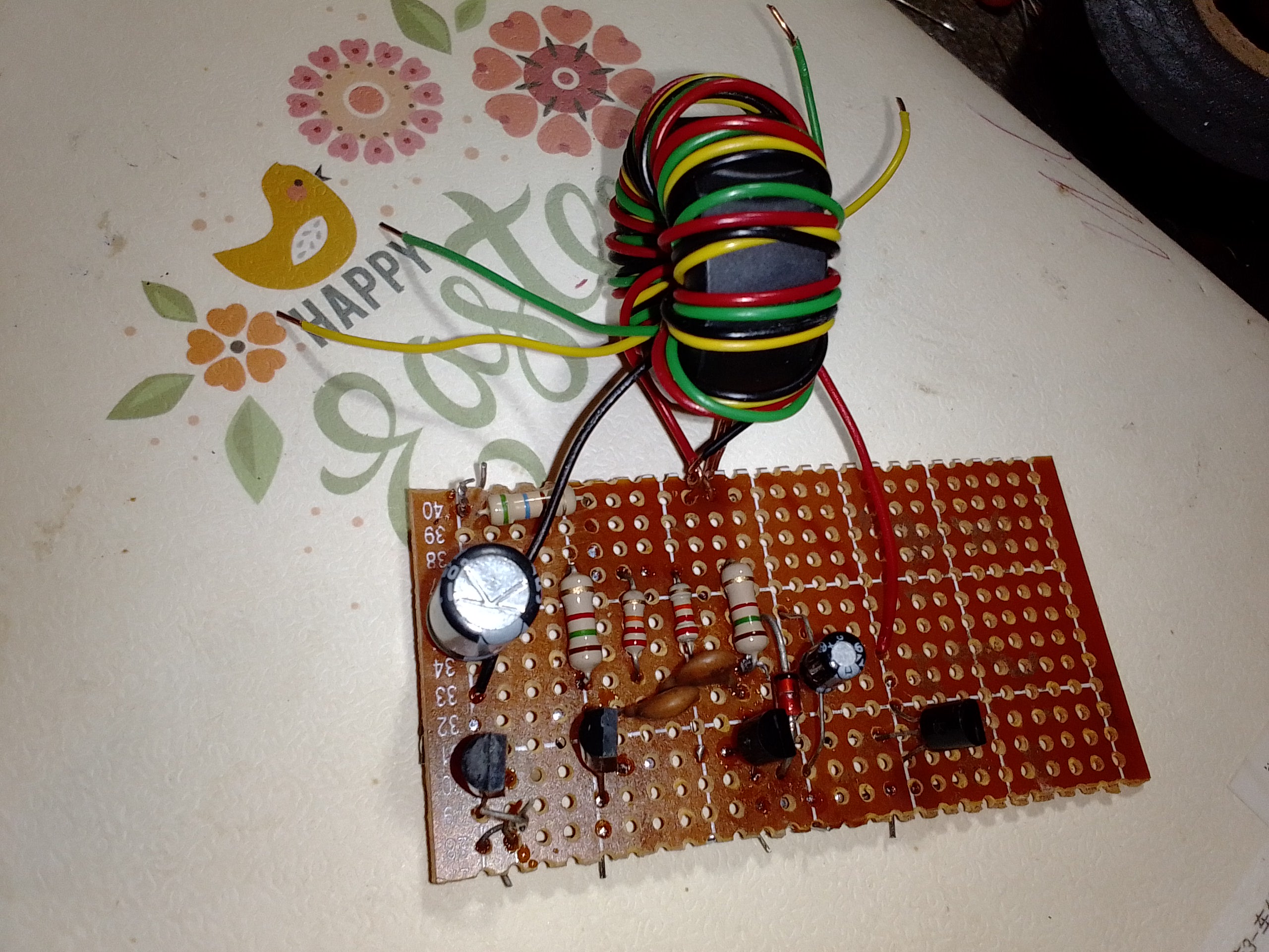

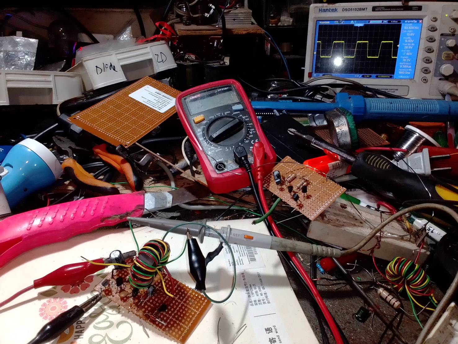

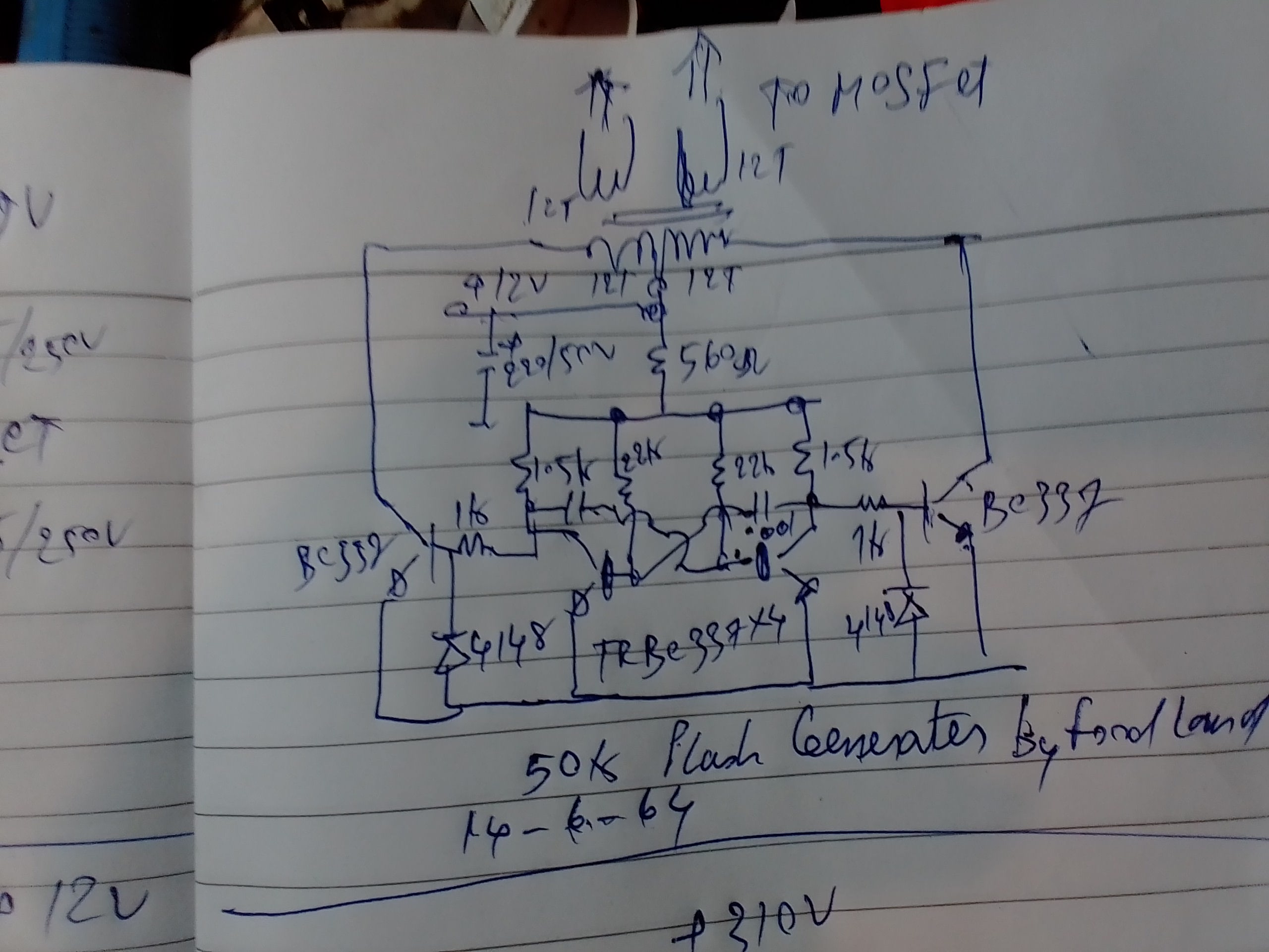

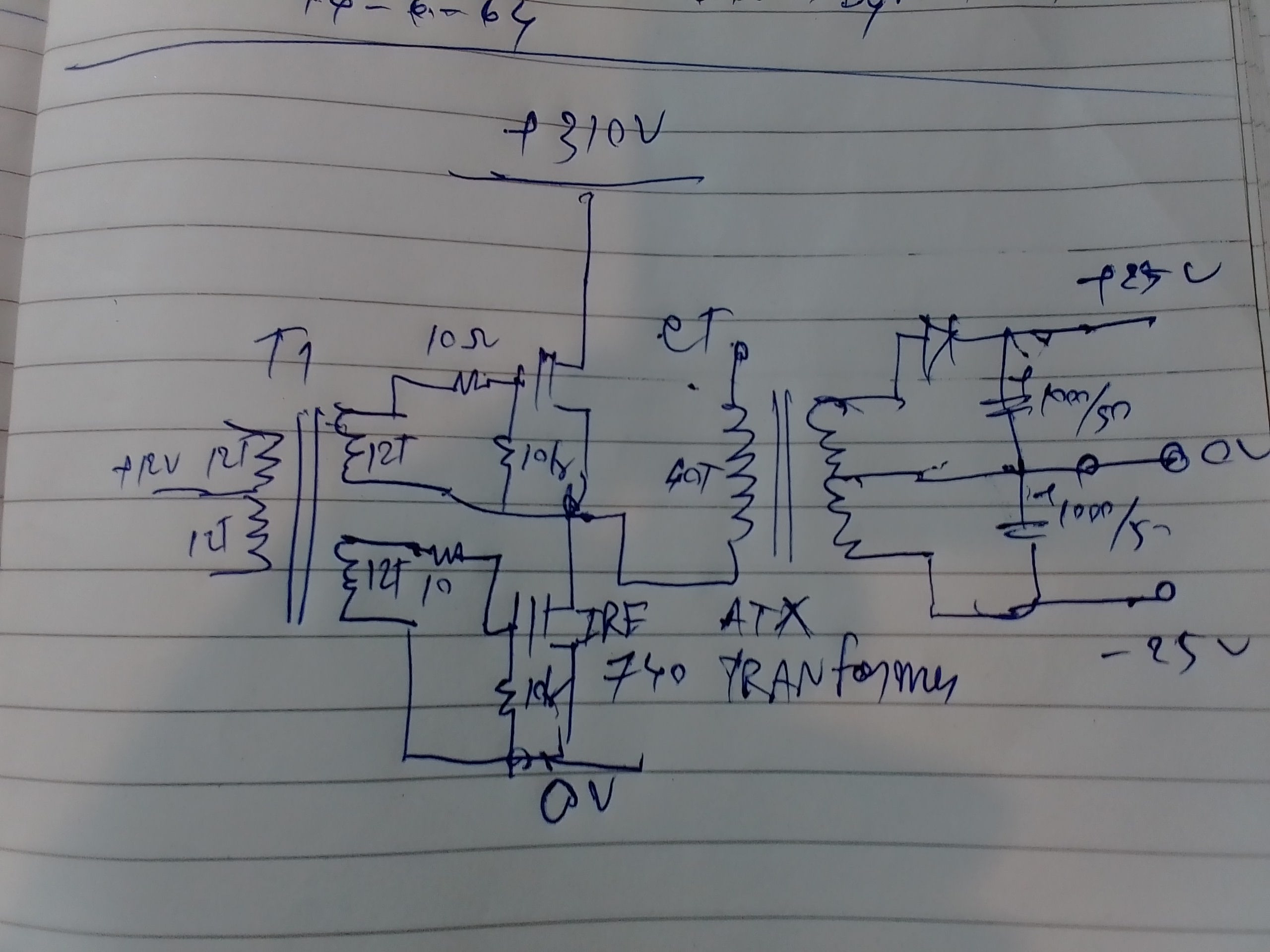

basic smps It's a simple circuit suitable for beginners

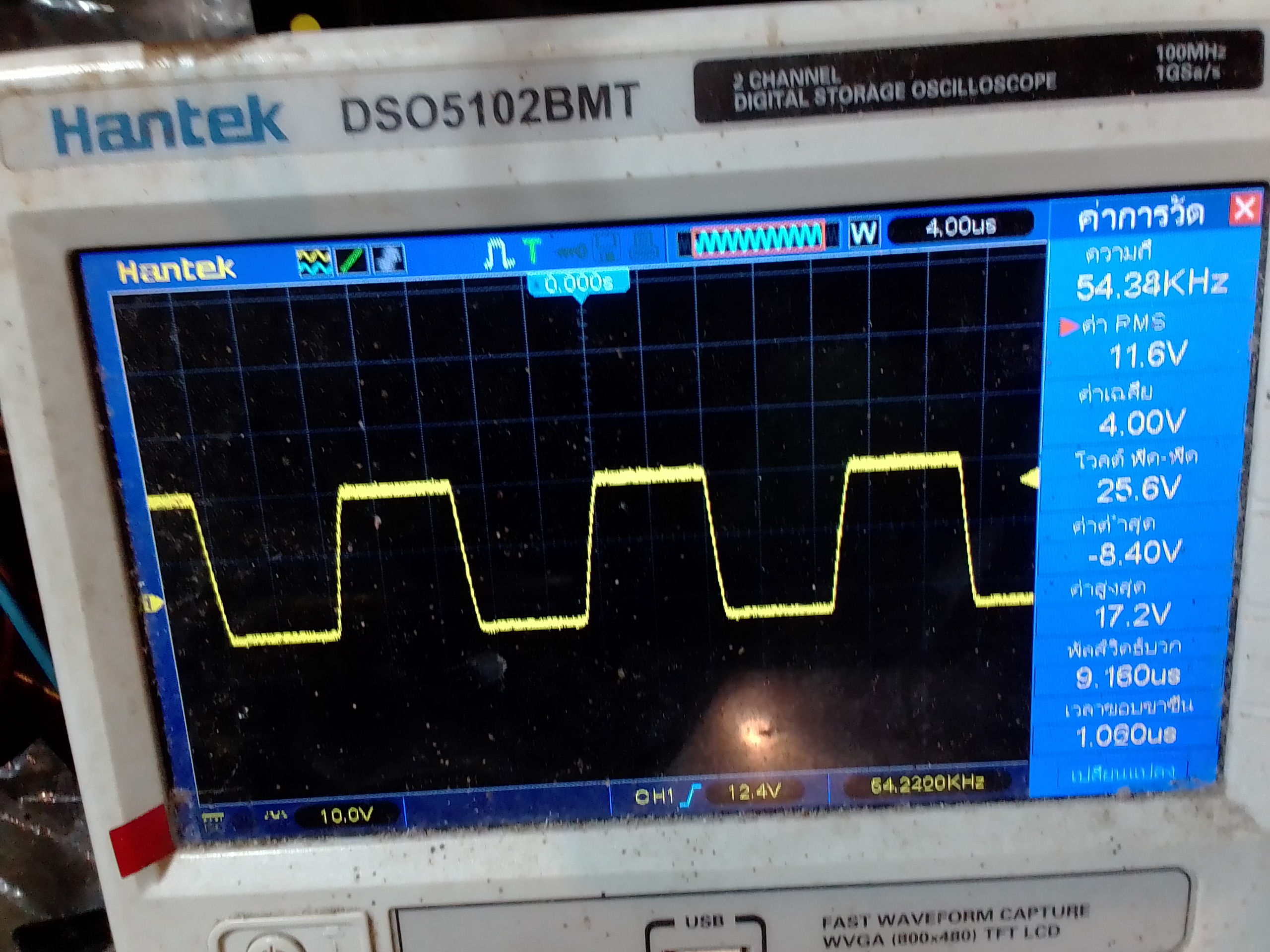

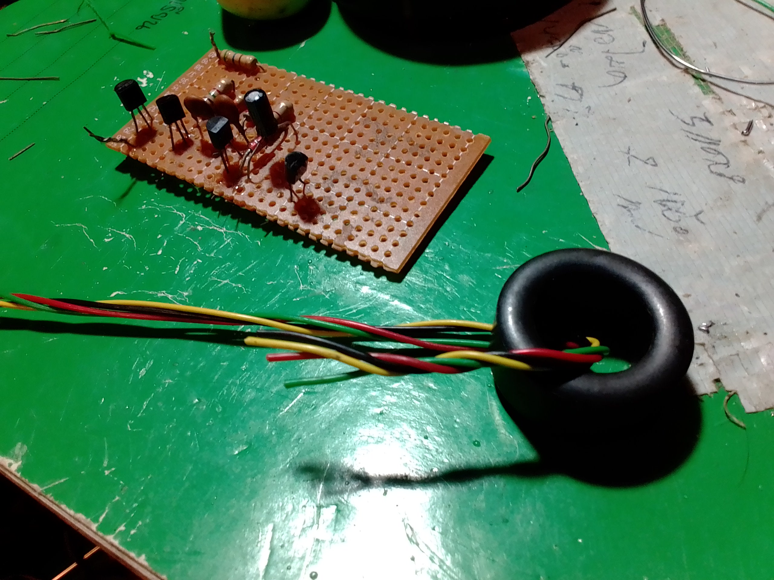

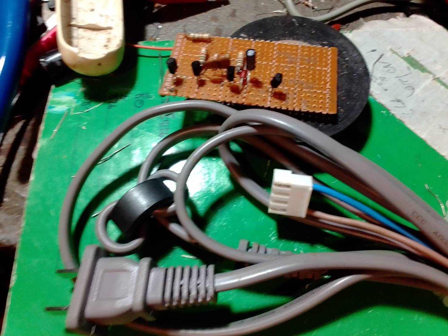

The circuit consists of 1. 12v regurator for osc 55k circuit 2. b+310vdc
3. mutivibrator 55khz and gate dri trnsformer circuit
4. half bridge dri circuit

mosfet irf740 the tranformer for test from atx tranformer

There doesn’t look To be any over volt or under volt protection, also no isolated feedback or primary side sensing?
Is there any protection at all?😛
btw, this violates forum rule no 3:
Intentionally posting incorrect or flagrantly dangerous information (Note 2).
วงจรใช้งานได้จริงครับ The circuit actually works.
