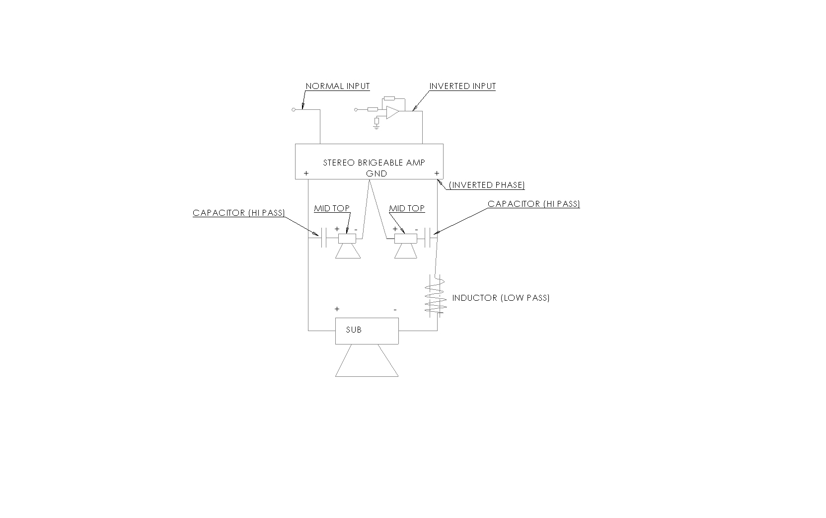

Yes agreed that a passive system won't work very well but there are ways to get a system functioning with 3 speakers.
In car audio amplifiers, often one channel has the signal inverted and the outputs labelled according to the phase. This allows for easy bridging of the amplifier outputs. The speaker connection is just moved from one connection to the other one to bridge the amplifier.
So it stands to reason that if the stereo amp has one input signal inverted by use of a opamp (or transformer!) then the amplifier can be bridged in the same manner.
It is then possble to run a pair of stereo speakers in normal mode but with one speaker connected in reverse to re-correct the phase, and a single speaker in bridged mode.
There are issues with the overal impedance loads that the amp must tolerate, and the sub especially must be not to low an impedance, but it does work (crudely)😱

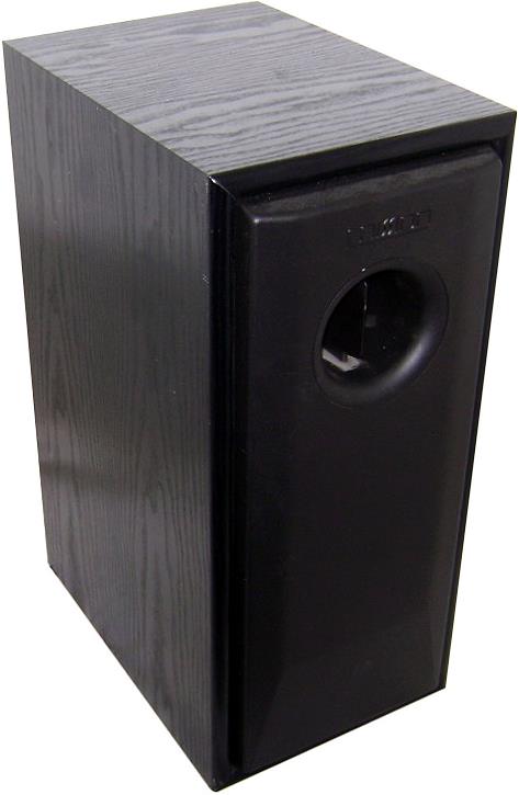

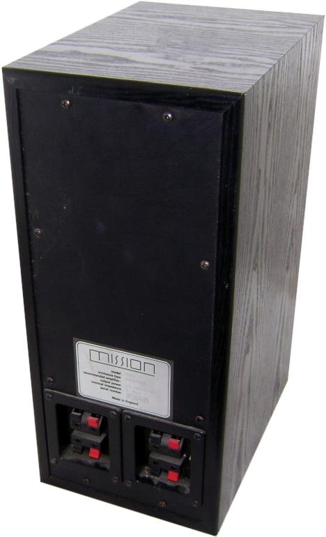

I agree and disagree, doesn't mean it can't be done... 😀
Mission 73pi - passive sub | AVForums.com - UK Online
Yeah, that's one of the applications I had to design passive crossovers for, which can't really work properly. Of course, you will hear sound, but that does not mean it is accurate. In that kind of configuration, you might accidentally load the amplifier down really hard at certain frequencies.
