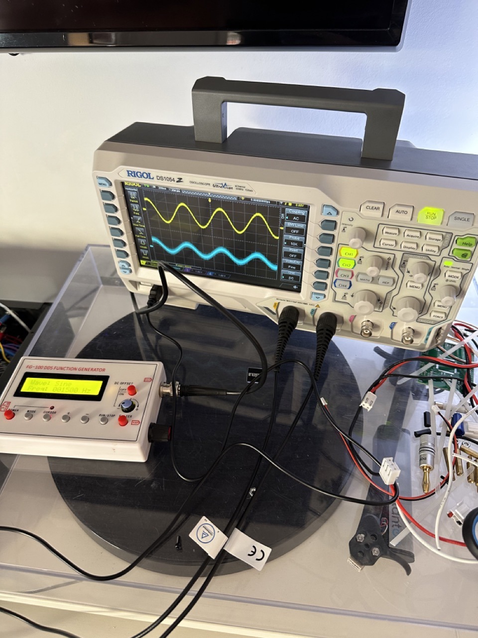

I wanted to run some basic tests on an amplifier I'm building. I have an oscilliscope, and a cheap function generator from Aliexpress.
I hooked it up the way I thought it should be, but I find the signal is pretty noisy.. This is purely from testing as with normal music it sounds perfect, but when hooked up the signal has a hiss in the background and on the scope looks a bit noisy.
1) I connected CH1 oscilloscope probe ground to one RCA ground lug
2) I connected the function generator, via a BNC cable, to the ground lug of the same RCA jack, then ran the function generator signal to the RCA positive lug (which is connected to input connector of the the amplifier channel under test)
3) I connected the second oscilloscope probe to the speaker outputs for the same amplifier.
It works, but signal seems noisy. Anything I should do different?

no isolation transformer? i could be wrong but i think there's a ground loop introducing noise.
and not knowing what your amp design is i would be careful where your attaching those probe grounds if the scope is grounded (especially with regard to that speaker output)
The noise you see on your screen is presumabely rf-noise, i.e. noise above the audio band mostly irrelevant to audio. I use the same scope as you and can confirm that this piece of digigital equipment emits piles of rf - noise into its environment.

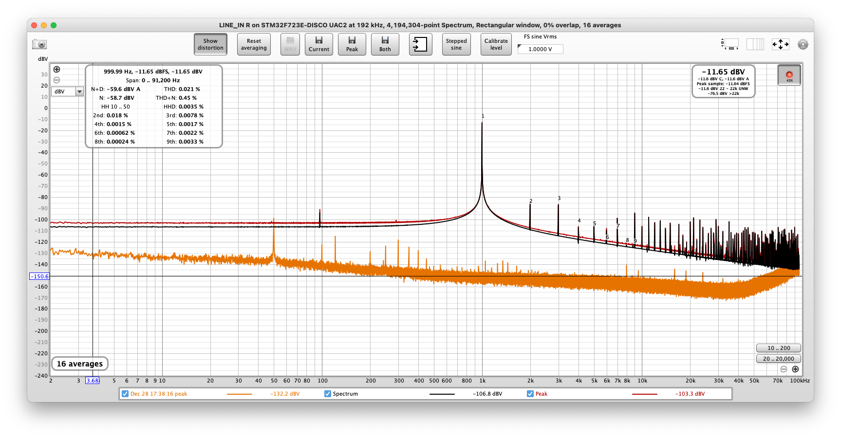

So on the signal generator - all create noise. Here's my SDG1032X at 1KHz using my DIY audio spectrum analyser I'm building:
You can see the black line being higher than the orange noise floor. Additionally there's more noise in there than just the 1KHz tone (part cables and grounding perhaps). The lift of the noise floor (black vs orange) and the width of the base of the signal are results from a wide range of things. You can even see noise appearing from the synthesis from the SDG towards the right on the black trace.
My point here is that a DDS synthesis but will have additional noise from all the other components, master clock noise, then you have the environmental noise and finally the scope noise.. If you want to measure THD etc then you will need both a clean tone generator and a higher dynamic range that a scope can show (hence my audio analyser).
The fuzz on the lower sine wave is noise on the signal. It looks higher frequency. If you turn the DDS output to zero but leave it connected do you have the same noise? If you remove the probe but short the probe to ground do you get the same amount of noise?
An FFT on the scope will give you a small dynamic range but wide frequency range picture of the signal and noise.
Ideally you want to work out a perfectly noiseless testing strategy.. however that usually doesn't happen without more work:
The DDS is possibly not the best from a noise perspective and that's probably what you're seeing but it's worth checking out that everything is grounded well etc and away from mains cables.
