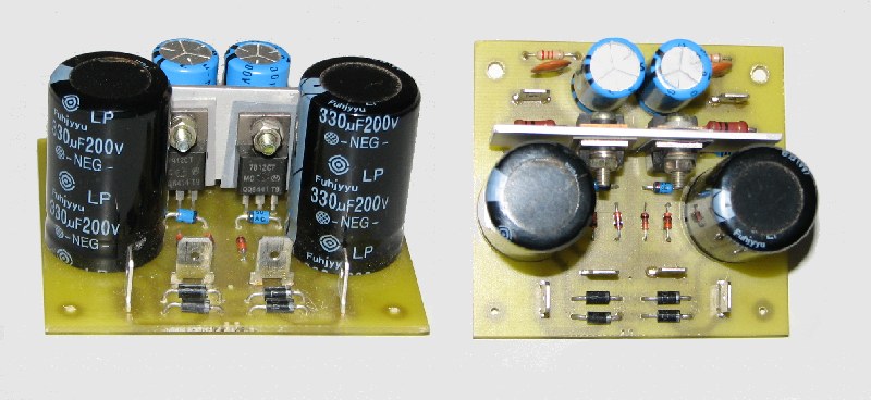

This power supply should work very well as a front end supply. Just tie the grounds centrally and run +/- feeds.
Attached is a photo of one I built to give you an idea of the regulators, transistor & heatsink configuration.

jackinnj said:
just to be safe, you should put a 1N4007 anode connected to the top of R3, cathode to the input node (junction of D3,D4)
and vice-versa for the negative supply.
Yes Jackinnj is quite right regarding the diodes. If the input supply goes short cct for whatever reason, any residual voltage on the output will cause large currents to flow through the now reverse biased regulators and through the shorted input. Though this would be a fault event anyway, there's no point in destroying the regulators.
I have updated the schematic and layouts to include the diodes.
Thanks Jackinnj.

The 1N4007 was added only to save the regulators (7812 & 7912) if a particular fault occured. They do not affect the normal operation of the cct and would make any difference with your amplifier.
The 13007 is intended as a switching transisor and this is how it is used in the high voltage regulator. It has very low gain so it is not suitable as a driver transistor. It can be used as an output transistor for a general purpose amplifier, but there are better transistors around.
In the regulator circuit you posted, different voltages can be achieved by changing the zener. This sets the voltage for the regulator less around a volt for th transistors.
The circuit you posted is a discreet transistor regulator and variations of this can be found in many applications. It is of a reasonable quality but IC regulators are better.
The circuit I posted uses IC regulators and these achieve very good ripple rejection and low noise. To some degree they are similar to your circuit but in one TO220 package.
Cheers

The suggestion for up to 1,000uF of input capacitance has more to do with the smoothing of AC applied directly to the board. For a current of a few hundred milliamps this is sufficient. You could go for more but not a lot of benefit would be achieved and extra strain would be placed on the rectifier diodes.
The major devices in the circuit are the 7812 & 7912. The MJE13007's are only turned on momentarily when the circuit is first turned on, while the output capacitors (and capacitors in attached circuits) are charged. Once this is done only the regulators are actiive.
To put it another way MJE13007s simply protect the regulators when the circuit is first turned on. Under this condition the brief voltage across the regulator would have been more than it can handle.
The circuit at first glance could look like it uses the transistors as a booster stage carrying the bulk of the current but this arrangement is different.
Finally the circuit will work with any 3 pin regulator any 78xx & 79xx. The ouput voltage will be the sum of the zener(s) plus the regulator voltage.
